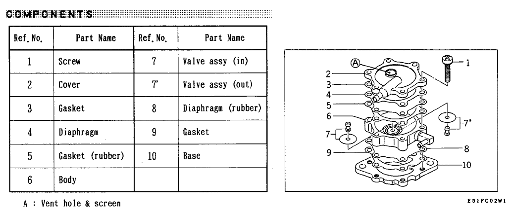

What tomplum said plus, you need to check the pulse line from the engine to the pump. If the pulse line is original, replace it. Use standard fuel line for it.
More than likely, the pump needs to be refurbished or replaced.
Here is a cut and paste from the engine manual:
Item 7 are the check valves that keep the prime on the pump and also are part of the pumping action.
Richard
Richard
So many options to make this work I might price a pump rebuild kit. Good point on the valve that's probably not holding a prime.
