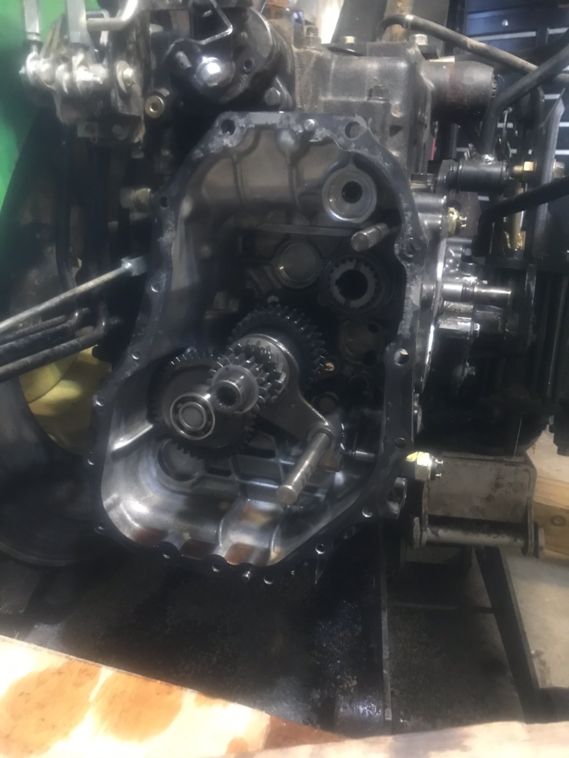

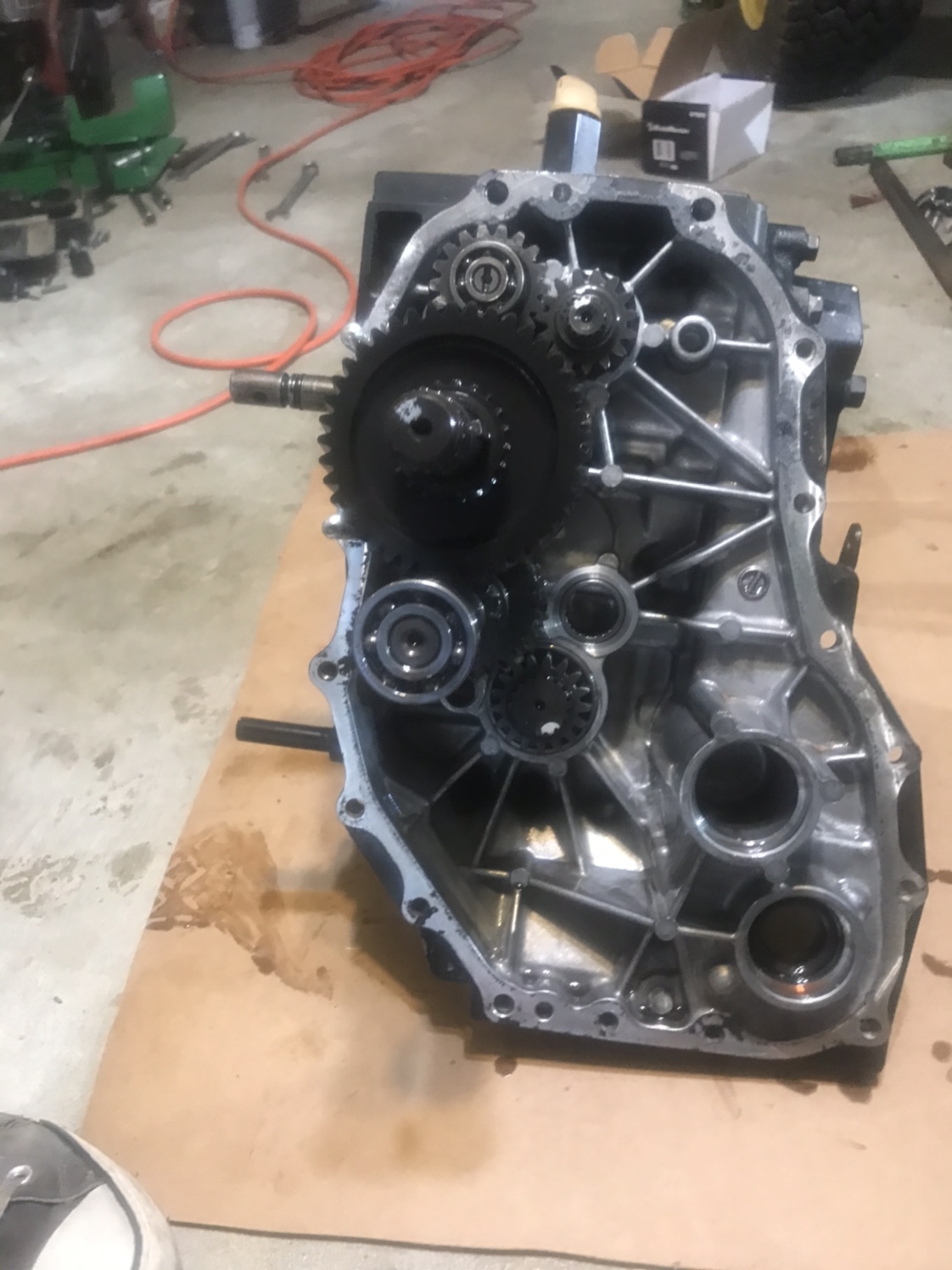

More pictures IMG_0809.JPGIMG_0810.JPGIMG_0811.JPGIMG_0812.JPGIMG_0815.JPGIMG_0816.JPG

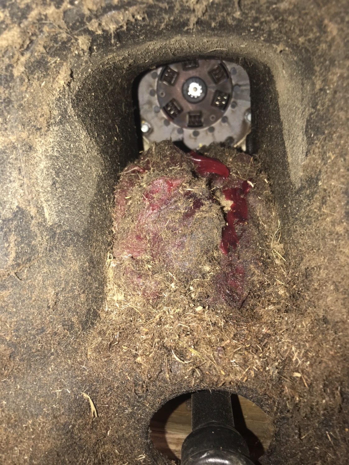

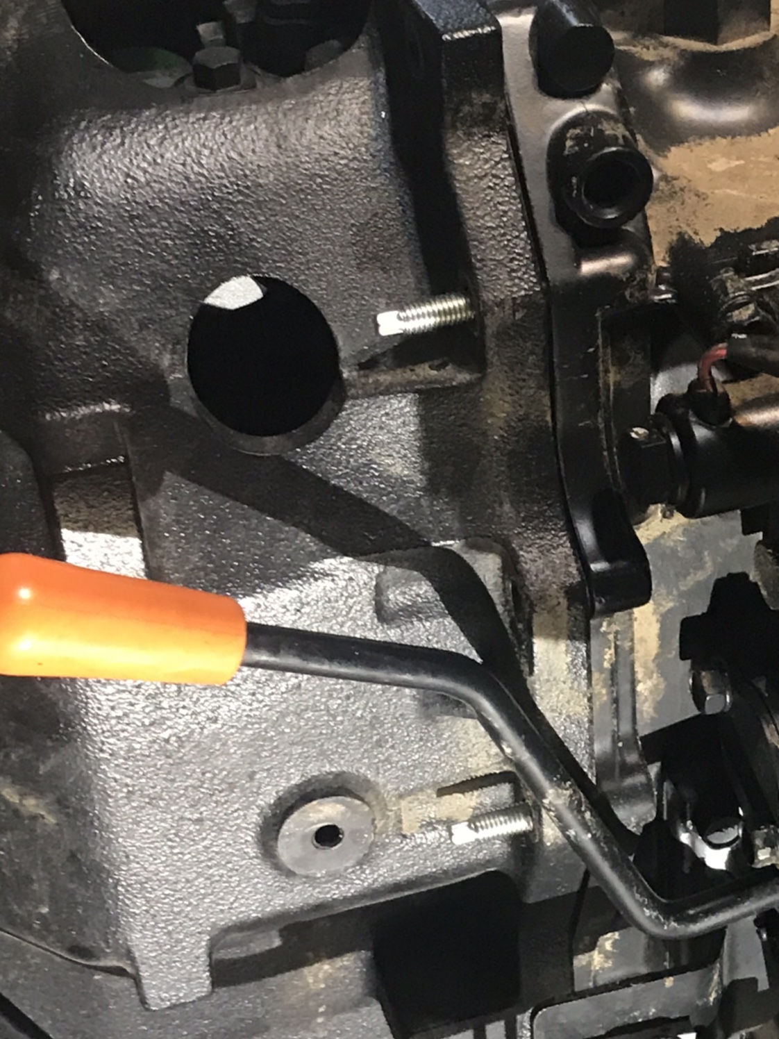

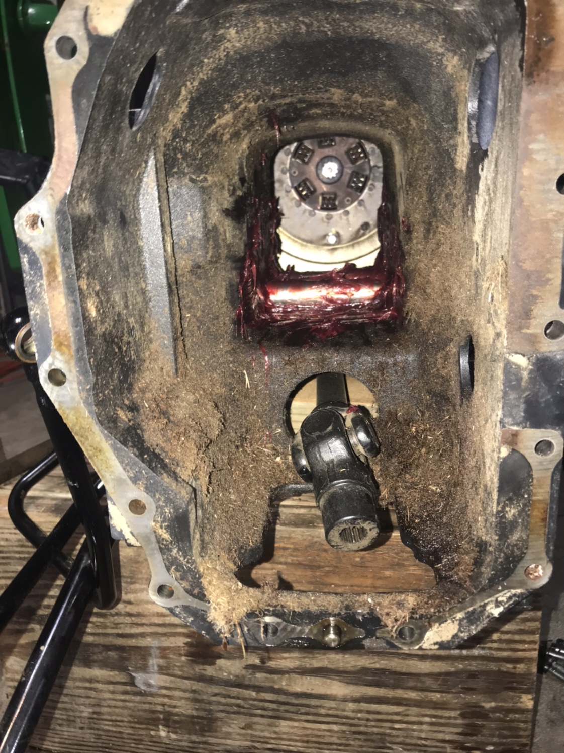

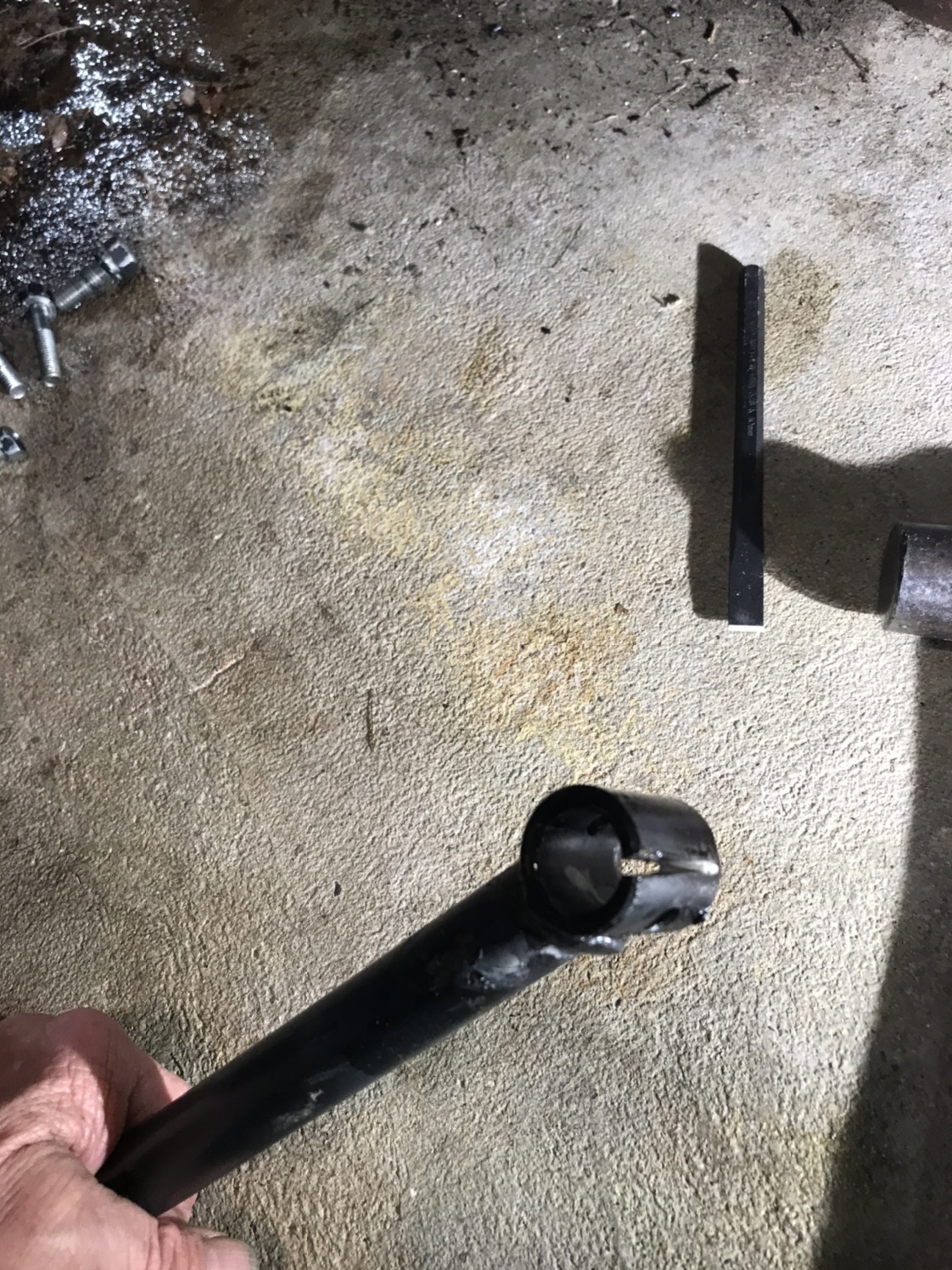

Where do you think the grease came from in that last photo? Do you have a wider shot of this showing the entire case opening?
As someone with a 2720 I really appreciate these photos.
I always wondered why I never seen grease coming out somewhere when I did the linkage, now I know
I’ll clean it up and get more pictures.
   / JD 2720 pops out of 4 wd #14
I'll bet mine is the same because there is that one fitting under the right floor board where you never see grease come out. One time I pumped extra grease in there in an attempt to have it appear and still nothing. Now I know where all the grease is sitting. Hopefully it cannot cause any trouble in there. :)

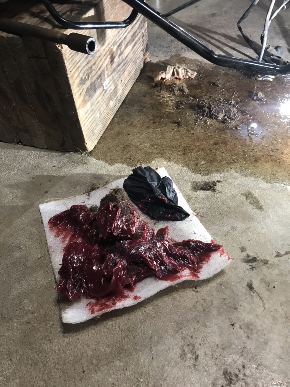

It doesn’t seem to be a problem, I pulled out maybe 1.5 or 2 tubes of grease.
   / JD 2720 pops out of 4 wd #17
Thank you for the photos. Yep... 1 to 2 tubes of grease seems about right. Once it is all cleaned out, can you tell which zerk it comes from and why?

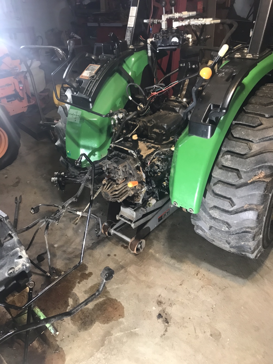

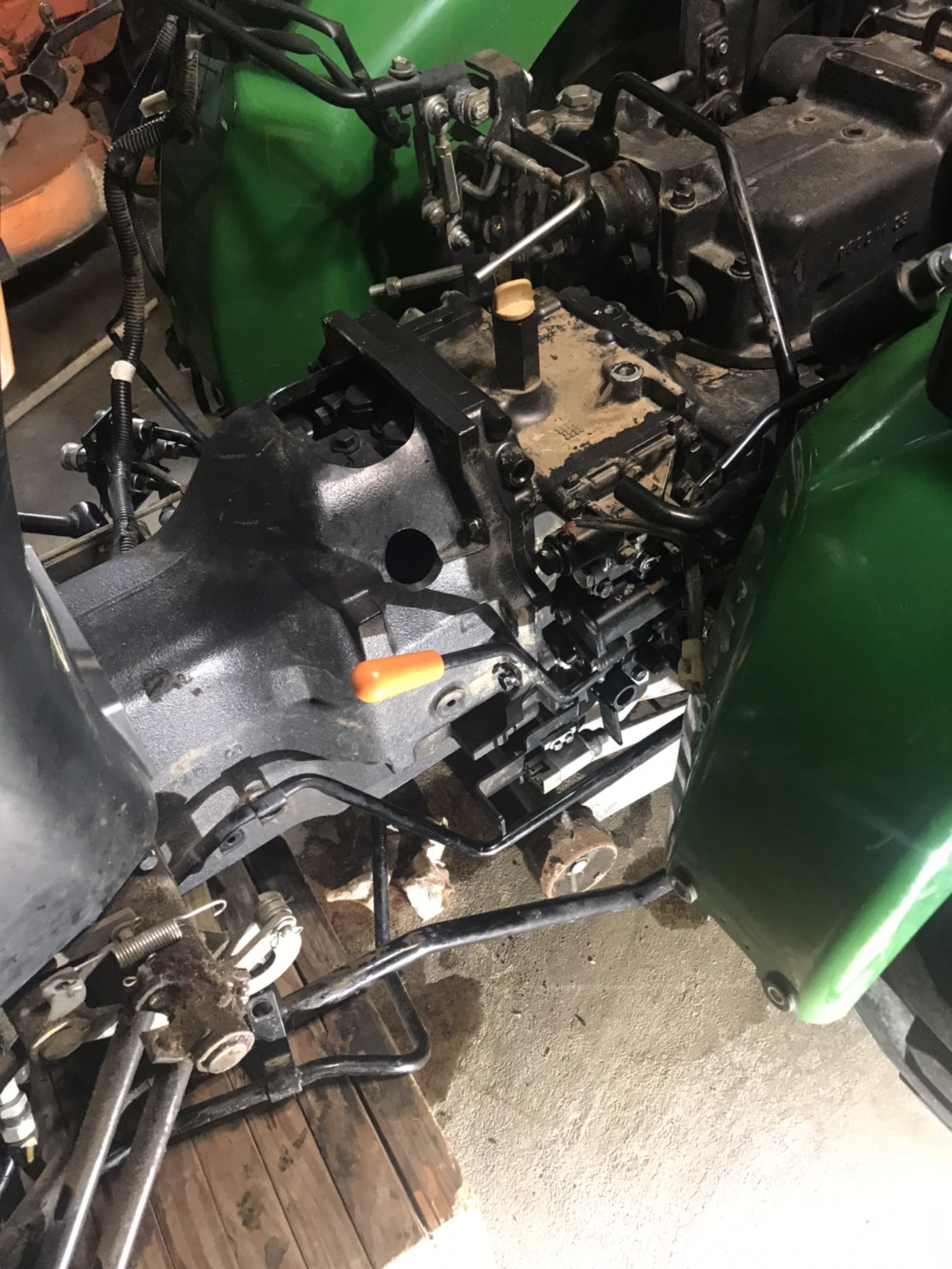

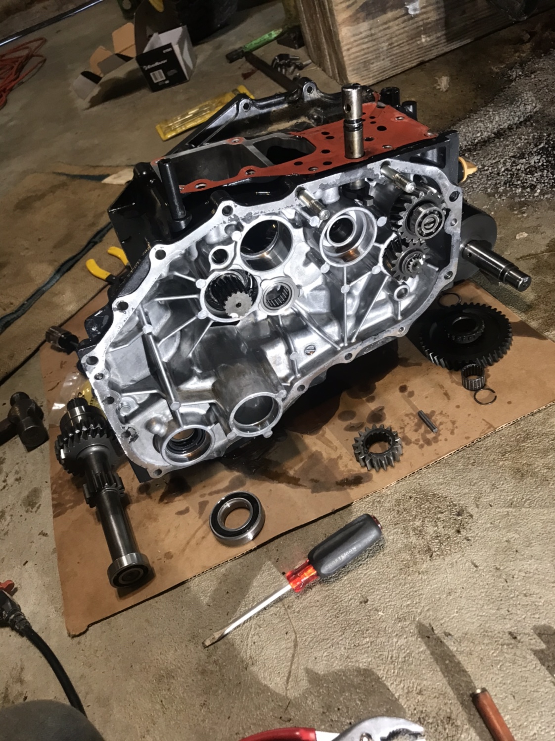

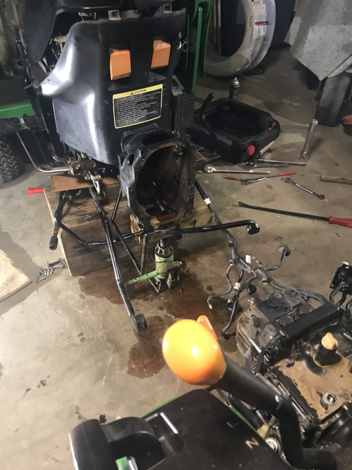

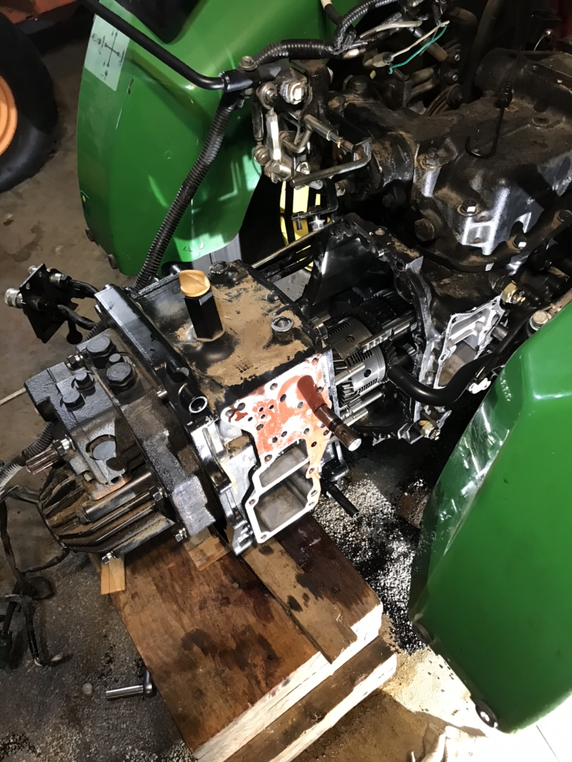

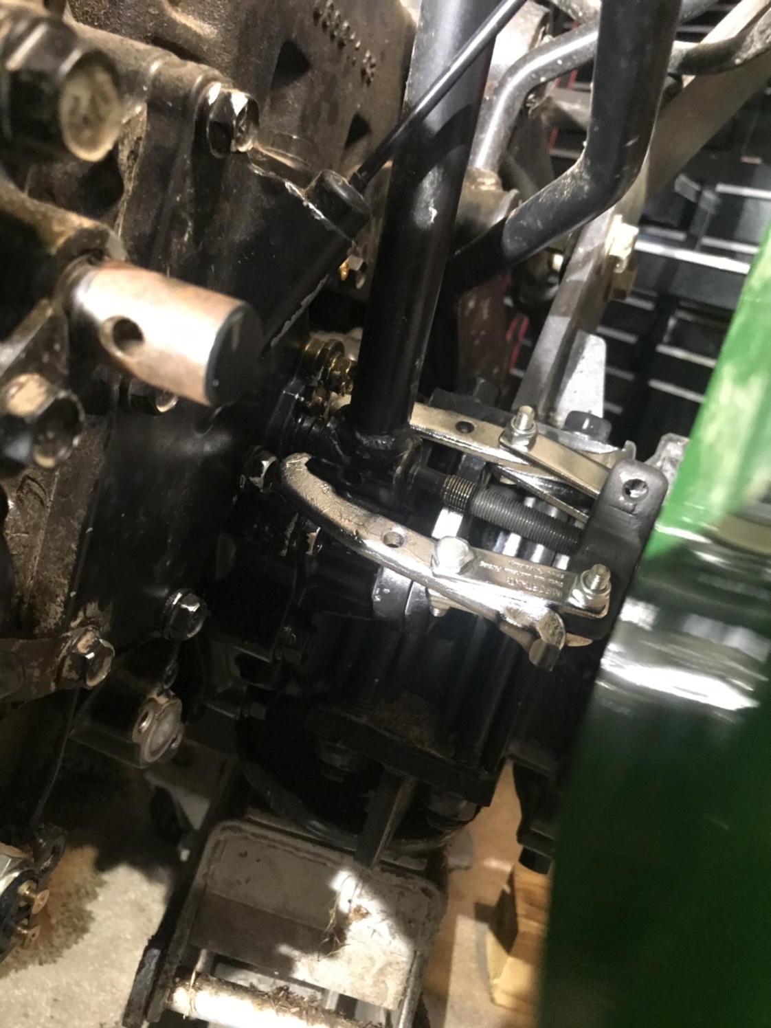

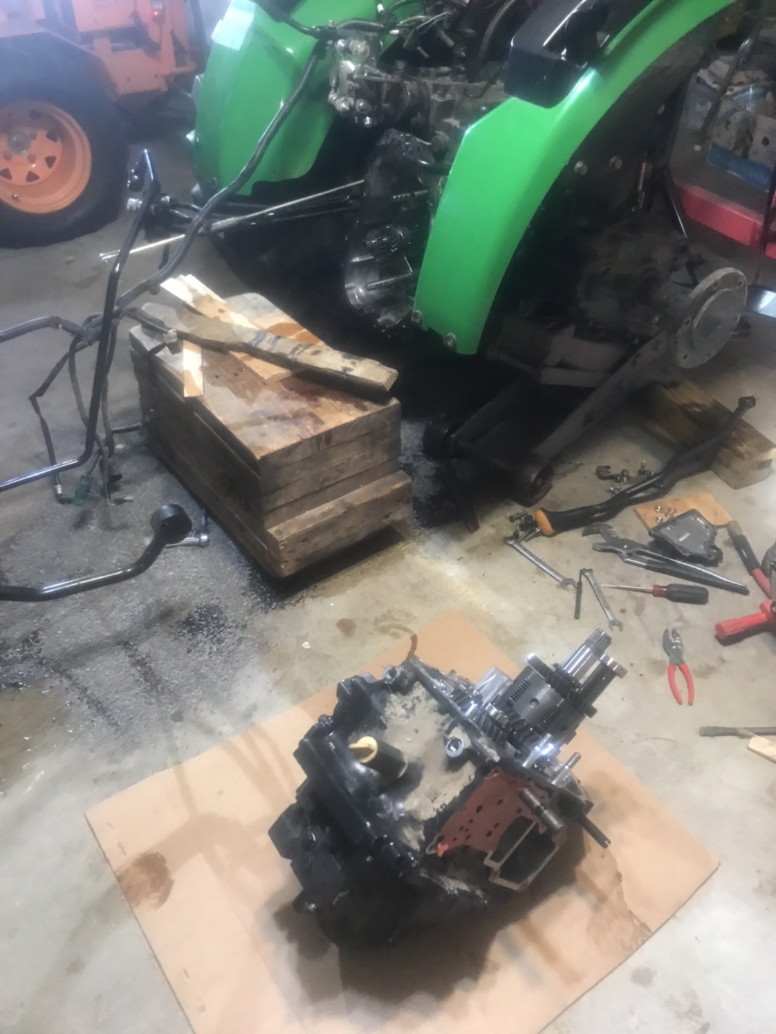

I’m still hard at it. I had a hard time getting the hi and low range shifter off the shaft, I broke the 2 jaw puller and ended up taking a hand grinder and carefully cut as far as I could then take a small chisel to spread it just a little. I played with that thing 4 hours.
Back to the disassembly
IMG_0828.JPGIMG_0834.JPGIMG_0835.JPGIMG_0836.JPGIMG_0837.JPG62880773051__B7100C96-14D8-44BD-95E1-C8B4D8E2F0B6.JPG
   / JD 2720 pops out of 4 wd #19

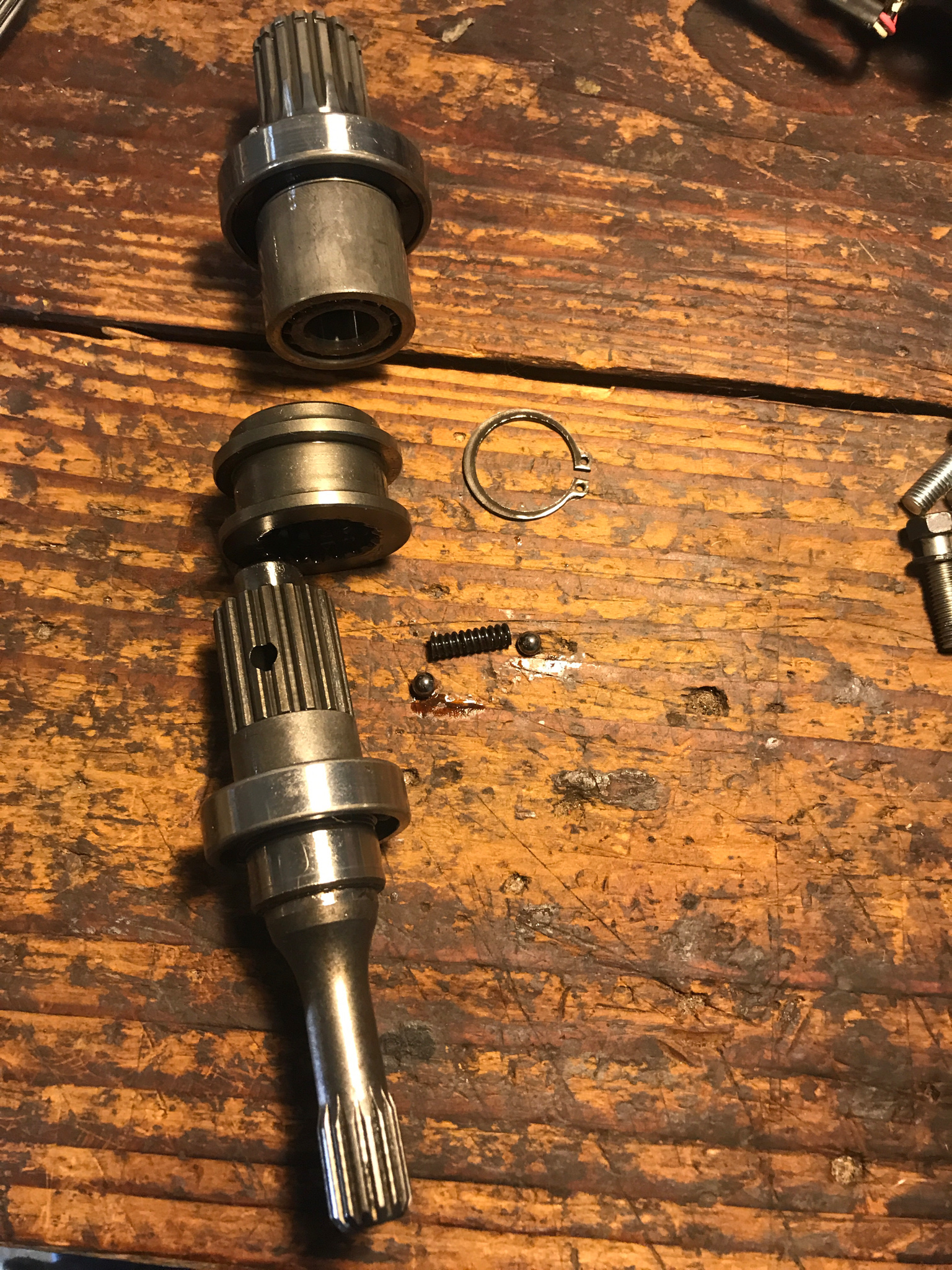

Wow... I can only imagine what this repair would cost at the dealer. And all for a simple 4WD lever detent.
#20

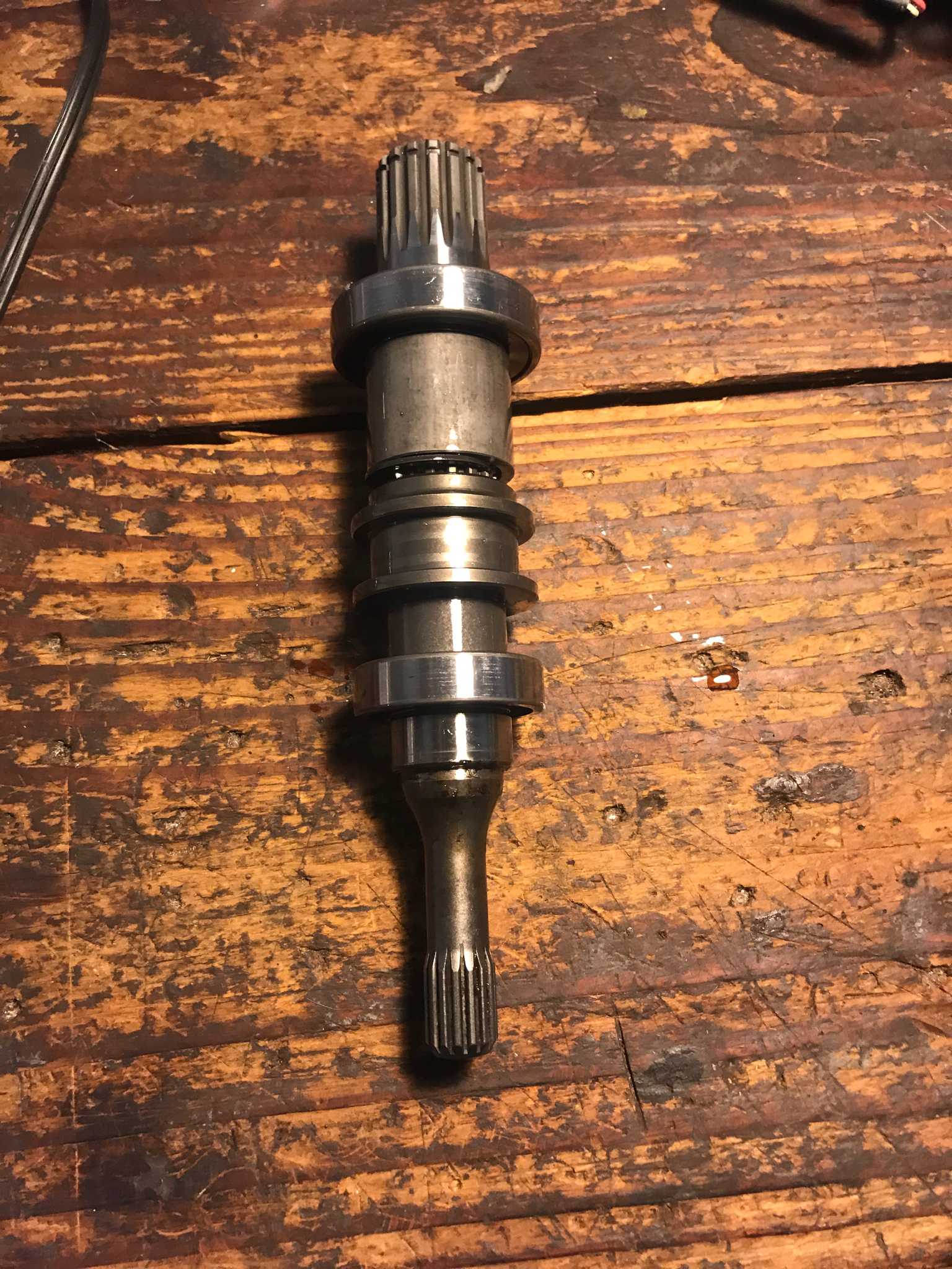

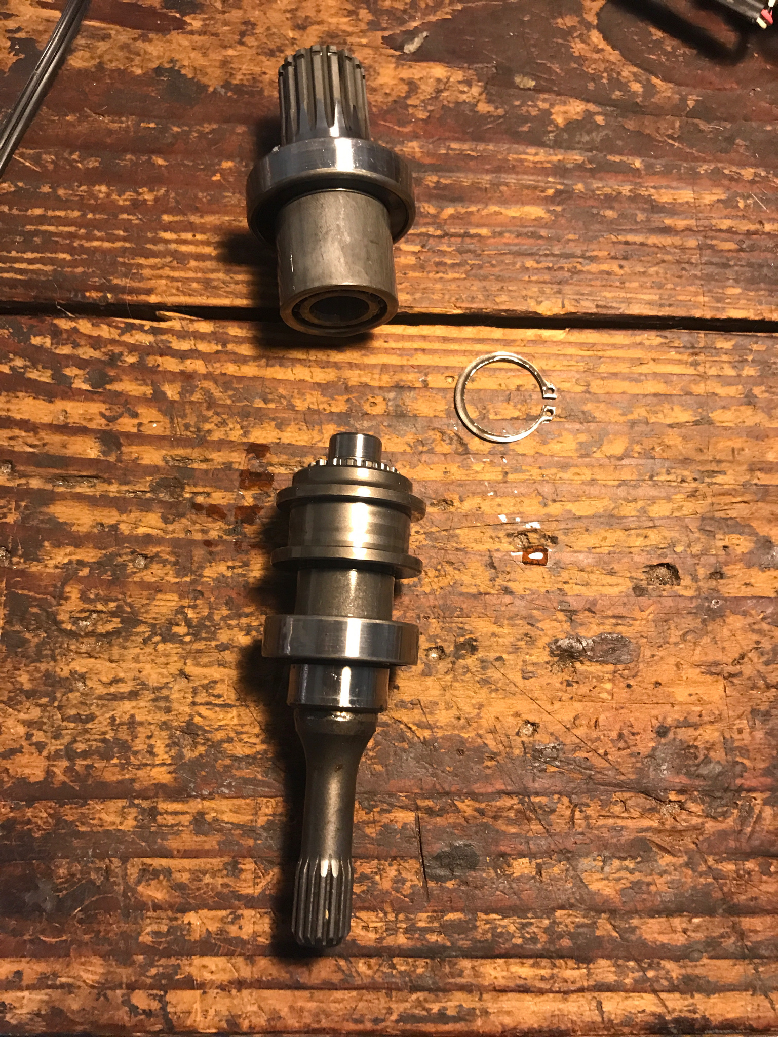

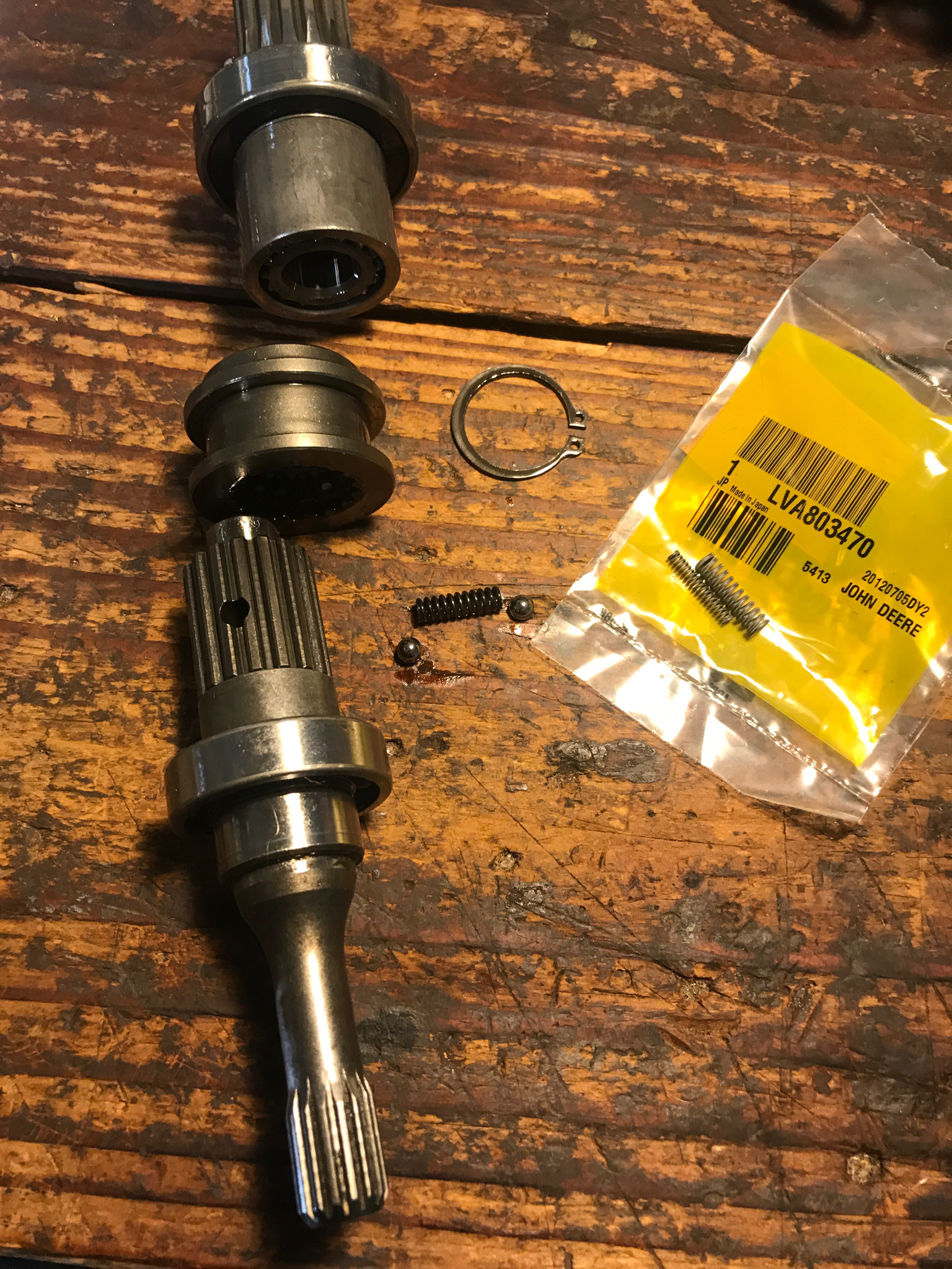

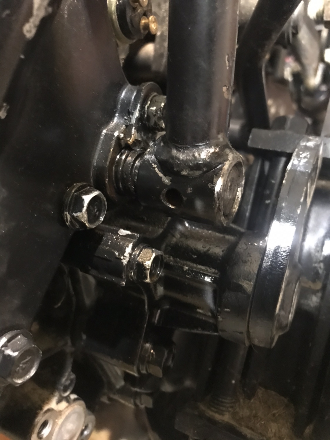

Finally got the MFWD shaft out
Here is the new double spring
