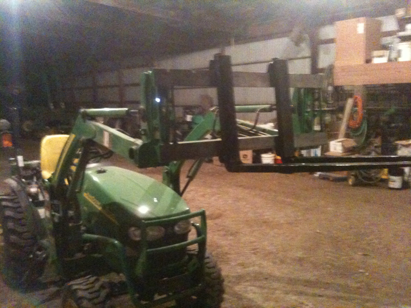

I have had both, currently the 2720. I use my 5' brush hog a lot. I stayed with the 2k series because of size/weight.
Rear PTO is really the only area where you will notice a difference and you will notice it. It may only be 3 PTO HP, but when comparing such small numbers it is a significant %.
For forks on these small tractors I recommend the one you can read about on here by searching "lightweight pallet forks"
