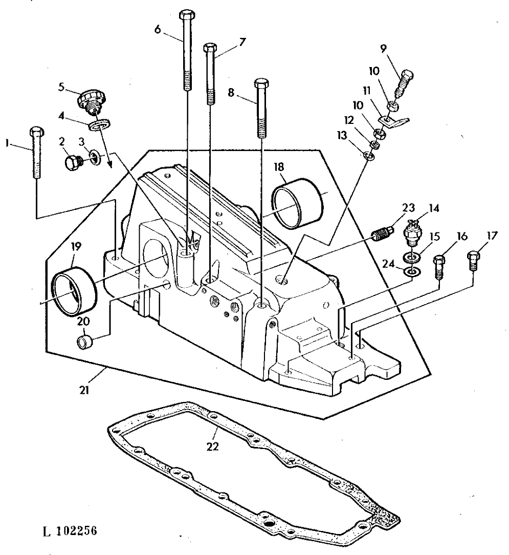

I went to the farm and the tractor started right up like there never was a problem. I bushhogged for a few hours and stopped to move some logs and to clear the dust and seeds from the radiator and grill. Then it wouldn't start. The batterys have 12.88 volts. Jumping didn't help. There is no loose belt or electrical connections to the starter or alternator. I took off the plate covering the shifters and saw no problem there other than a wire with a spade connector coming from the harness that seemingly had nowhere to connect. There is also a similar wire/connector near the alternator with seemingly nowhere to connect it. The engine and hydrolic oil levels are good. There is power to the ignition switch. The PTO is off, shifters are neutral, clutch depressed. I'm depressed. The tractor is out in the field and I won't be able to do anything about it until Wednesday. What does the neutral start switch look like?
   / JD 2940 Won't Start #9
Parts key #14 in photo. If you can't "CAREFULLY"jump across the "S" terminal and the large upper terminal on solenoid and excite the starter then you have a voltage/amperage problem or possibly starter/solenoid problem. Do not try to tow start your tractor that has the hyd hi-lo.
