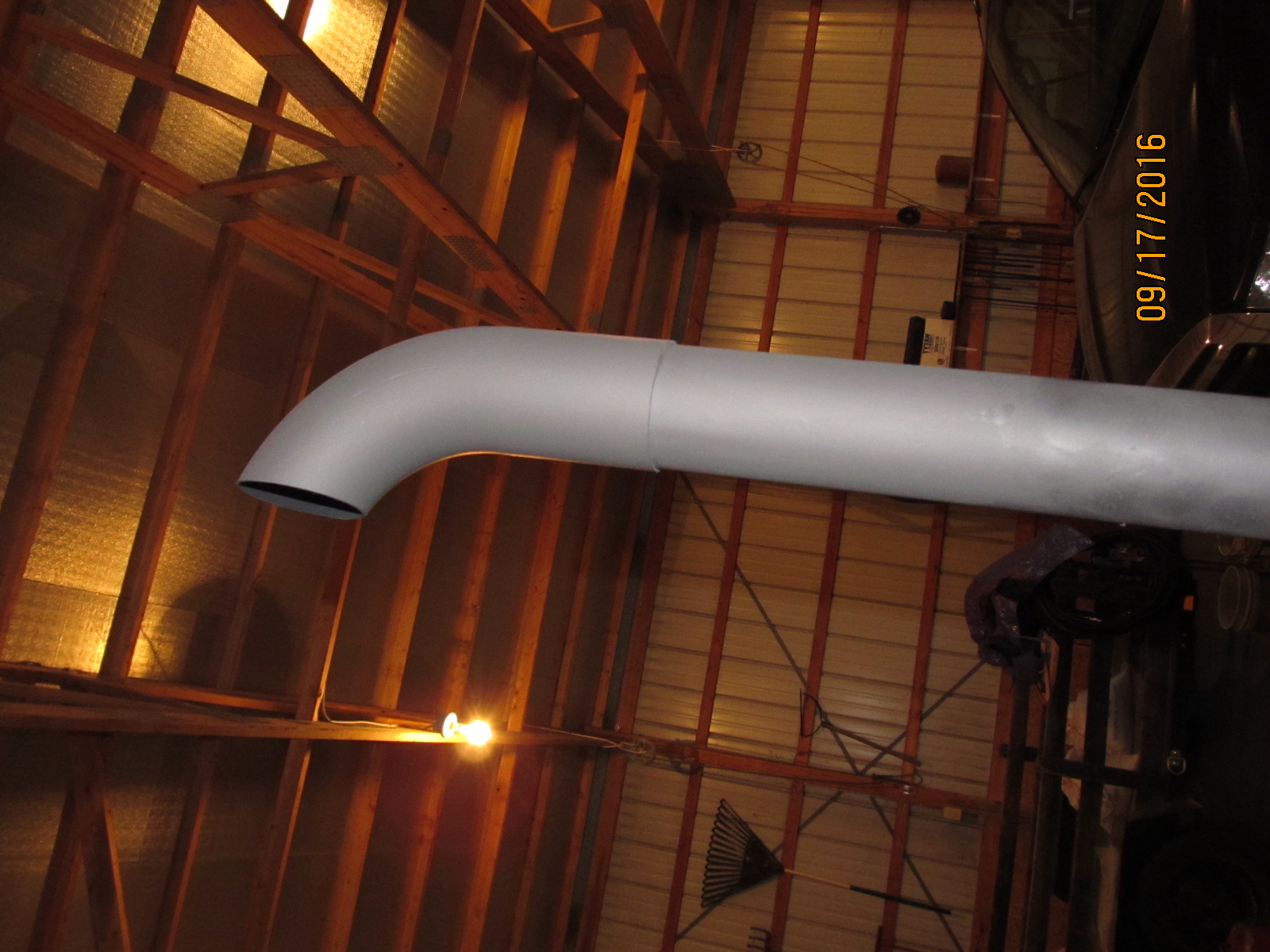

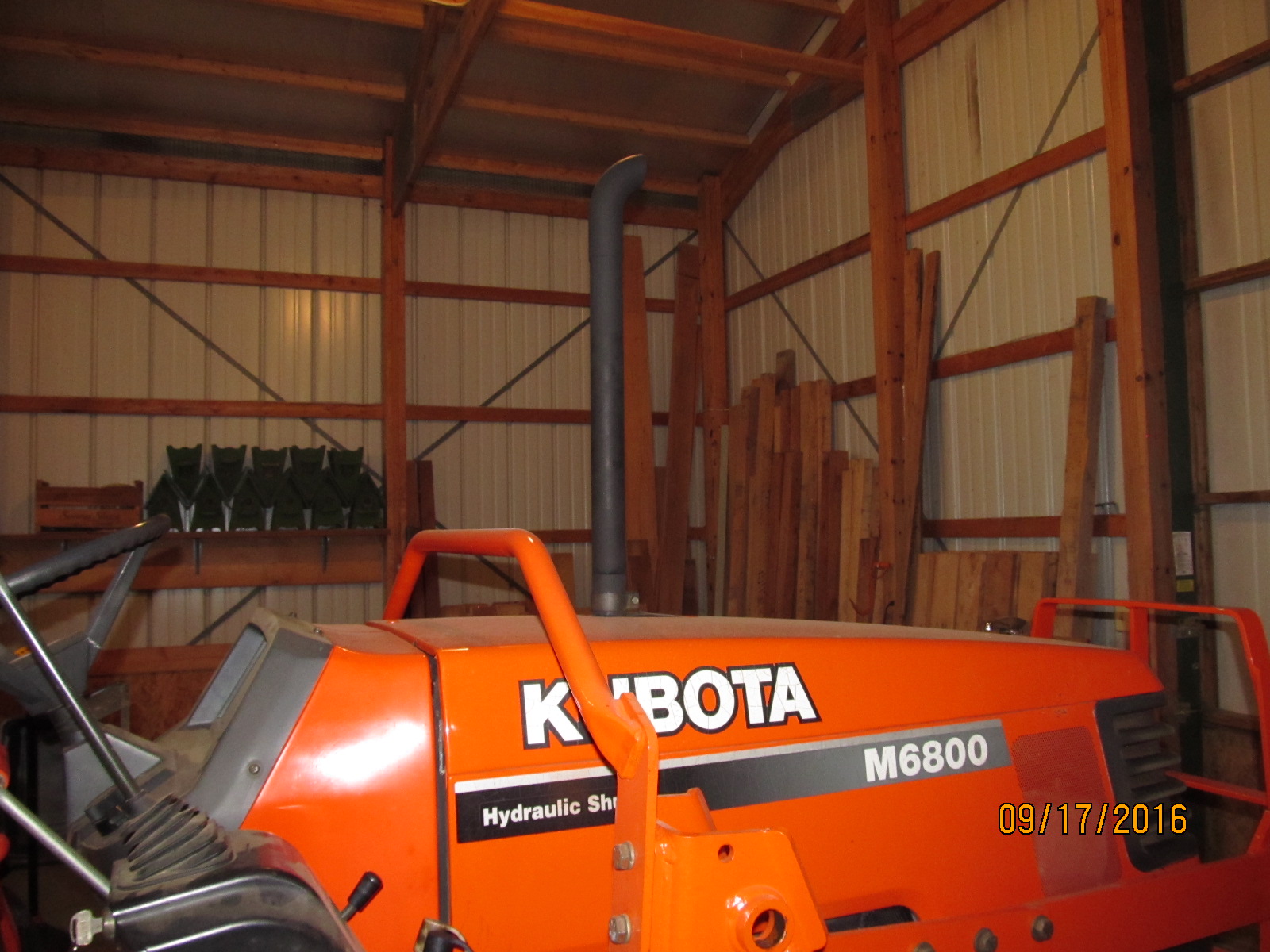

   / JD 3005 exhaust mods/replacement #24
I did something similar and used a dragster exhaust mandrel bend pipe. It fit and looked perfect, cost under $20 and was a perfect bend as sharp as your potential bend. I think I bought it a Summit Racing. If it could take a couple thousand horsepower (or whatever) four inches from the head, it could take my 30 HP tractor.
Just for chuckles, here's my leftover piece of dragster, mandrel bent tubing. I discovered it slipped tightly over the end of my exhaust stack end where the prior owner cut it off to affix a rain cap flapper (!). The replacement cost of a new ($10 value) OEM exhaust stack was almost $200--- :eek: --- and my leftover piece of dragster tubing maybe $8. It was a no brainer plus it looks like it "belongs", looks OEM and was delivered free of shipping charges.
If the photo is sideways, it beats me. At least it didn't double post.
#25
A little closer...
   / JD 3005 exhaust mods/replacement #26
Where the He** did you learn how to weld??? :p
Nice, very nice!!!!
#27
Thanks... Mostly self taught, with lots of questions asked and good advice given of truly good welders. Im good at holding metal together, but Im no welder!
   / JD 3005 exhaust mods/replacement #28
Me too Greg. Well stated. :)
   / JD 3005 exhaust mods/replacement #29
However... Im doing this low-buck... Im using 1.5" scd 40 pipe and EMT conduit that I have on hand. .
Ha ha, we must be lost brothers, I have run a "long sweep" 90* emt on my last 3 7.3 PSD. I remove the tailpipe at the joint under the cab and turn it out just in front of the rear wheel. Hillbilly deluxe performance exhaust. The turbo sing's a beautiful song with this cheap set up, and it last's for years. But it's prolly a little cooler (longer) than your tractor situation.:thumbsup:
