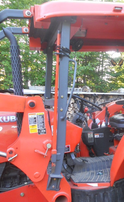

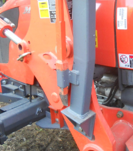

That should be real handy! I made a spot vertically on the front post to carry a "pinch bar" kinda like a small digging bar. It's handy for hooking up the heavier 3 pt. implements and in general, a handy lever to have with you. It's hard to see as it's painted to match the tractor. I am amazed how handy the mirror I put on the other front post is also.

Paint not so pretty right there, almost covers up one of the most noticeable thin spots where you can see primer thru the green.
I had one on each side before the cage install, need another set of brackets for the second one.
