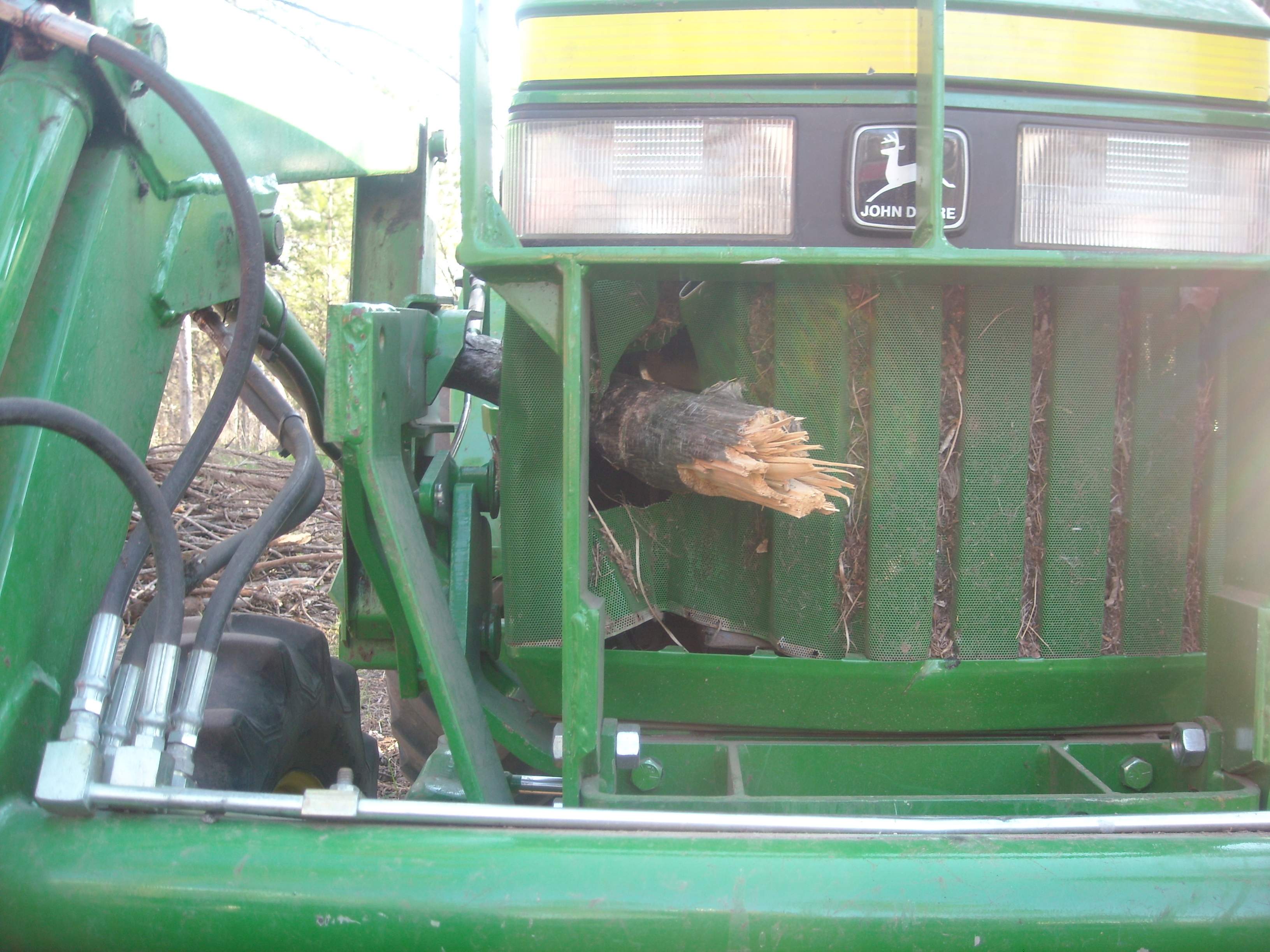

OH....and this is why your going to be glad you added the HD brush guard to the front of that new tractor. :laughing:

OUCH!!! Yep, that's exactly why. First day I used it I picked up a 4' chunk of 12" diameter limb I'd cut up, and when I rolled the bucket back, a broken-off stub about that size came around and (thank goodness) hit the guard frame. It caught on the frame, but it was just pure blind luck it didn't end up looking just like yours. Right then and there I decided no more of that until I built some sort of better brush guard.

Yep....and I made the new and improved version shortly after my above incident. Operating in timber is ruff on everything.....even if your careful. I'm going to be selling my 790 soon.....and its a nice tractor.....but I suppose that grill damage is gonna cost me something in value.

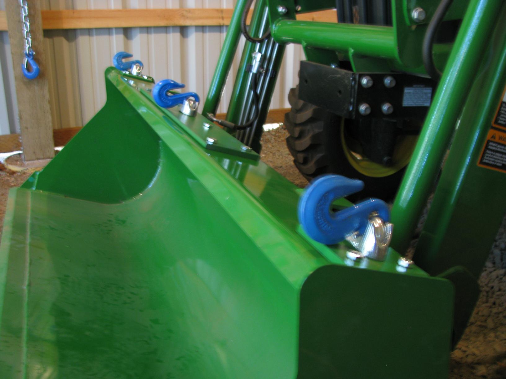

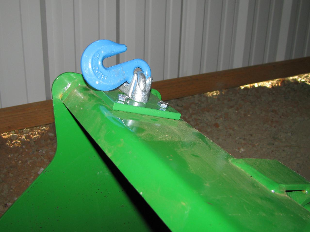

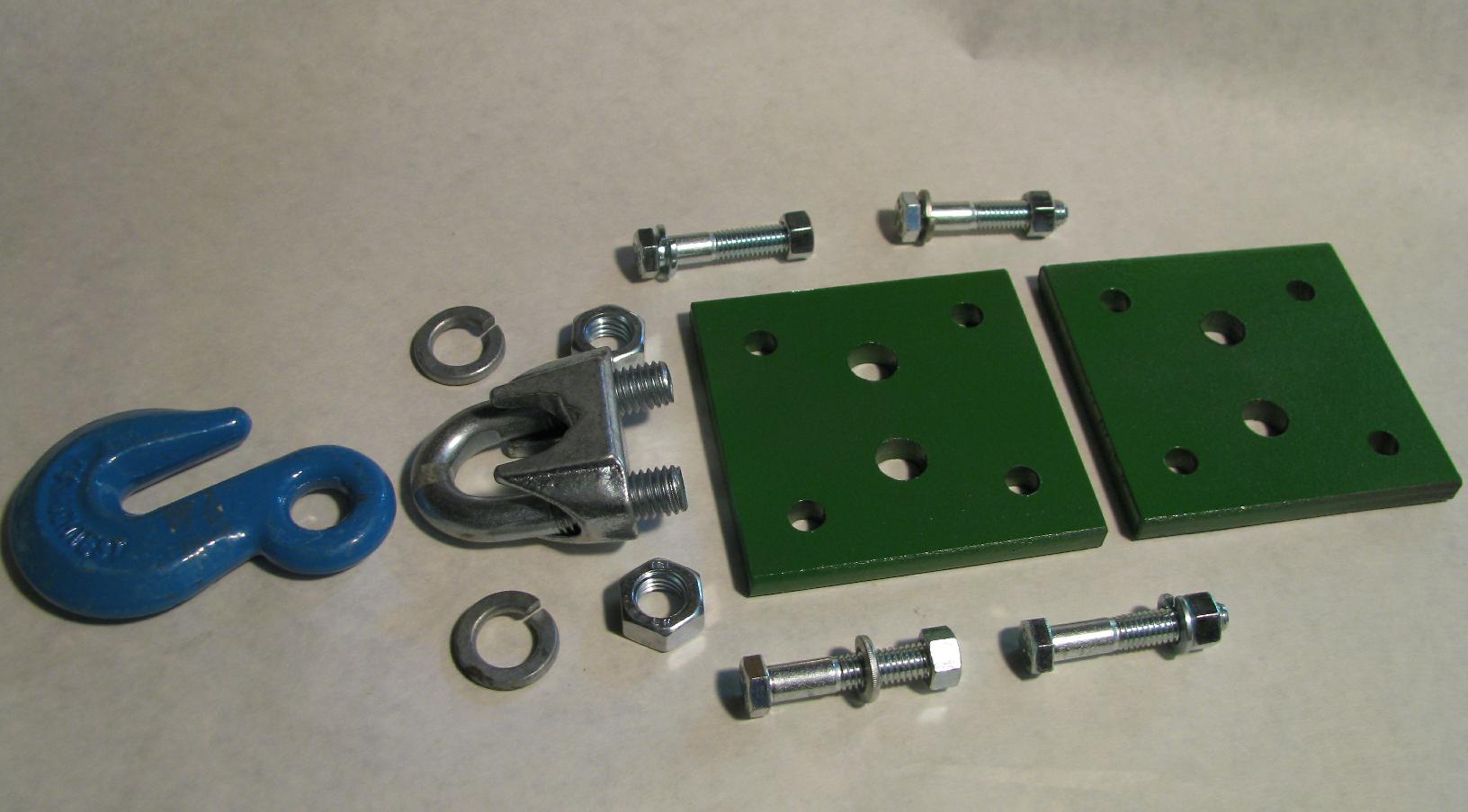

Hooks can be attached without welding by using cable clamps as shown in the photos. I used 3/8" x 4" plate to reinforce the top of the bucket, with another same sized piece on the inside. Corner bolts are 3/8" and the cable clamps are 3/4" size.
