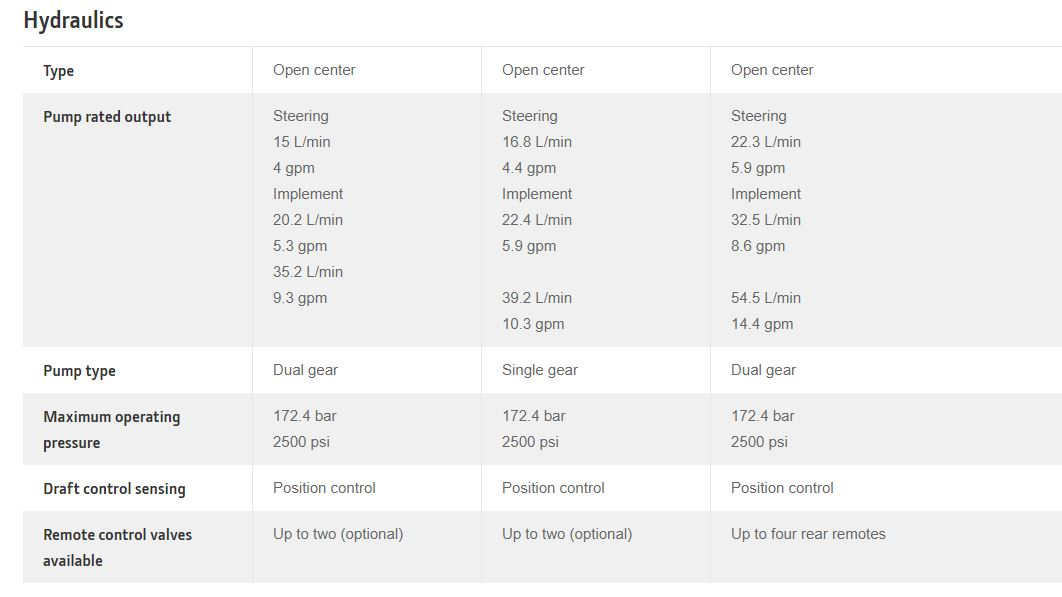

A better compare and contrast is going to be what chores you are using your 1050 for currently. Loader work the 3032e will run circles around a 1050. Hydro, SCV, greater lift capacity and higher hydraulic flow will make a world of difference. If you are using it for things like bush hogging you will notice that the 3032e seems a little more bumpy due to smaller tires and a little more unstable due to a narrower wheel stance but wheel spacers help with that and IMO are well worth the investment.
   / JD 3032E #5

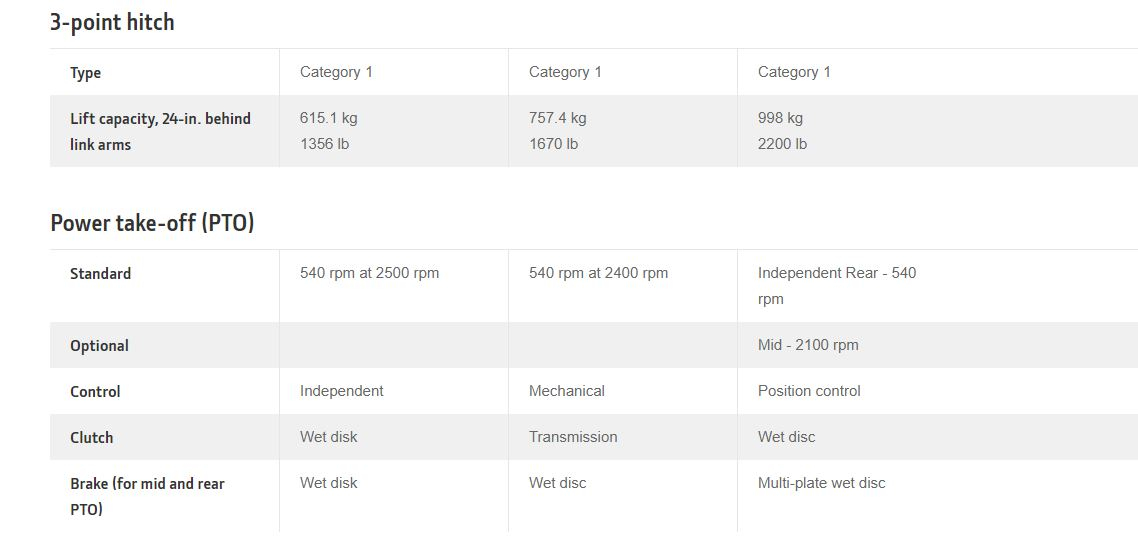

I have a 3032e currently, got a good deal on it. If I was doing it again, I would find a D or R 3 series.
Compare compacities on JDs site, the 3033r and the 3035D are much better tractors, same footprint though
3032E 3035D 3033R
