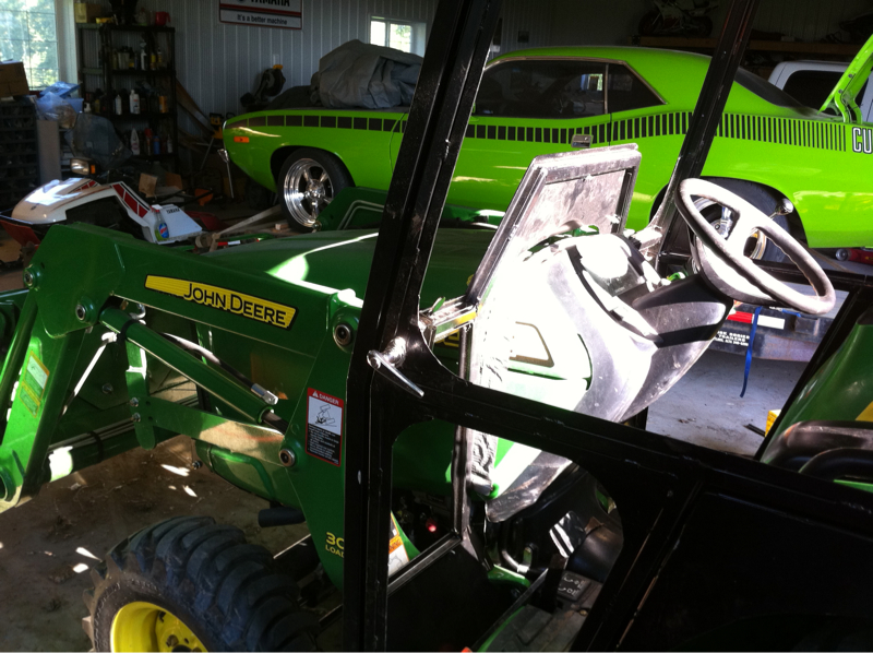

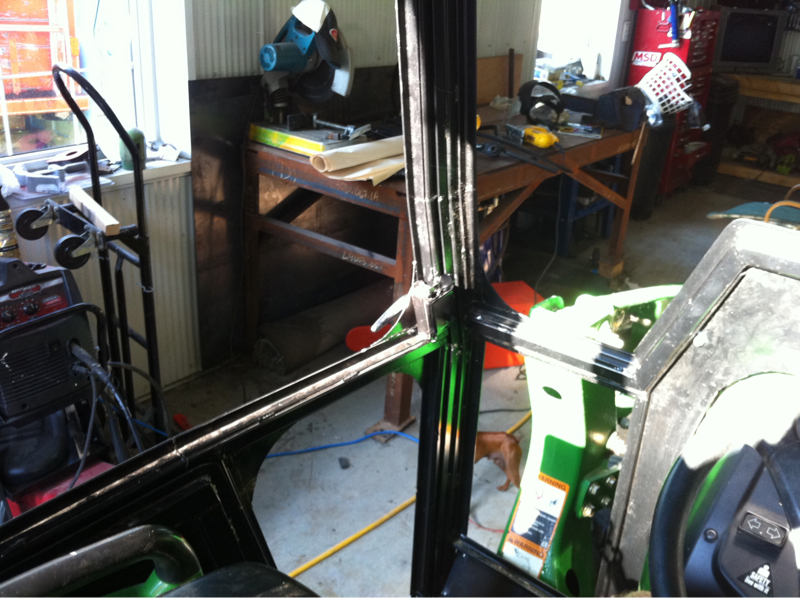

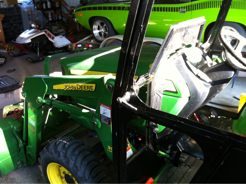

Had couple hours . Mounted door latch from an old combine from father in laws. Also got all rubbers for windows from it. Unfortunately the windows are tempered so unable to cut them to size. I had some plexiglass laying around to try in a small side window. Cracked when cutting with jigsaw. Cut it with die grinder. Very messy. Next time i get home will just bite the bullet and buy all windows. As far as Someone mentioned just make all pieces from one side to other same.i hoped the same also. The front and rear frame were set on on welding table squared and welded. Thats it unfortunately. As door is different shape, size then other side. For the top I squared front to back and then welded pieces in. Almost all brackets had to be made individually. To ensure proper gaps at fenders, floor pans, where loader meets front of cab , the door had to be different then other side to make it easy to enter exit, etc. etc.
