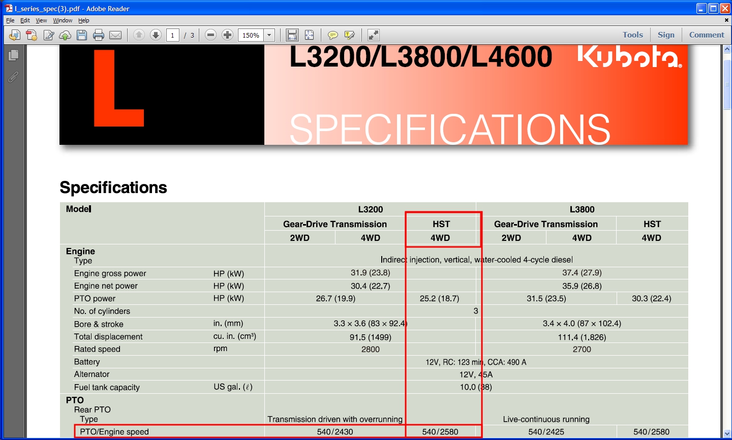

For those of you with L3200 HSTs and the 2400rpm PTO marks, I'll happily stand corrected if it was indeed a publishing error, but another possibility is your tractors have tach boards installed that were intended for the gear'd tractor model. You may want to consult Kubota to be sure.
