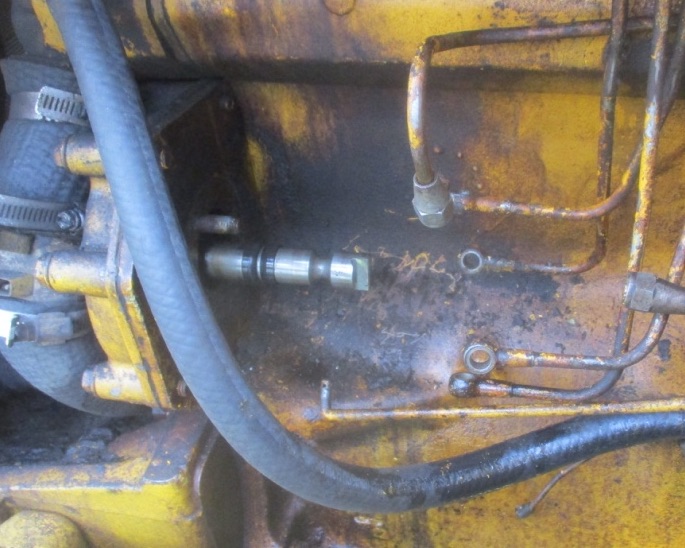

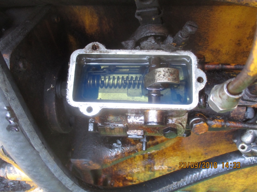

1 more thing.. if the MV is free, put the cover back on..
Remove the inlet fitting{brass elbow} & fill that inlet piece on the inj. pump w/ fuel, all the way to the top..
Now crank the engine.. did the fuel get sucked in?? or is it still at the top?? IF its at the top, that means the internals aren't spinning & sucking it down.. Time to pull the pump..
Let me know how it goes.. U can reach me direct if u want.. click on my screen name & send me an email..

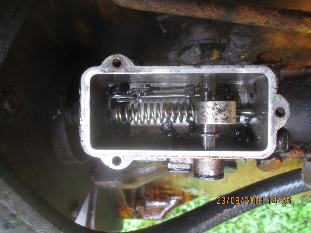

Yes, the MV moves freely.
I got a surprise when I took the cover off. It was full of fuel that I drained off and then saw some black gunk.
Where do I go from here, talk to my bank manager?
Thank you again TPG, you're helping me a lot and probably some other people also.

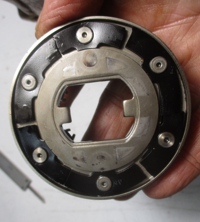

That's the classic "mouse turd" syndrome.. or coffee grounds..
The flex ring has come apart inside the pump.. & a rebuild is required.
I can help you out w/ that.. just click on my name..

Well, TPG was right. The flex ring had come apart, 6 parts to be exact.
I am doing the rebuild myself to save a fair amount of money. It's a bit scary.
There are so many parts. I doing on slowly and I have some videos on my
computer by my side. And I take pictures all along. So far so good.
