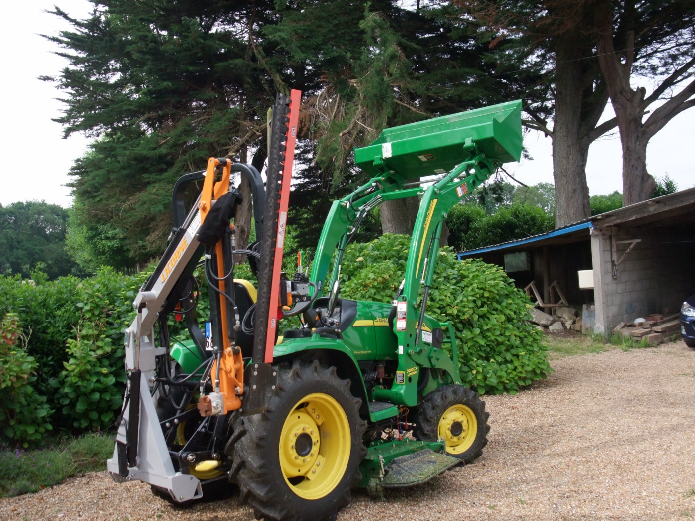

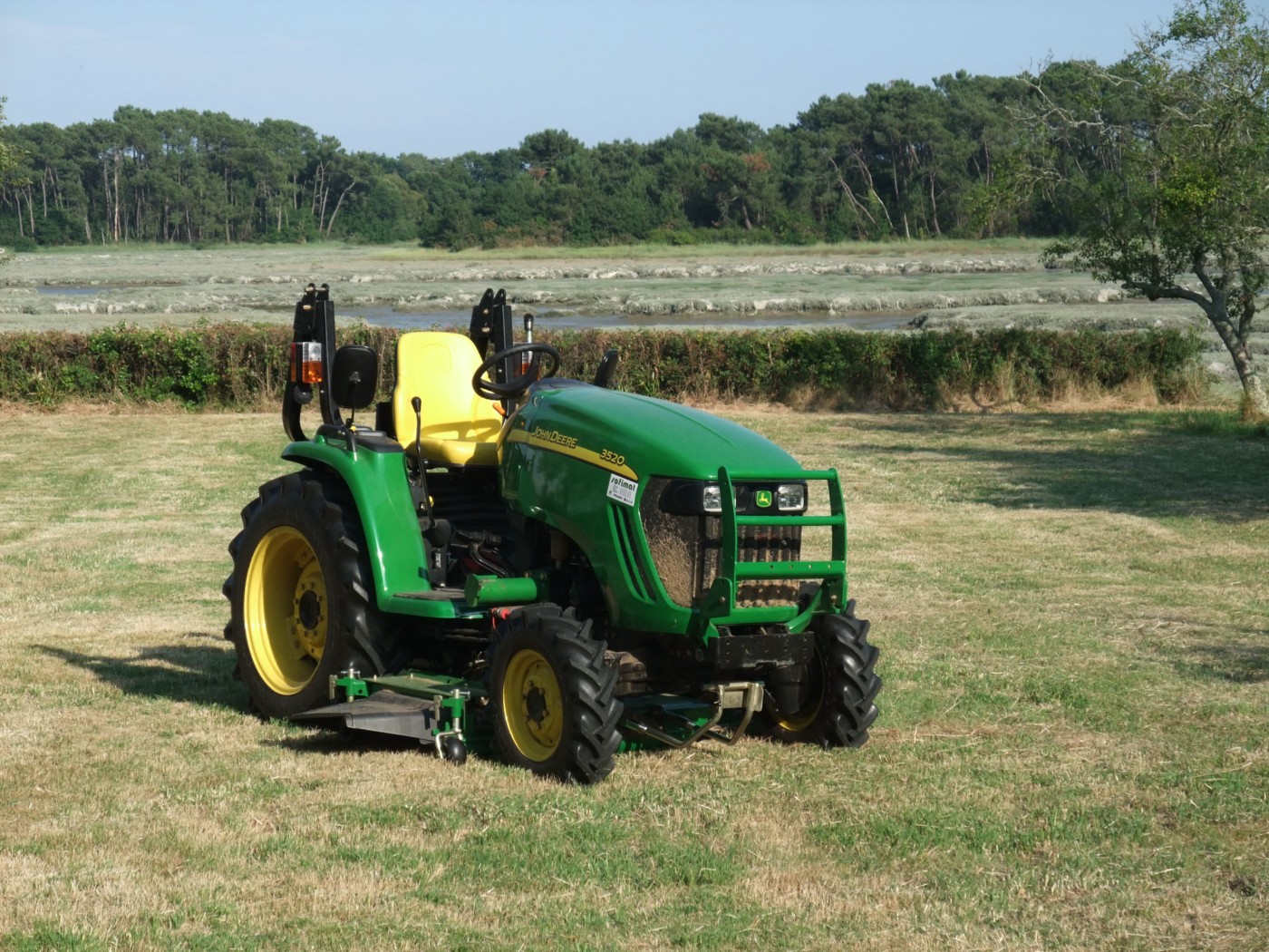

A few indications from the 3520 manual :
Dimensions
NOTE: Height and width dimensions can vary due to dimensional growth of tires.
Wheelbase 1.7 m (68 in.)
Overall Length w/ 3-Point Hitch 3.1 m (120.2 in.)
Overall Width w/ R1 Tires (Minimum) 1.3 m (52.4 in.)
Overall Width w/ R1 Tires (Maximum) 1.7 m (68.4 in.)
Overall Width w/ R3 Tires (Minimum) 1.4 m (53.9 in.)
Overall Width w/ R3 Tires (Maximum) 1.5 m (59.1 in.)
Overall Width w/ 43 x 16.00-20 R4 Tires (Minimum) 1.5 m (58.1 in.)
Overall Width w/ 43 x 16.00-20 R4 Tires (Maximum) 1.5 m (59.7 in.)
Overall Width w/ 15.00-19.5 R4 Tires (Minimum) 1.4 m (57.3 in.)
Overall Width w/ 15.00-19.5 R4 Tires (Maximum) 1.5 m (58.9 in.)
Overall Width w/ Golf Tires (Minimum) 1.5 m (59.5 in.)
Overall Width w/ Golf Tires (Maximum) 1.6 m (64.7 in.)
Inside Width w/ R1 Tires (Minimum) 1.03 m (40.6 in.)
Inside Width w/ R1 Tires (Maximum) 1.4 m (56.6 in.)
Inside Width w/ R3 Tires (Minimum) 1.02 m (40.4 in.)
Inside Width w/ R3 Tires (Maximum) 1.2 m (45.6 in.)
Inside Width w/ 43 x 16.00-20 R4 Tires (Minimum) 1.1 m (42 in.)
Inside Width w/ 43 x 16.00-20 R4 Tires (Maximum) 1.1 m (43.7 in.)
Inside Width w/ Golf Tires (Minimum) 1.02 m (40.3 in.)
Inside Width w/ Golf Tires (Maximum) 1.2 m (45.5 in.)
Inside Width w/ 15.00-19.5 R4 Tires (Minimum) 1.1 m (42 in.)
Inside Width w/ 15.00-19.5 R4 Tires (Maximum) 1.2 m (43.7 in.)
Height From Ground (Tractor without cab, with standard R1 tires)
To Top of Hood 1.4 m (57 in.)
To Top of Folding ROPS 2.4 m (93.3 in.)
Height From Ground (Tractor with Cab, R3 tires)
To Top of Cab 2.3 m (89.4 in.)
Weight
All Models (without cab) 1316 kg (2900 lb)
All Models (with cab) 1619 kg (3570 lb)
