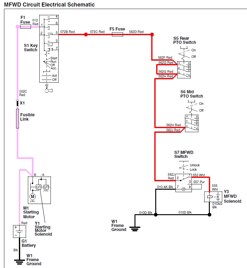

Instead of just wondering I decided to research it. There is no clutch. MFWD is engaged the same way whether it has an electric switch or a manual lever. It is a simple collar shift. With the electric switch the manual lever is replaced with a hydraulic cylinder, and the light is simply turned off/on by the switch. Seems like the cylinder might be harder on the gears. Interesting point is that the MFWD is engaged by default when using the hydraulic cylinder. It requires power to activate the cylinder to disengage MFWD.

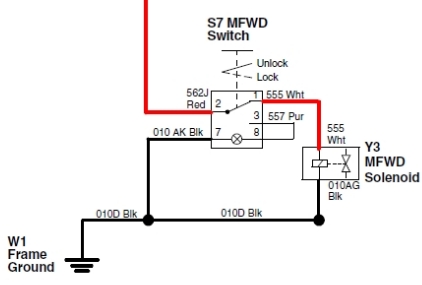

The information I attached shows the light is simply part of the switch. It knows nothing about whether the gears are engaged or not. I agree you will immediately notice in a turn if they are engaged, but straight line you may not be able to tell. It could be possible to drive a distance on dry pavement and not know it is still engaged. Remember too that the previously attached info shows the tractor defaults to 4WD with engine off. Something good to know if you tow the tractor. There are advantages to simply having a mechanical lever.

Examined the schematics and JD's guidance on how it works. Three things:
This doesn't seem right...it says on eHydros (mine) and PowerReverser (manual shift?) the hydraulic cylinder is involved. So its not just those with the MFWD button that default to 4WD when turned off. If this were correct, we wouldn't have resistance on the lever when we disengage it and its wound up.
I'm not too good with electrical schematics...where is the indicator light for when MFWD is engaged?

The hydraulic cylinder is on machines with electronically controlled transmissions. This would be the eHydro and ePowerReverser. Some 4x10 machines have the mechanical Hydro or mechanical PowerReverser. Some have the mechanical SyncShift. That one is the SST. All these other transmissions replace the hydraulic cylinder with a mechanical lever that will put the tractor in 4WD only when the lever is placed in that position. The lever will stay in whatever position you leave it.
The light is the circle with the x in it. When you turn the switch ON that provides power to the light, and removes power from the shift solenoid. This shows the light does not know whether gears are engaged, and also why the system defaults to 4WD when the tractor is turned off.
I'm not clear on your question about lever friction. Your 3520 does have a light, but does not have a pushbutton. It has a lever so yes you will feel the friction unlike those that just have a pushbutton. The button was only on some 4x10 series tractors.
