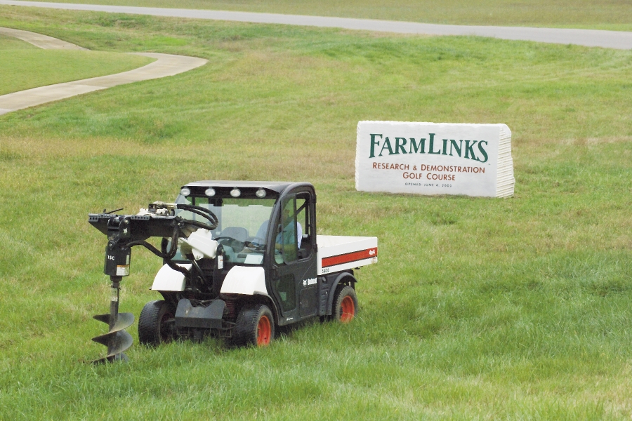

Why would drilling post holes or loading a trailer be a problem?

Drilling post holes is not an issue. Actually much easier with Toolcat than rear PHD. Even better than FEL PHD due to auger right in front and easier to see and higher flow rate of the Toolcat. I turn bits as big as 36" (largest available bit is 42") with my bobcat auger. Few tractor mounted units can do that.
Loading height is more restrictive on the Toolcat due to 7' lift limitation but it should load most dump trailers unless have high sides on the trailer.
