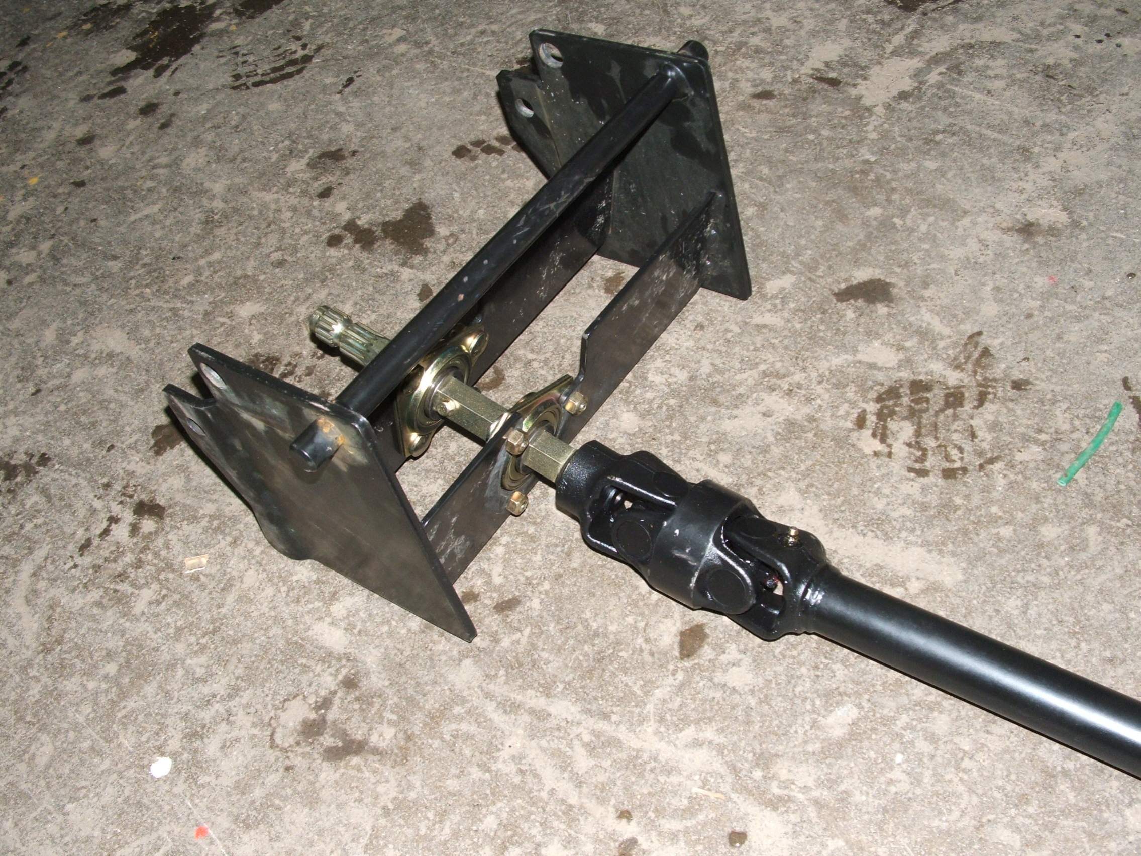

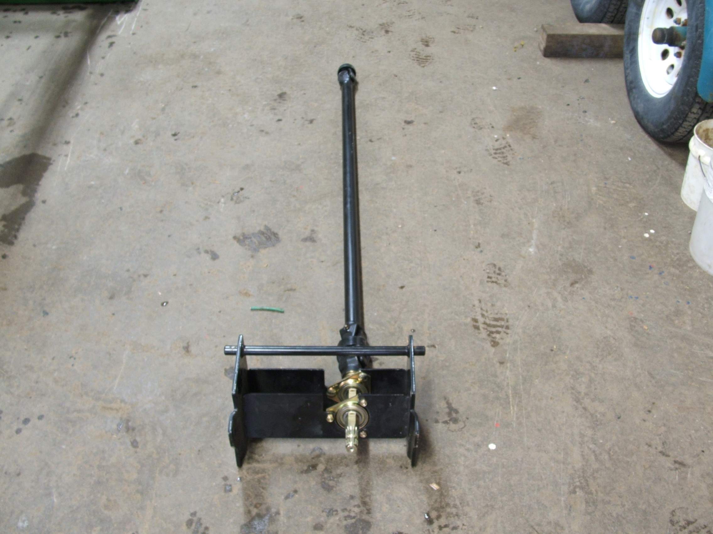

I think I answered my own question...My shaft is 65" and Deere says the length is 59.570." That length would definitely work.
The grill guard only has one position. The brackets are held on by three bolts and one stud each.
   / JD 4110 47 snowblower mid pto shaft length #13
I measure mine just by curiosity. Its a 2305 and my measure are 67'' total and 58'' from u-joint to cv joint, so your shaft is not for a 2305 either.
   / JD 4110 47 snowblower mid pto shaft length #14
Just came in from the shed. Took the shaft out and laid it on the floor--50 and 3/4 inches--everything that is black, or from the end of the shaft (PTO end) to the end of the u joint. Does NOT include the spline on the end of the u joint. ("gold" colored end)
P.S. You will love the blower! Also checked--my guard is just like your pic and it can't move forward
