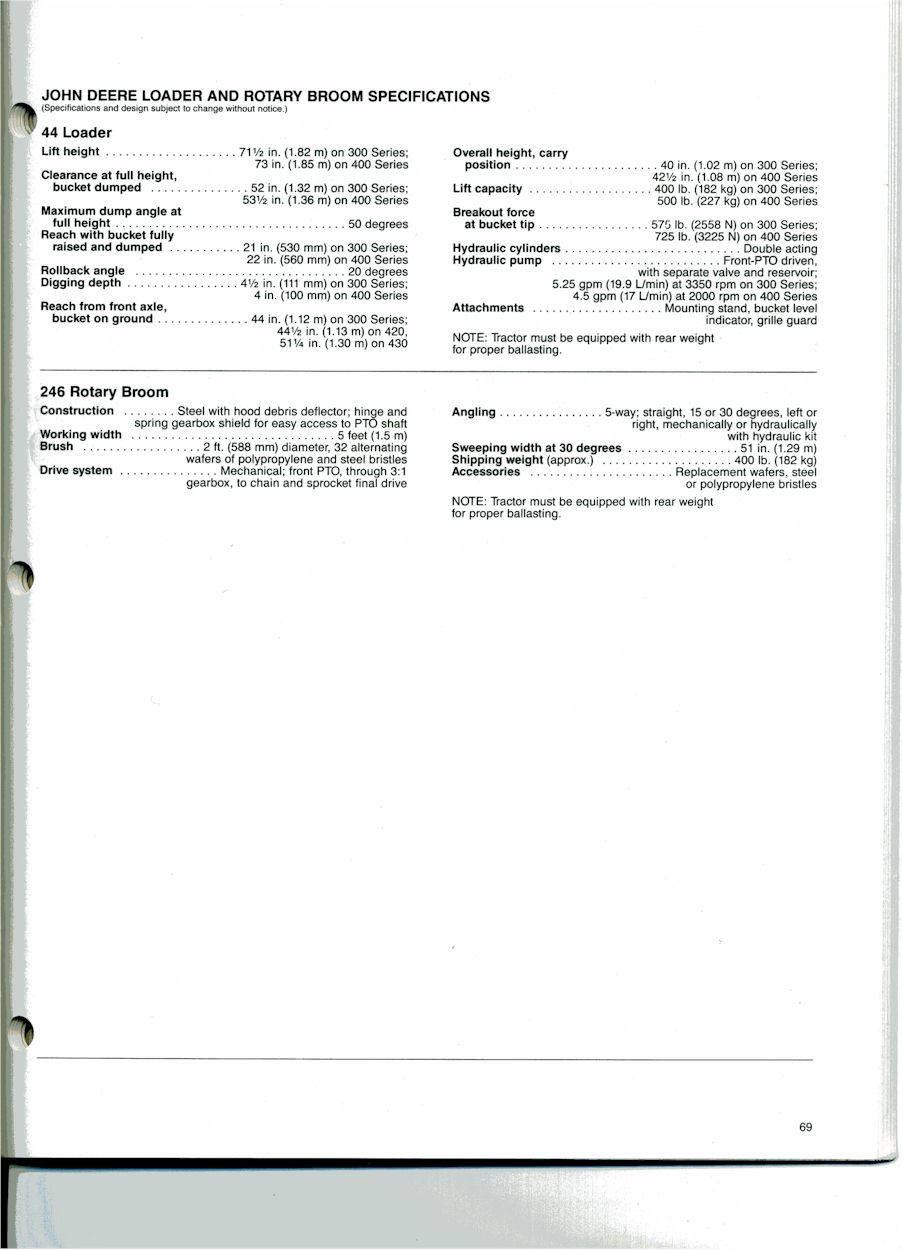

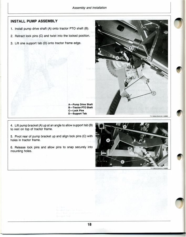

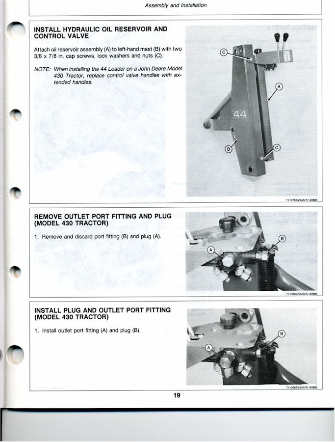

It looks like the 40 loader is trying to just use the hydraulics that are built into the 420, which do not have the capacity to properly operate a loader. I attached a few pics from the 44 loader manual showing the separate PTO operated hydraulic pump and the reservoir with SCV. It is an independent system that does not use the standard hydraulic fittings on the front of the tractor. The 60 inch deck for the 420 weighs 310 pounds. The rated capacity of the 44 loader with the proper hydraulic system is 500 pounds. The system is rated 4.5 gpm at 1200 psi.

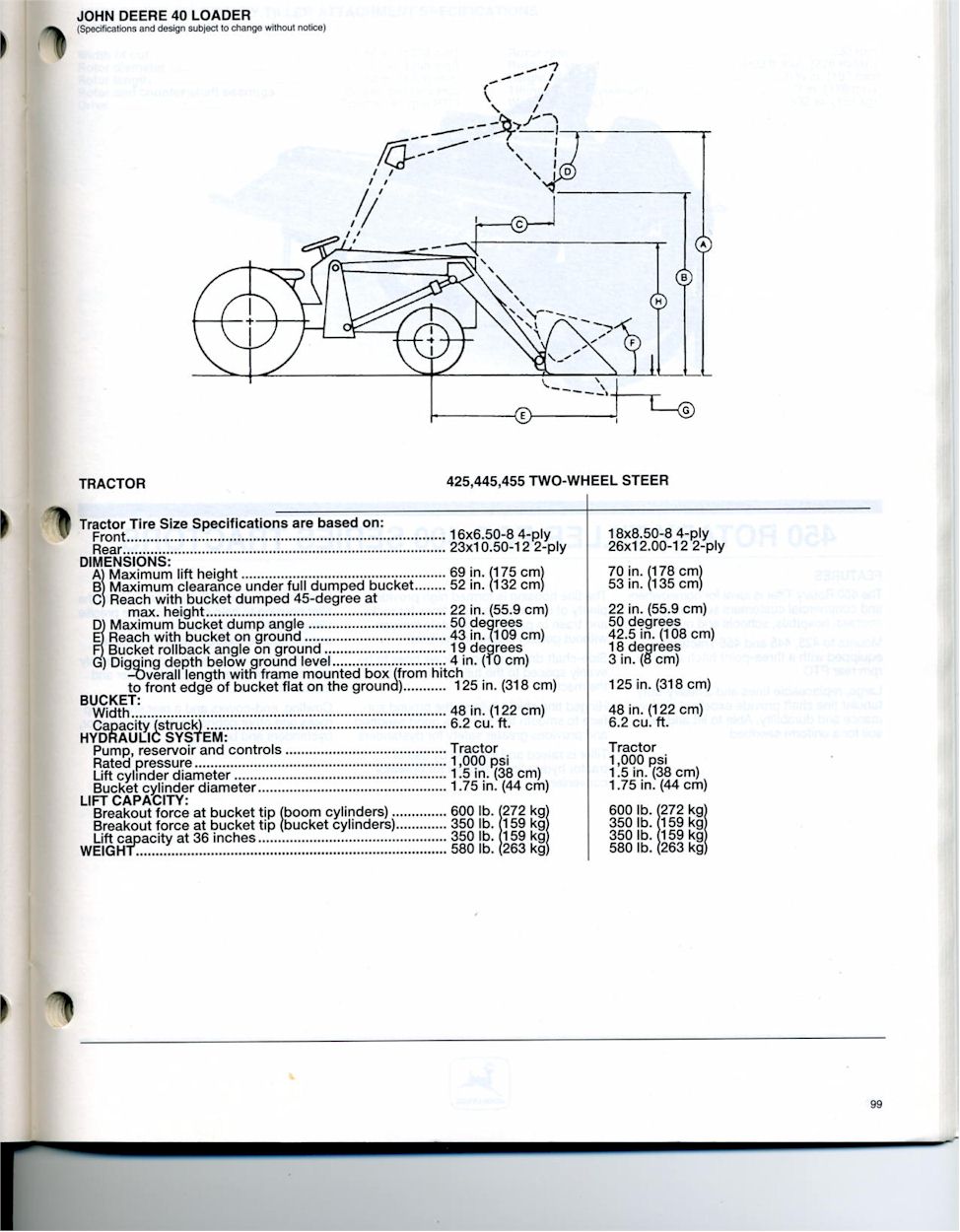

Looked a little more through my reference materials. The 40 loader does use just the tractor hydraulics and has a rated lift capacity of 350 pounds vs 500 pounds for the 44 with separate pump system.
