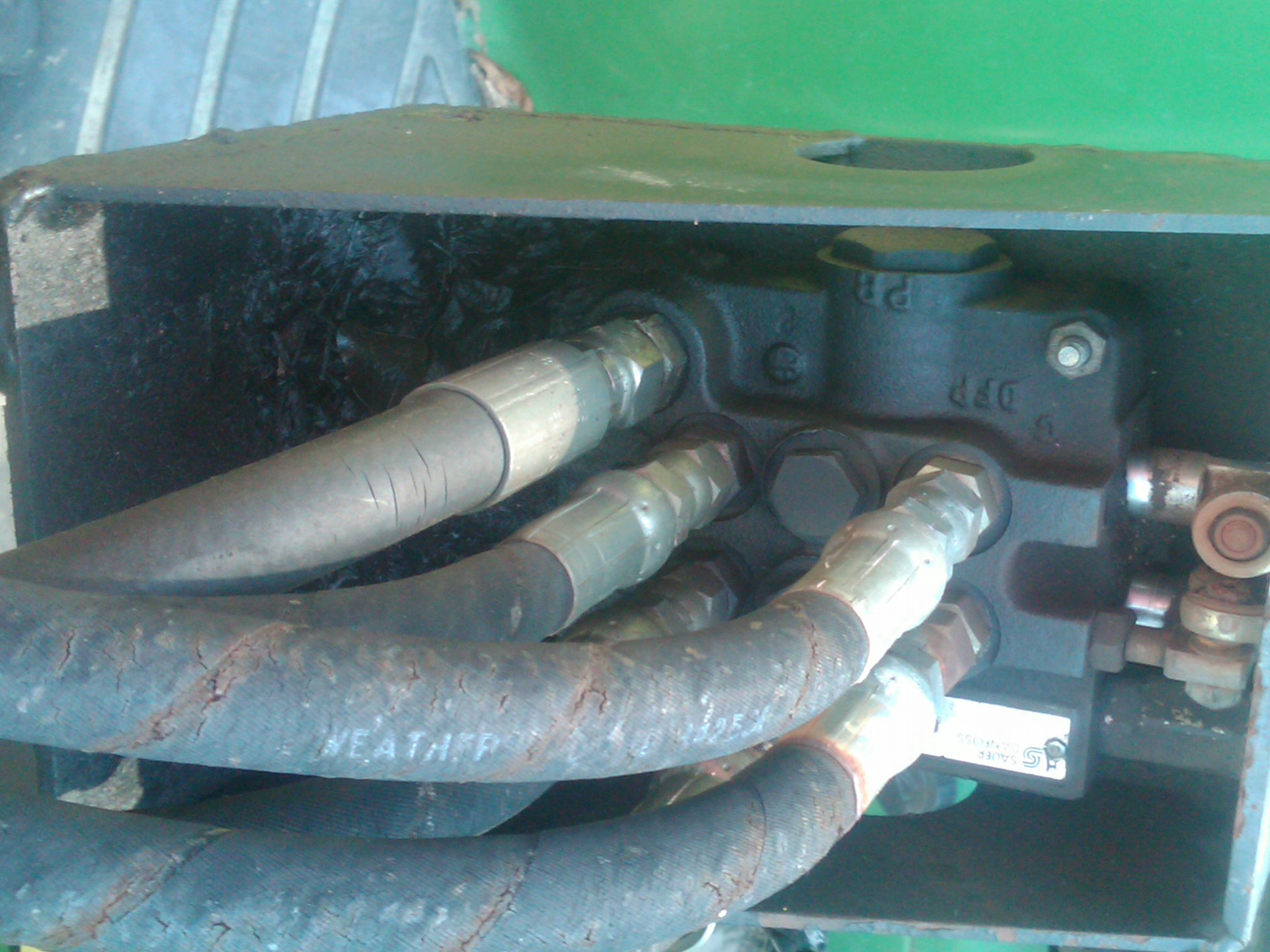

I have a JD 4200 with a loader on the front. I don't have an actual fluid leak but there seems to be an internal leak somewhere. My loader bucket will leak down pretty fast if you don't keep hitting the lever to put it back up. My box blade on the 3 point will also bleed down after shutting down the tractor. Seems to have all kinds of lift power on the bucket it just doesn't stay up on its own. I don't see any fluid leaking out. Is there an easy fix? Any ideas?
Also I need someone to help me pick out an new loader valve because I can't seem to find mechanical parts for the one I have. It is a woods loader but they are no help with the valve.
The bucket goes up and down, forward and back and then if you push all the way down on the leaver it floats the bucket. SO... is this a single or double spool etc...

I called woods and they said that the individual dealers sorced their own valves when they put the loaders on different tractors. It is not the JD valve that mounts under the seat area. It is a generic on that is mounted up on the loader mount.

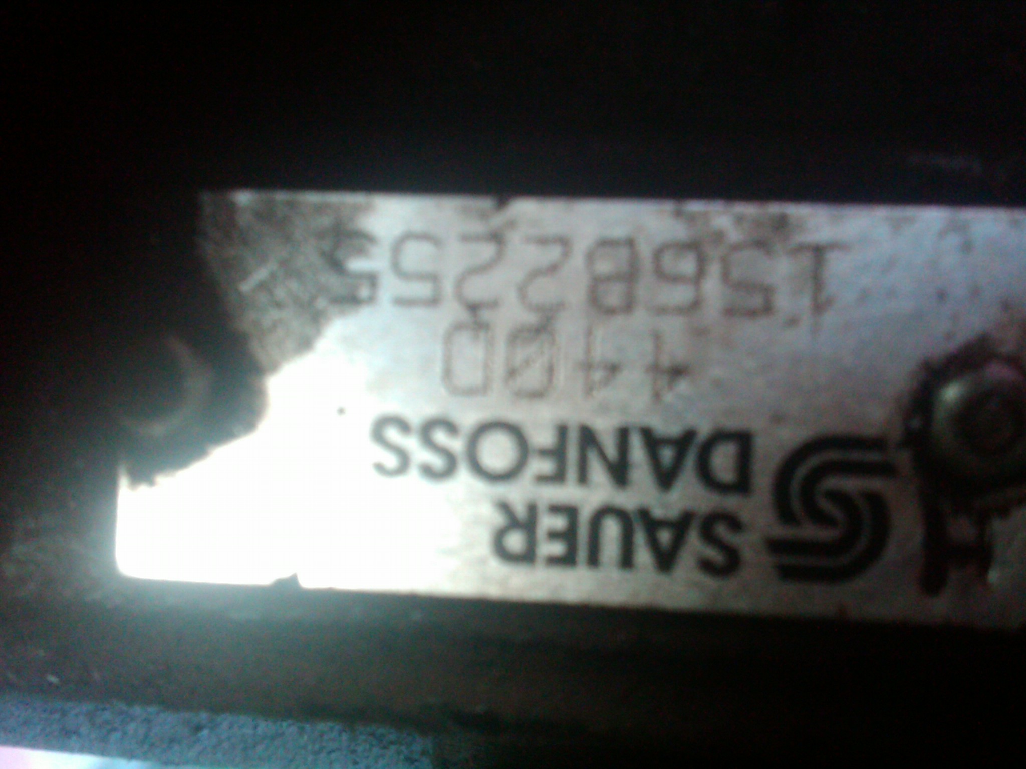

Are there any numbers or name on the valve? Can you post a picture?

The valve is leaking internally, but a certain amount may be OK. Your valve
may or may not have a "load check", which is designed to keep pressure
in the cylinder when the control is moved back to neutral. If it has a
load check, it could be dirty or bad, or if none, then the spool may be
dirty or corroded or worn.

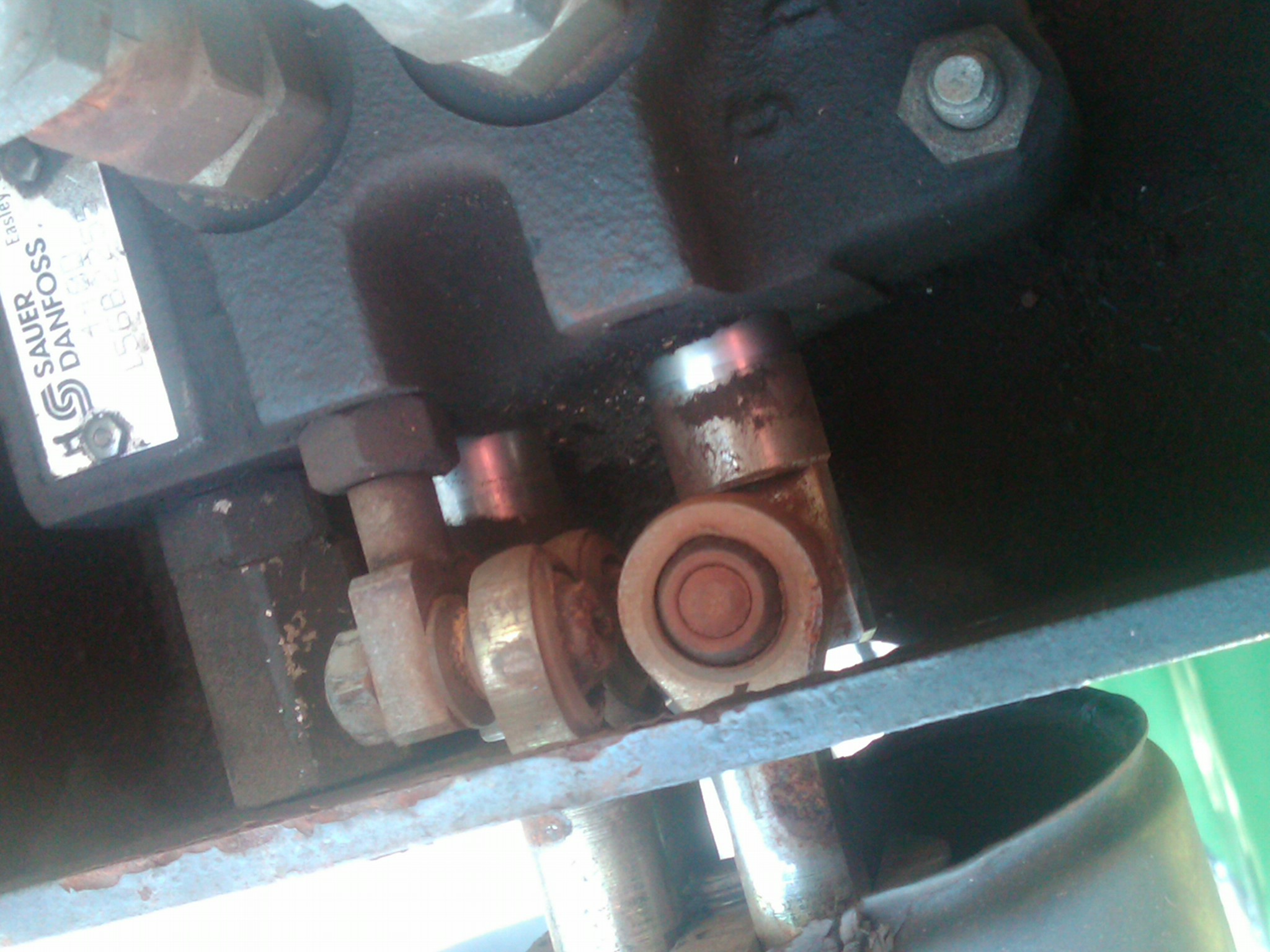

Here are a few pictures of the valve. I need to rod ends at the top (there are 3) that connect the joystick to the valve. Mine are worn and pop out if you move the lever to far.
I guess I also need a rebuilt kit if this is the reason that my bucket leaks down.

Check all of the joystick linkages for wear etc. They might be your problem.:D

Machine kept outside? Those heim joints look nasty! As do the hoses.
I assume the are no QD's (quick disconnects) between the valve and the cylinders?
