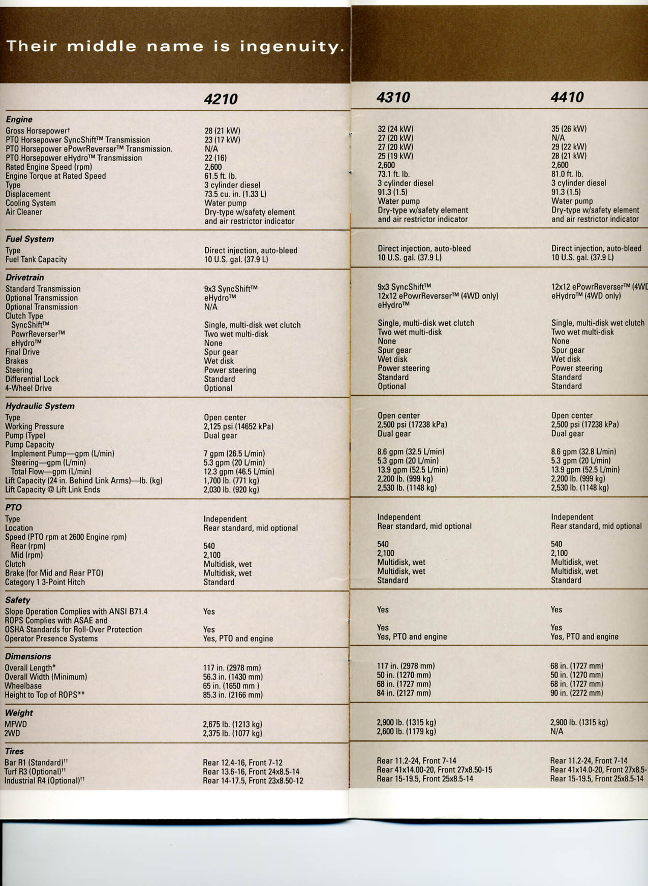

I think you will find that the 4210 is the same "frame" size (as the 4310 and 4410) but the different size tires makes it measure a little shorter in length and height.
The 4210 has smaller pump hyd. pressure, and the 420 FEL has smaller cyl. too. If it has the 430 FEL, may just be slower and lift less.
While the 4210, 4310, and 4410 are all considered mid-size frames, the 4210 wheelbase is three inches shorter. It also weighs 225 pounds less than the others, along with the previously mentioned smaller hydraulic capacity. Other details are attached, although there are errors on this chart I believe the wheelbase and weight to be correct.
I added a data sheet for the 4200 to help sort through the errors. JD has always been terrible about no proofreading on their information.

Thanks JD755
I see I was looking at the 117" length, and not the wheelbase. So you are right that the 4210 is shorter wheelbase. And jdparts has a different frame number for the 4210 than the 4310 and 4410. So there is a difference.
I've also found some gross errors in my 4300 manual. I've found the CD tech manual to be pretty good. So far. :)
