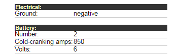

2 6 volt batteries, and the jd 4240 shows on TractorData as a 6v system..
   / JD 4240 Battery maintainer connection placement #6
That would mean the batteries are connected in parallel so you'd want to connect a 6V charger across both batteries connected in parallel too. Since the parallel connection is already made via the tractor wiring you'd only need to connect the charger to one battery and it would charge both.
I read Tractor data info for JD 4240 as 2(two) 850 CCA 6 volt batteries but nothing stating it's 6 volt system
   / JD 4240 Battery maintainer connection placement #9
Its is a 12 volt system.
   / JD 4240 Battery maintainer connection placement #10
Good to find that out.. what Jim found is what I found as well.. a bit misleading but information just the same. Had a PM that suggested there are three models of the 4240 (two that are 12v ), so maybe a voltmeter would help nailing it down by the OP.
