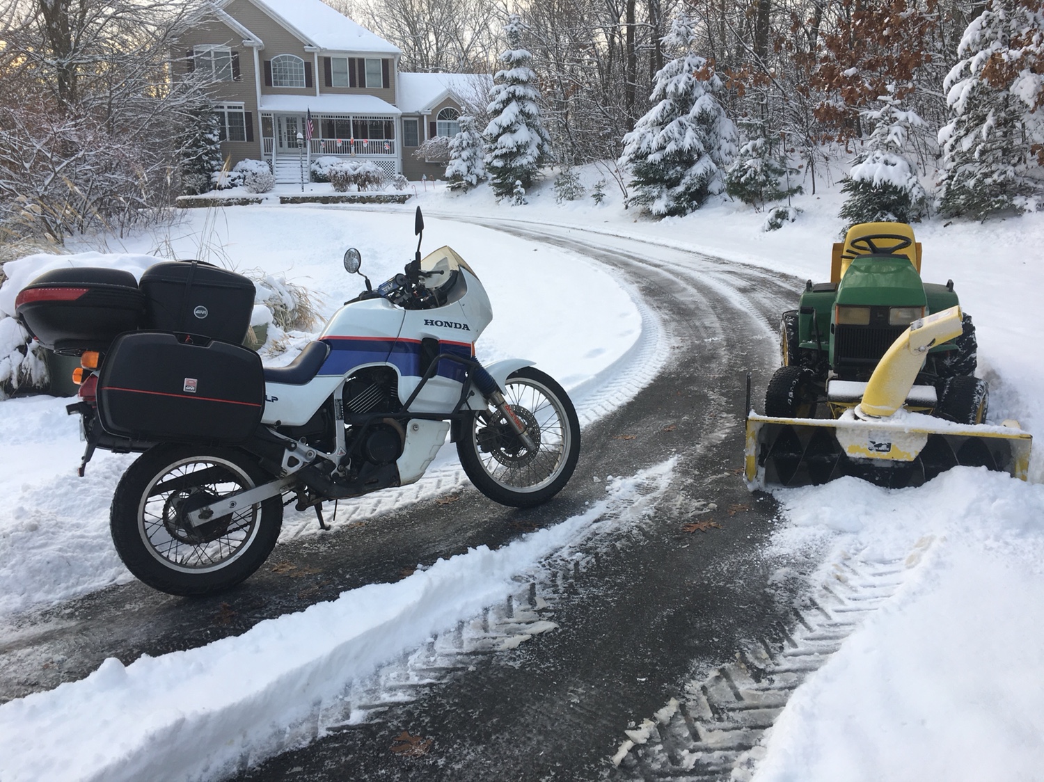

IMG_4678.JPGi warmed up my
Tractor today by snow blowing the recent storm. IMG_4697.JPGthen I changed my oil and oil filter!! I can’t believe how easy it was, that valve makes it so clean and easy. I did make a little mess with the oil filter but it was an easy clean up. Now that I see how easy it is I’ll do it every season. I just did my Ski nautique for only its third oil change since I’ve owned it for 15 years, so this is going to be the new me!
