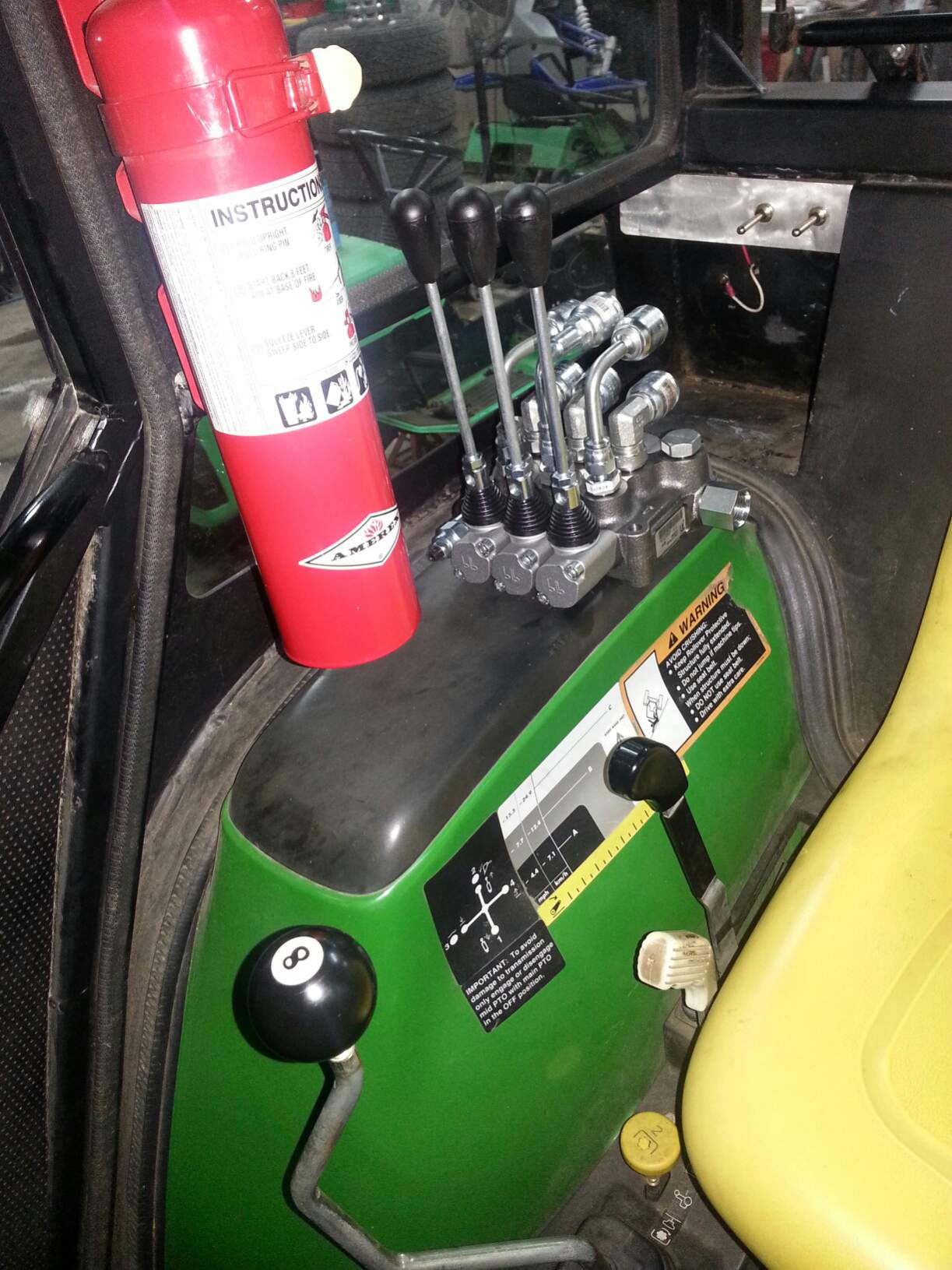

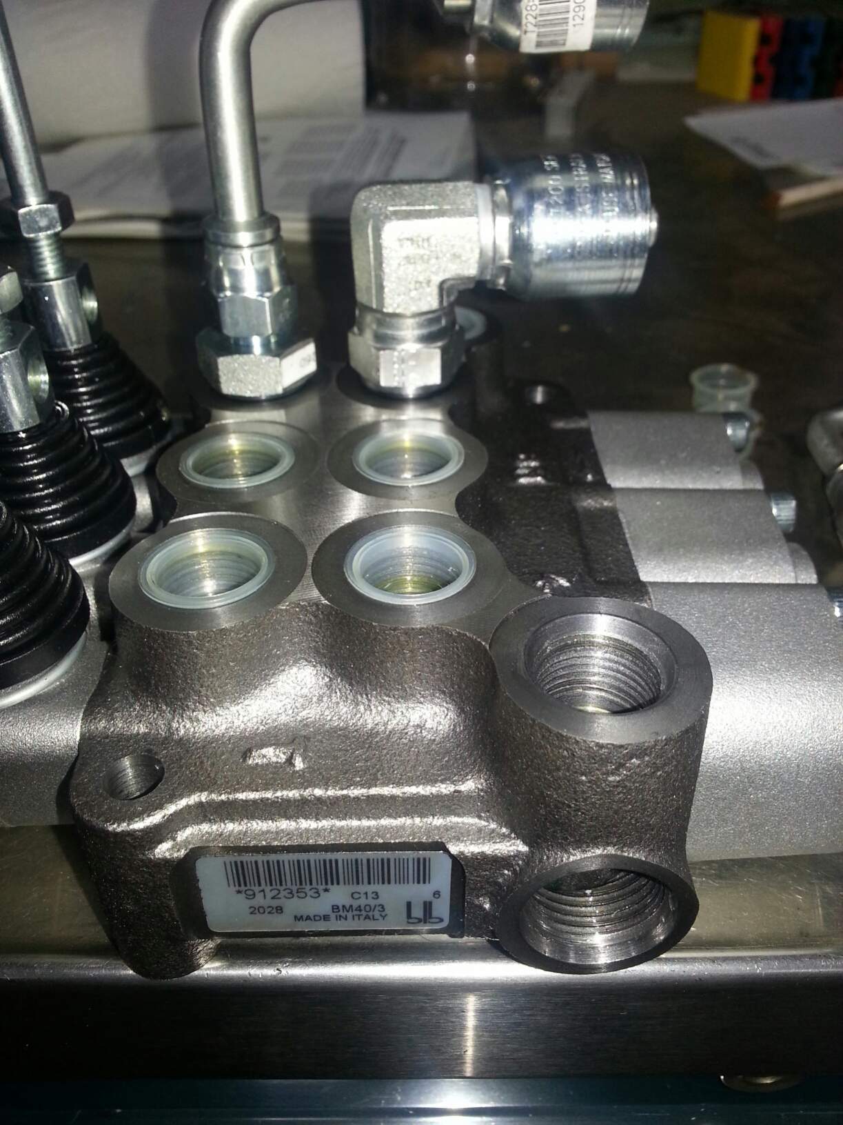

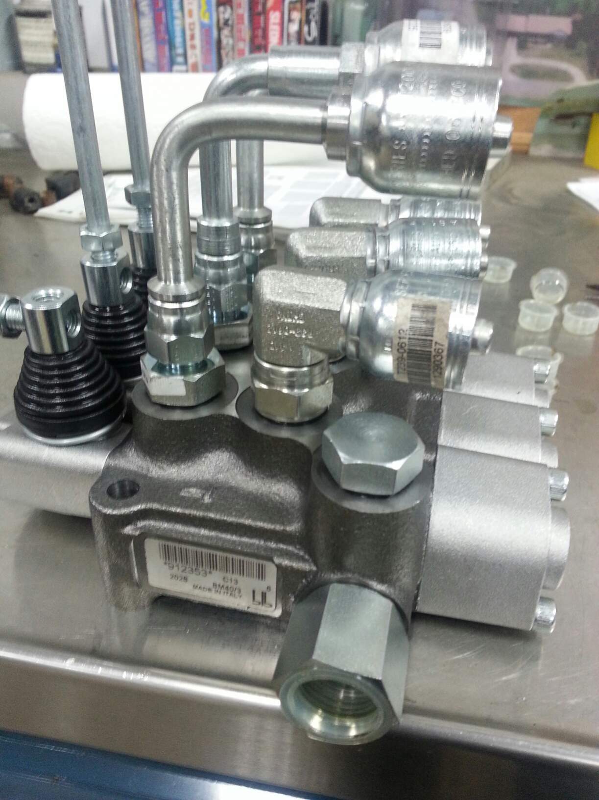

#11
I went to a local hydraulic shop Sat. morning and they hooked me up with poppet style quick connects, all the fittings I needed and made up my lines. I have everything hooked up and no leaks but I am just working on the mounting plate for the actual valves to finish up. I may add 1 45 degree elbow on one line just to make it a little neater but it is all good.:) valves connected 2.jpgquick connects mounted.jpg
