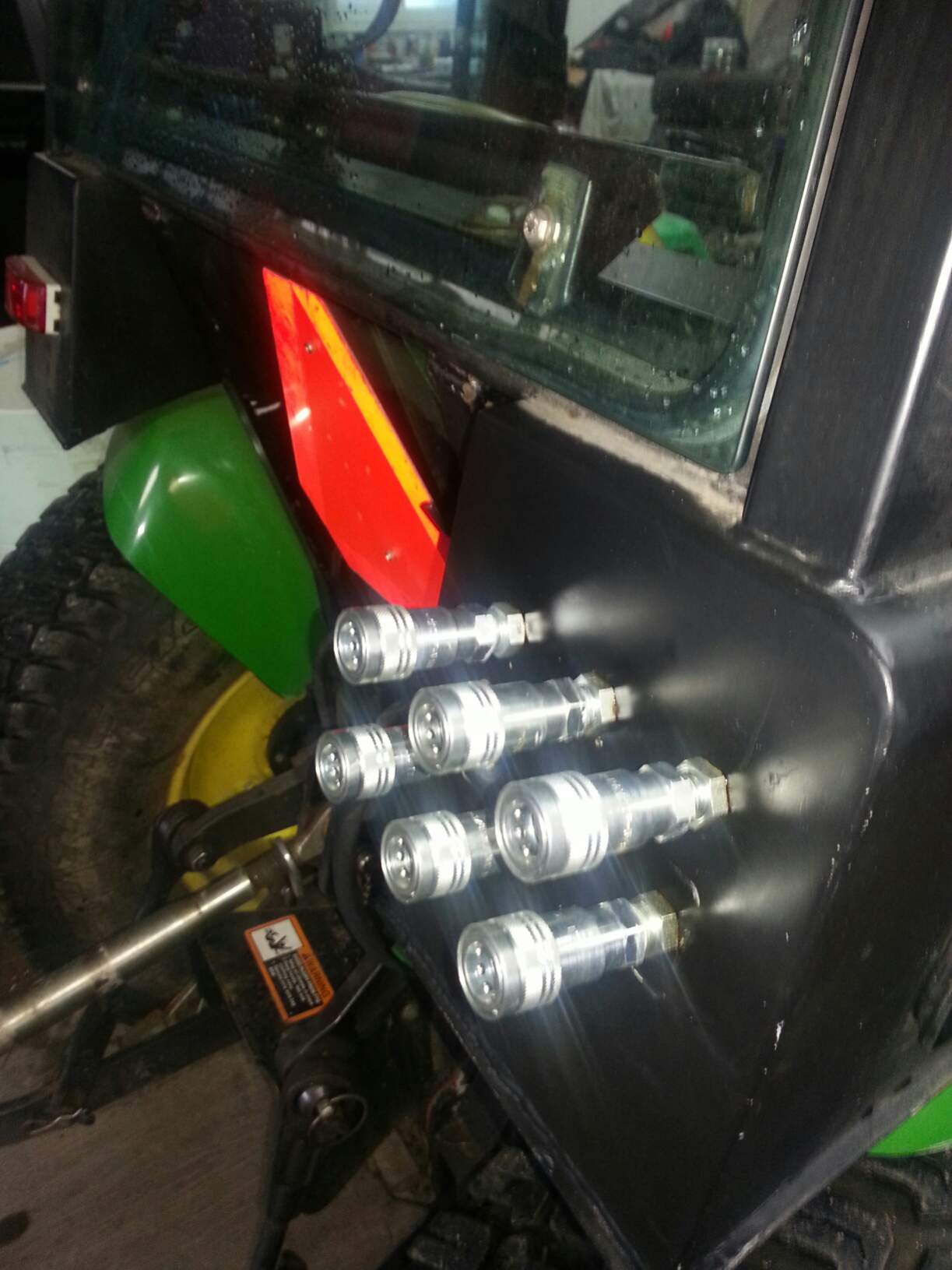

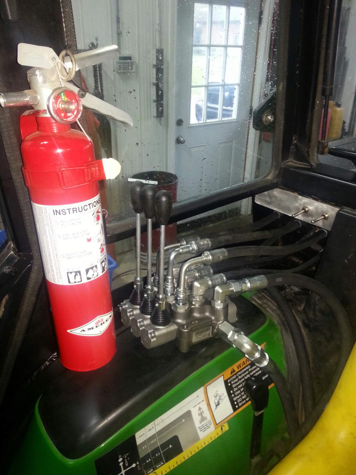

I went to a local hydraulic shop Sat. morning and they hooked me up with poppet style quick connects, all the fittings I needed and made up my lines. I have everything hooked up and no leaks but I am just working on the mounting plate for the actual valves to finish up. I may add 1 45 degree elbow on one line just to make it a little neater but it is all good.:) valves connected 2.jpgquick connects mounted.jpg

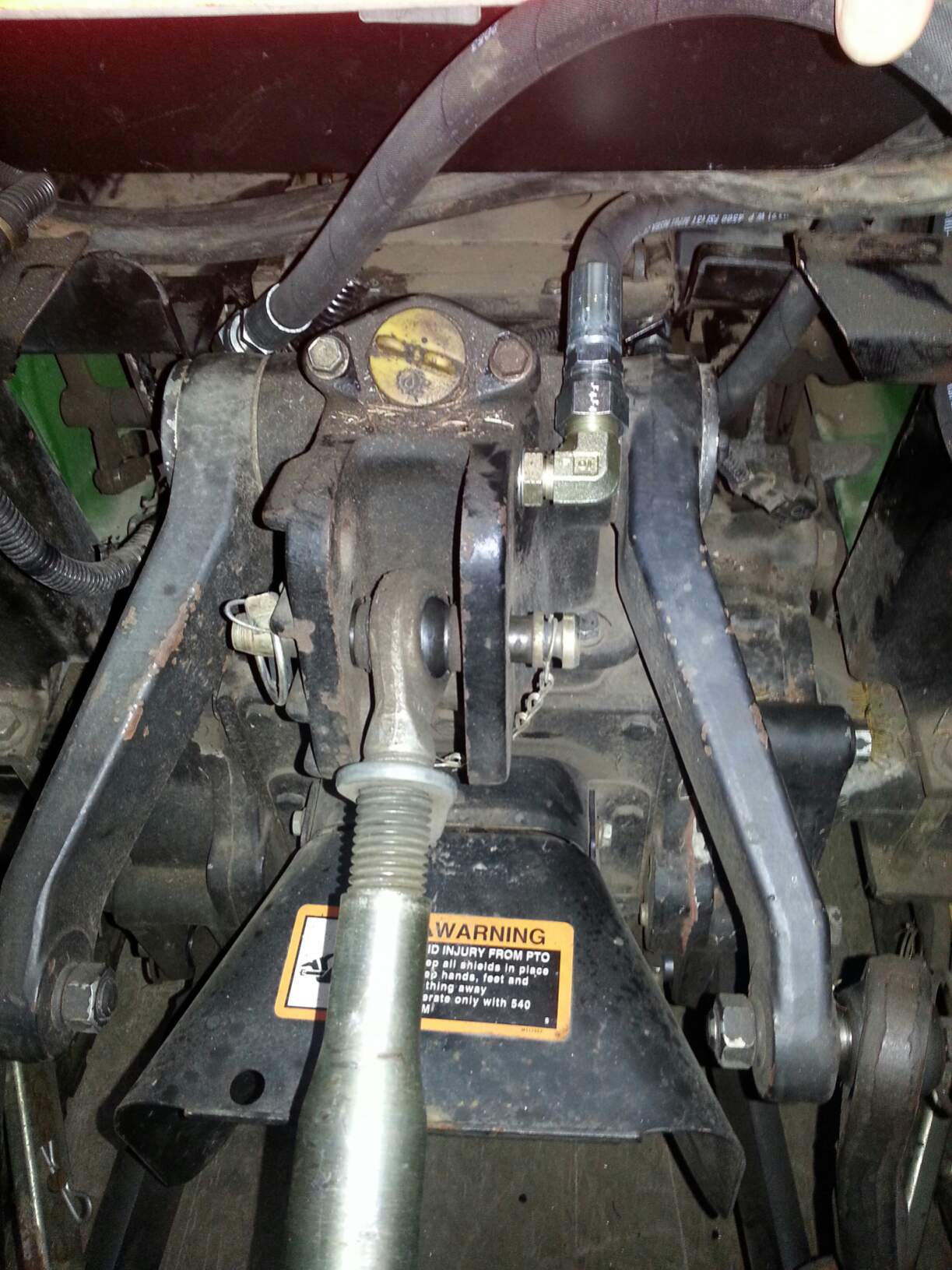

Just a pic of where the tank line goes on the 4300. There is a nice plug in the top of the tank near the 3 point toplink mount. The John deere power beyond uses this and makes a easy tank connection with a 90 degree elbow that just leaves room for the 3 point lift arm to clear. tank line.jpg

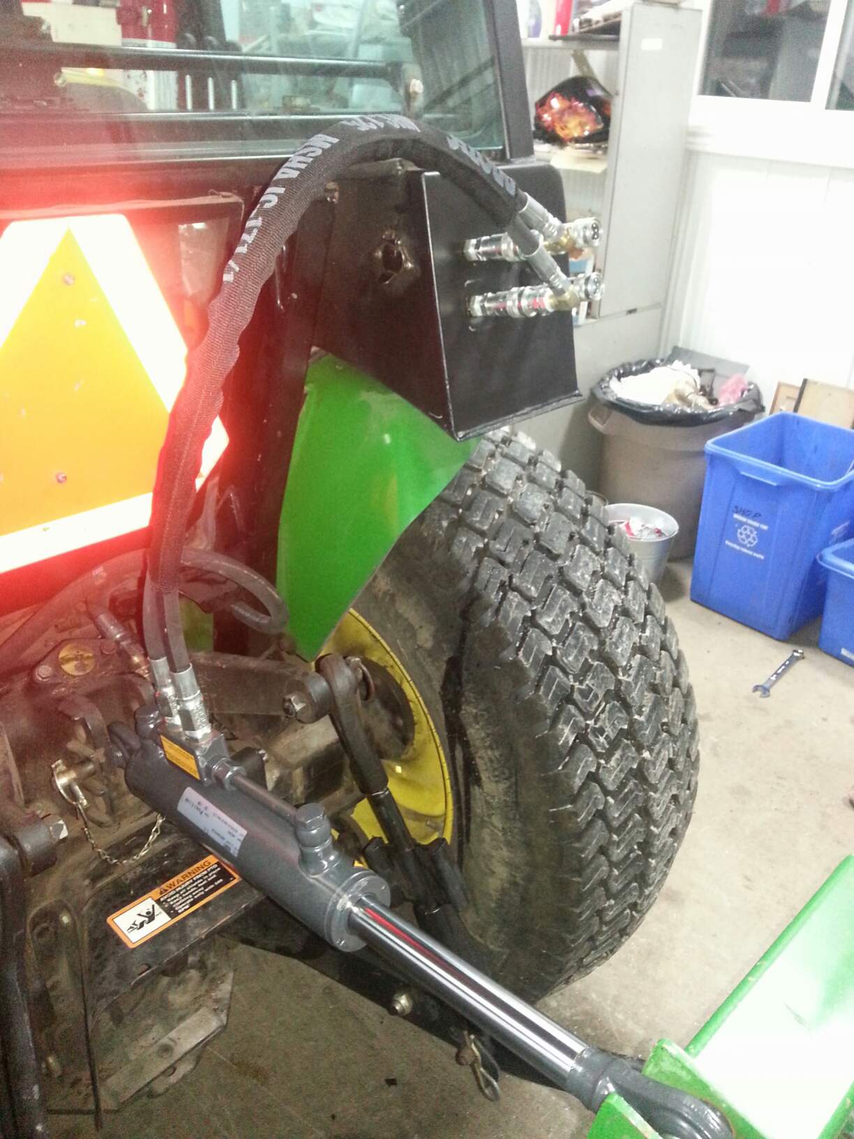

I picked up my hydraulic toplink got a couple of lines made up and installed in a sleeve.hydro toplink.jpg
