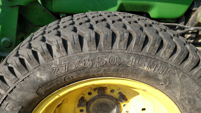

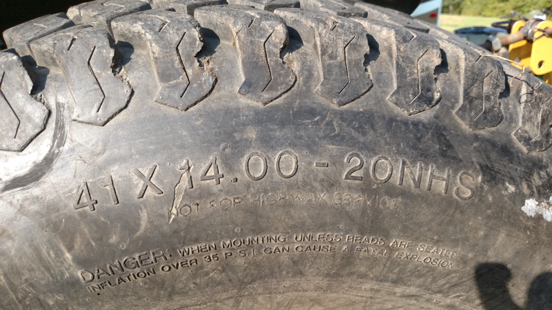

Just to keep you guys updated, I checked the tire sizes this weekend and they are the correct matching sizes for my tractor. So, the mystery still continues. I am going to bet it was whatever got ground up in the tranny and damaged the sump screen. I gave it another good workout grappling brush from an area I was clearing and it ran without any issues.
