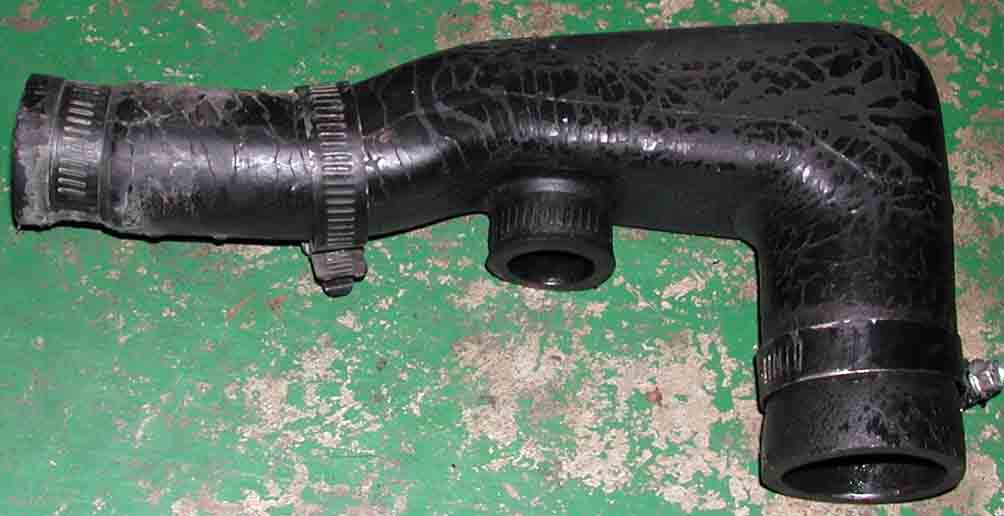

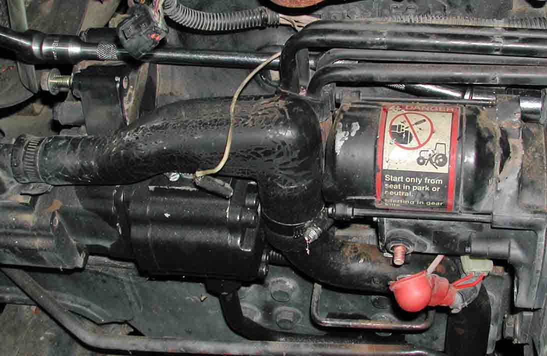

Before I filled the gearbox up with new tractor-hydraulic fluid, I cleaned the
inlet screen. To remove all the microscopic particles, I first used gasoline,
then I washed it carefully in a strong detergent, then I used an air gun to
dry it.
To get at the inlet screen, you have to partially remove the large steel
pump inlet tube below the tractor. I used this opportunity to closely
inspect the hyd pump inlet manifold. It is made of a soft plastic material,
and if it leaks, you will suck air into your hyd fluid. Bad.
Records show that this part has been replaced once already. I notice that
they arrive painted, perhaps to give them some protection from UV and
ozone.

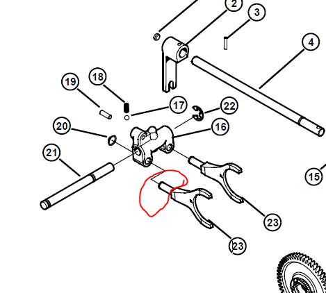

Hopefully you're still around helping folks on this forum. I bought a JD 4200 that is stuck in A range, B and C range only gives me Neutral...
following these write-ups, I popped the PTO cover and took off the inlet filter screen underneath the tractor. There were very few shavings on the screen, and the bottom of the tranny housing revealed a broken shift fork as expected. There was no other debris in the housing. I expected to find brake parts and maybe pto clutch parts as both sides of the brakes stick and the pto clutch seems to be engage harshly.
My question is, do I have to remove the hydraulic lines on the top of the rockshaft housing to remove the housing, or can some of them stay on? TIA!
You are going to have to remove the Power Beyond tube, but you do not need to take all the hoses off the AUX valve.
With the problems you have, I suspect you will need to change the plain bearing inserts inside the rockshaft pivots, too. When I bought these parts, they were available and reasonably priced from JD.
Good Luck.

Ok, Thanks for the heads up. I need to look at the repair manual to find out what these bearings are, where they are, and where the AUX valve is so I can identify what you advised. It needs to warm a bit before I get back at the tractor, at or below 0 isn't conducive to tractor repair in an unheated shop..
Do you know if they changed the shift forks (made them stronger) mine is a 1999.
Anywhere to buy used shift forks?
The forks may be repairable. You may want to contact a skilled TIG weldor/machinist.
On eBay right now is a listing in OH with most of the gearbox for sale. You might ask them to list the forks separately, as they have offered.
I think I saw the ebay listing that had all the gears and goodies, for just shy of $2k if it's the same one. Good idea asking them to separate.
I did think about welding - not something I could do, but maybe someone more experienced could....Appreciate the help!

If you look at my post #11, you can see the infamous range shift rod. If you look down inside the gearbox once you have removed the cover, you can see how the shifter fork is connected with a roll pin.
You can then use a long drift to pound out the roll pin. The shaft then slides out of the fork. If the shaft is broken at the O-ring groove, you have to grab onto it from the inside of the gearbox.

And for me, one of the shift forks themselves is broken and not the shift rod. I found the piece of the fork in the bottom of the housing when I took the pto cover off. it looks like it broke right where the rod portion of the fork would slide into the shifter? Will I be able to get to the forks for repair by removing the rockshaft cover alone?
You will need to get fork support body (16) off of shaft (21). I do not recall how that shaft can be slid out the side of the gearbox. I would have to look in the manual to see how. If you can, then no tractor splitting, even if you have to remove wheel, fender, and other stuff in the way.
If you can access that shaft from the outside, then remove the E-clip (22) and the detent (17) to free it up.
At least the shifter fork looks repairable. It also looks like a good candidate for 3-D scanning and printing with a durable material. I hear there are metals than can be 3D printed these days.
