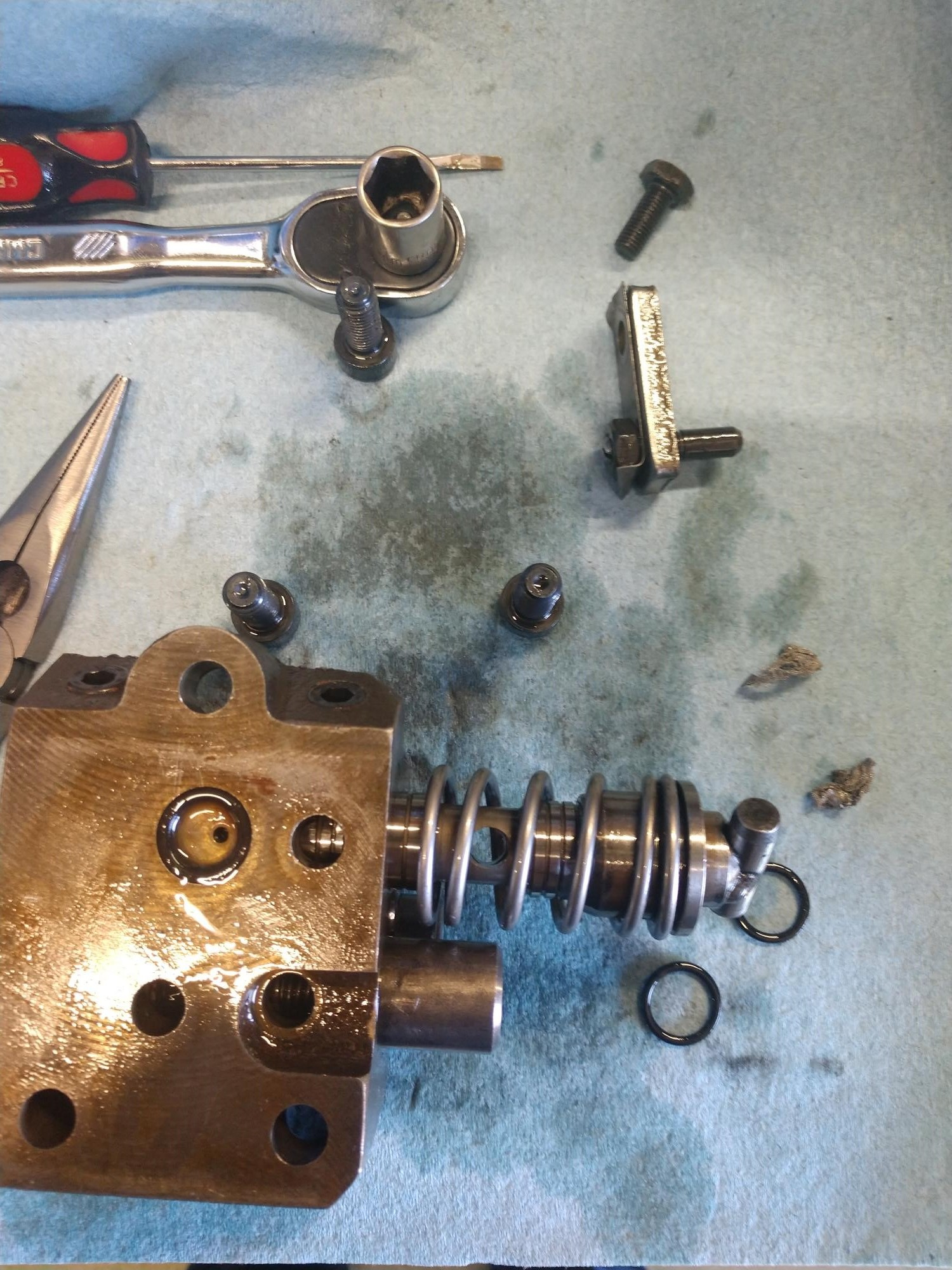

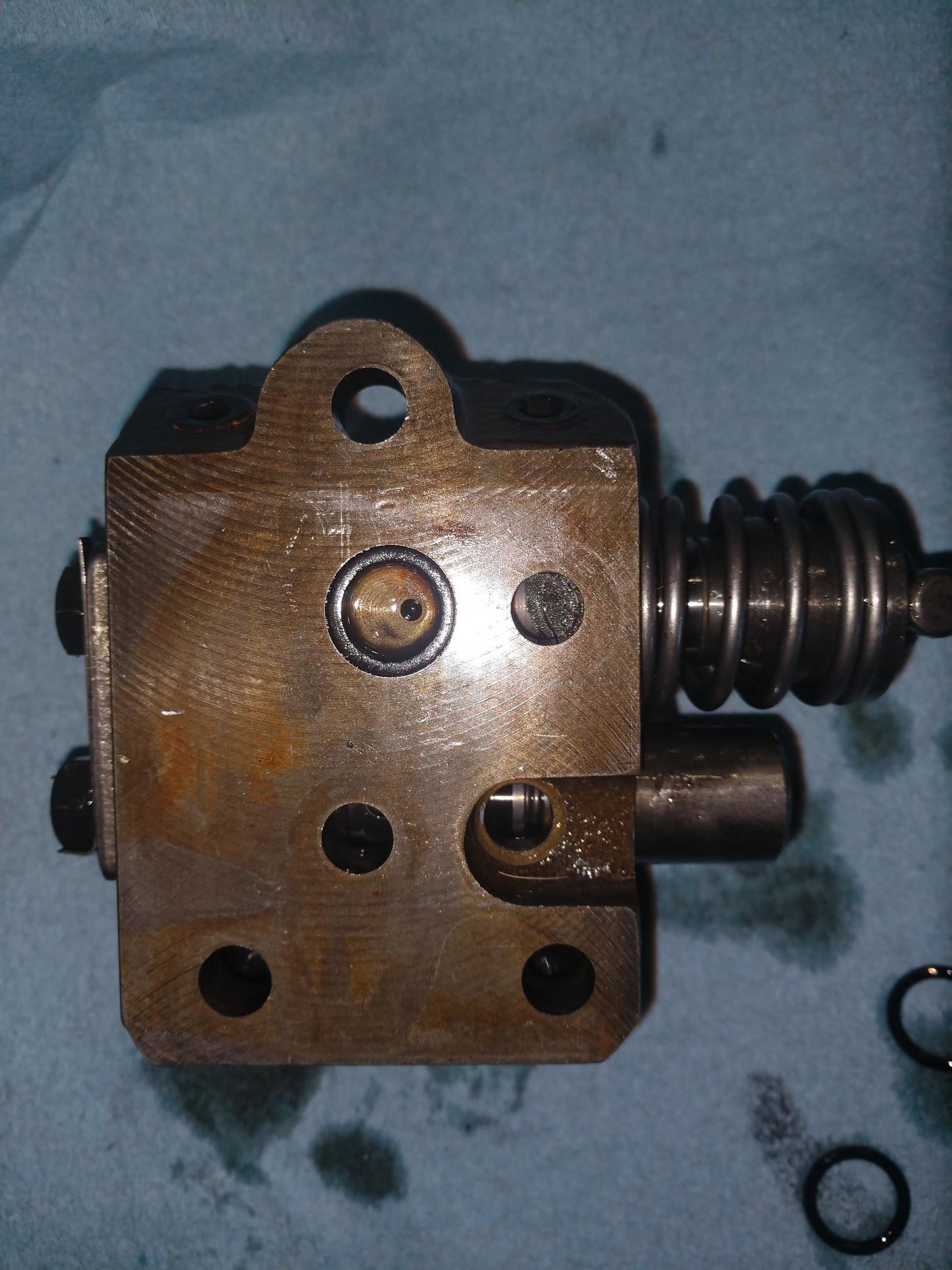

So it was operation day today.

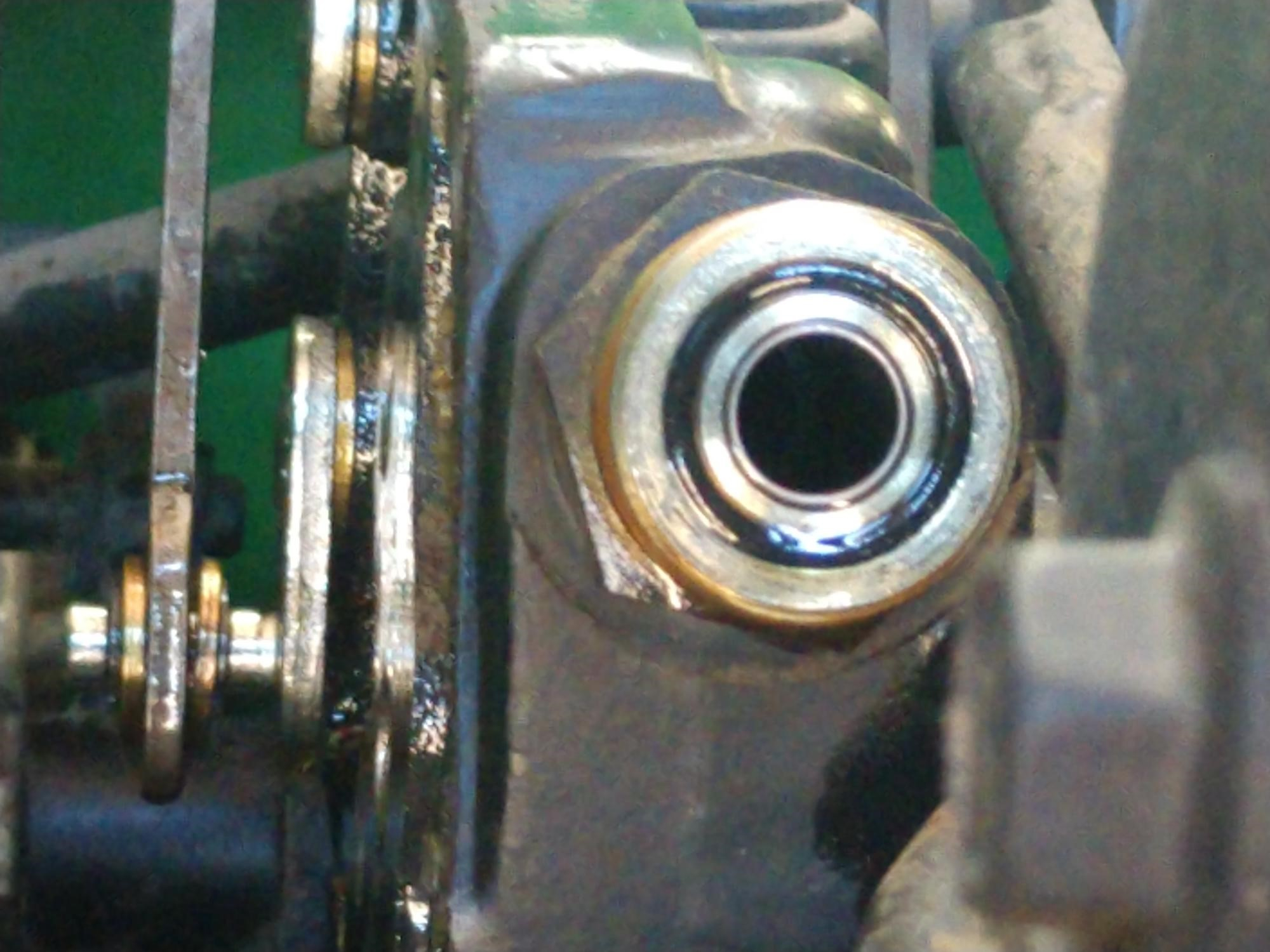

First I pulled the line feeding the Rockshaft.
Note: missing mess filter.

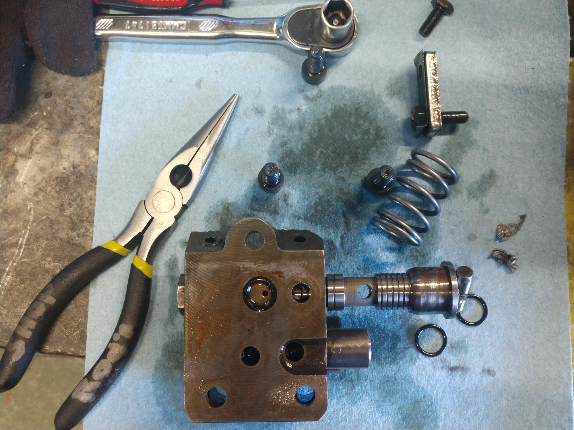

Then I removed the Rockshaft Control valve. To my own question earlier, on the socket head screws. 6mm hex
Once removed I looked on the back side of the valve and lookie there. My mesh filter was in the valve. first hole to the left of the piston/spring.
Once i tried to remove it and it ripping I decided I would be better off replacing the valve. Given that I did a bit of tear down to get a look at the internals of the valve.
