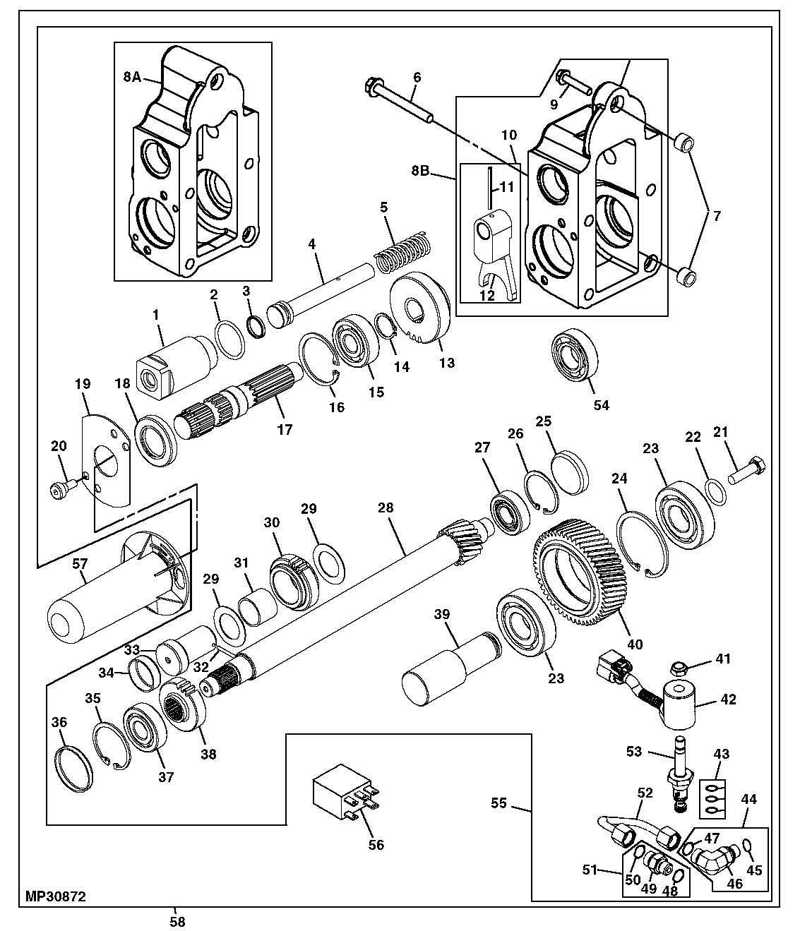

I have a JD 4310 compact utility tractor. When mowing with the belly mower, the PTO disengages. I can usually get about 30-45 minutes out of it, then it seems to warm up and the PTO shuts off. If I wait for 10 minutes, I might get 5 more minutes of mowing. Then the PTO stops turning on altogether. The tractor motor works fine- no overheating or lights. My guess is some sort of electronic component is heating up and turning off the electronic PTO. Thoughts?
Thanks Tim
   / JD 4310 mid-PTO shuts off during use? #2
Welcome to TBN,
The mid (and rear) PTO is activated by a solenoid valve (#42 and 53 below), you can can check the connections to it, and also the resistance of the coil. Might be time to get a tech manual for your machine if your going to do your own wrenching, at $70ish they are worth their weight in gold.

Thanks. I saw the three solenoids sitting side by side on the underside of the right fender/housing area, and wondered if one of them may be the culprit. I will try putting a test light on each one while the PTO is operating (no mower), and then again when it stops. Maybe I can isolate the bad one that way.
Thanks again.
   / JD 4310 mid-PTO shuts off during use? #5
It looks like In upper right of drawing BOX 11, it's the third solenoid key 13 part number YZ81353
