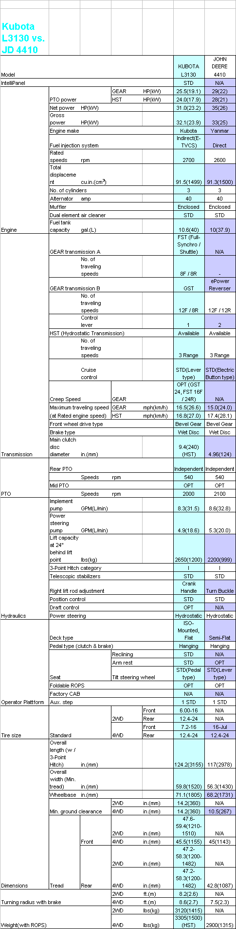

Can anybody tell me the size difference between the Deere 4400 and the Kubota L3130? A neighbor has the JD 4400 and I'm curious as to its size relative to the Kubota. I can't find any specs on the 4400 on the Deere website. As usual thank you in advance.

Thanks to everyone for their reply. What I was trying to determine was the size of my neighbor's JD 4400 and what a L3130 would like next to it. I believe the length, width, height, wb, etc. would be pretty close. Again thanks to all.

Hi Stan,
Actually the Kubota is slightly larger frame wise than the JD by a few inches width and overall length...
If you were happy with the JD size on your property... for only a few dollars difference in price... I'd get the L3130 over the B series..., especially for the number of bells and whistles you will get extra... and this will help tremendously down the road come resale/trade time...

I just double checked the "physical" dimensions on the JD 4400 and the JD 4410... they are the same...
