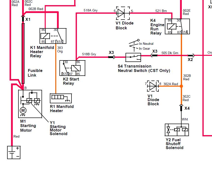

Beenthere and K7LN,
Does the tech manual have physical descriptions of the various relay and switches? And does it describe how to pull the instrument panel to get at them? At this point, I'm limited to physically tracing the wiring to find and test the various relay and switches.
Also, the schematics that you all provided does seem to match what I'm seeing. For example, the ignition switch has three red, one green and one white wire. The schematic doesn't show the white wire.
I really appreciate everyone's help...kept me from pulling the starter and taking it in.

I don't have any manual. I'm just going by what was posted earlier. Rather than test the relay, just swap it out with another one or use the spares in K10 & K11 if you have them. I think they will all be the same.
You might want to try and place a jumper from F5 straight to the solenoid. If things work then, you've narrowed the problem area down to the switches and connections in that part of the circuit. You can also pull K2 and place a jumper between pins 30 & 87. That will take K2 and the rest of the circuit out of the picture.
As to the white wire, it's not shown because it belongs to an unrelated circuit.
Not to try to confuse things, but a bad ground on relay K2 would also stop it from cranking.

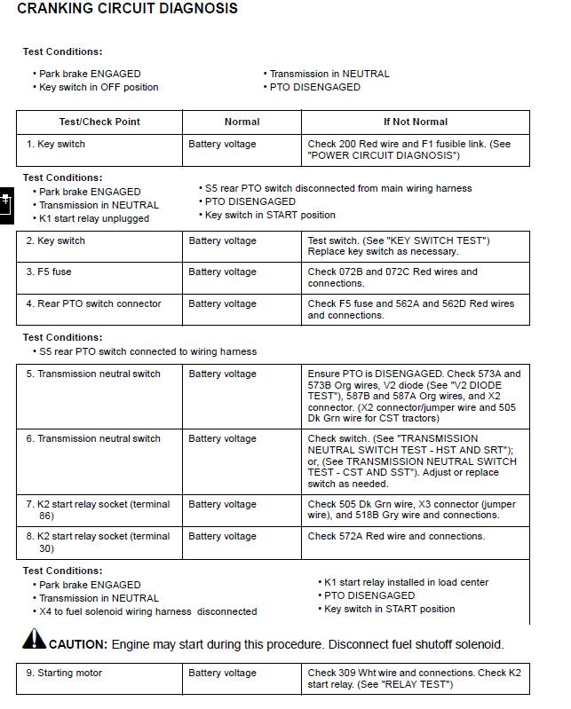

Try making a jumper wire from pin 5 on the start switch to pin 86 on K2 start relay. This will bypass the safety switches and test the fuse when trying to start it. If it starts, the problem is in one of the safety switches...if not, it's the fuse.
Scratch that...that would test fuse F1.
I'm sure someone can tell you where those parts are.
