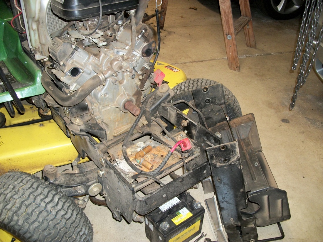

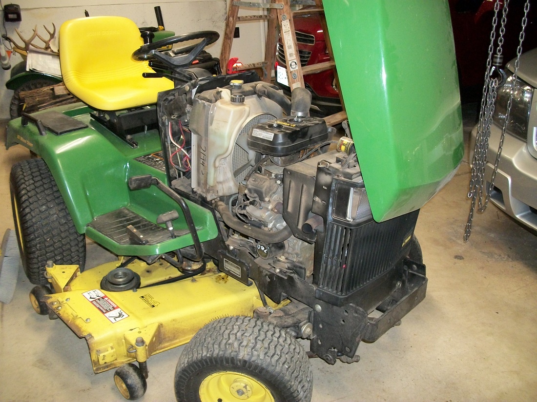

Started the tear down to get the 425 FD620D engine ready to pull.

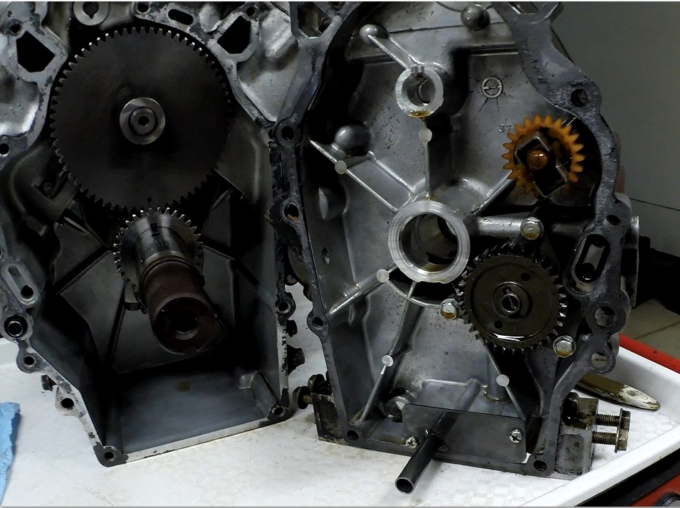

Have been poking along with this 425 engine FD620D, and today pulled the crankcase cover off.
Plan now is to just replace the plastic gear camshaft, the water pump, and the governor..
At an impasse now with trying to get the two Phillips screws out holding that oil screen in place in the bottom of the crankcase. For sure don't want to break one or both off and have to deal with that..
Before I pull out the camshaft, the plan is to hoist the engine upside down so the push rods and tappets stay in place. Hope that works as simple as implied. Any thoughts otherwise would be appreciated.
Have the engine sitting on my tool cabinet and found a plastic tray that just fits on top to allow cleaning the engine off before removal of parts. So far, the words of wisdom that the hardest part is removing the engine from the tractor holds true. :)
In the photo you posted, that sure doesn't look like a plastic cam gear.
I will have to assume that you have removed the rocker arms to take any pressure of of the springs. Then your idea should work.
Richard

Richard
I owe you big time... I just went out to the engine.. and stuck a magnet to that gear.. WHOA WHOA WHOA.. it is steel.
I've no history on this tractor prior to the 600 hours it had on it when I bought it. Given the serial number dating it to the plastic cams, and the low hours.. just presumed it still had plastic. Had I suspected plastic or steel when I took the water pump off, I had the opportunity then to put the magnet to the teeth before removing the crankcase cover but it never crossed my mind.
Now, the plan to button this thing up and move forward has taken a whole new direction... many thanks to you Richard.
Will keep you all informed but without the process of changing out the camshaft.. and I was kinda looking forward to doing it too.
bt
