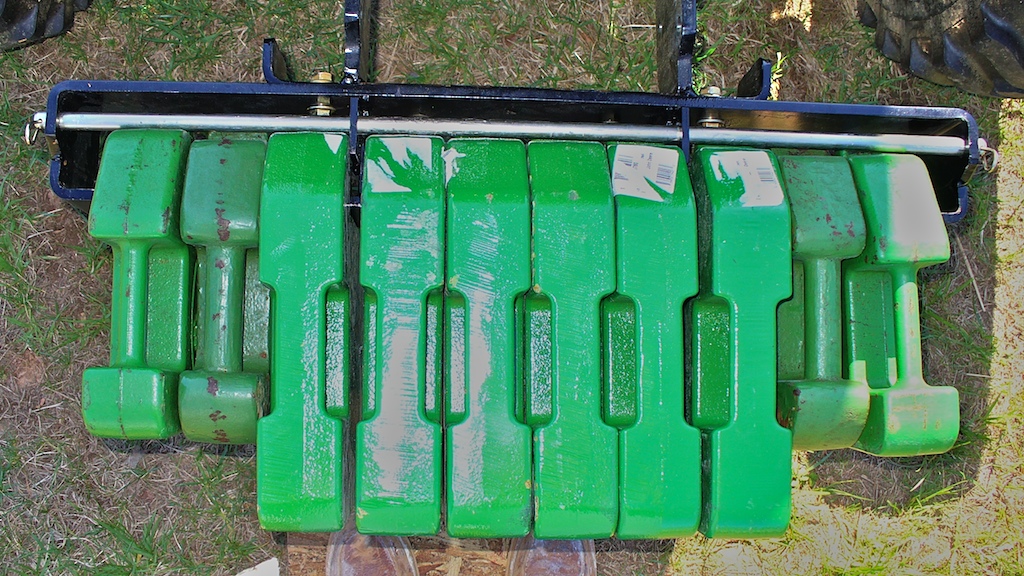

Heard back from my Deere dealer. The weights are aftermarket, not "real JD". He noted that the mounting flange and lip were not as precise as the JD weights. This explains the approximate $1/# cost. So he's getting a "real JD" weight, and we'll see if that looks better and then look at the price.
This also explains why the 42# weights I have look different. Two are real JD, four are aftermarket. The JD are a better fit on both brackets. Casting is not modern rocket science, I have no idea why aftermarket guys can't do better.
I'm leaning more and more toward returning the weight bracket, and making the 6 70# aftermarket weights work on the existing bracket. If Steve says it works, that's good enough for me. Even if the "real JD" weights are OK, they will probably cost more and there is still the problem that the bar can flex enough that they weights could come off in a bumpy ride or roll over. JD needs to put a mid point flange on that bracket like they did years ago for the smaller bracket with lighter weights for my 318. Maybee lost sales will make them listen ;).
Other lesson here: Green does not mean JD, look closely.. :eek:
Pete

Just for fun, I tried mowing with no weights. Not much fun :mad:. Anything other than level ground and a turn more than 30 degrees doesn't work. So I'm thinking about 6 70# weights (420#s) and how that's about 9% of the weight of the tractor, and then thinking I might want more, but Steve said, and then thinking...
Ok, insert all the overthinking here --> [ ] and reduce the size of this post considerably.
So I took the bracket to a welding/metal fab shop I used years ago when I needed a special holding jig for a chassis for my milling machine, and had them add two plates with a holes so that the bracket holder had a good chance of working. They did a great job and even painted it, 1 day turn, $40.
The Deere weights came in at the dealer, and I went to look at them. They are correctly shaped, unlike the aftermarket ones. Note that the aftermarket ones in the 42# and the big honking weights (don't know what they are for the 6000 series and up) are OK, but the 70# ones are a bad mold. So I decide I want the 6 70# Deere weights. I bring the modified bracket and show it to my salesman at the dealer.
He's feeling bad for all the grief I'm going through. He said that's only the 2nd weight bracket the've ever sold, and others have just "made do" with the aftermarkets. As his way of making up for this confusion and my time, when the paperwork clears it's an even swap :dance1:.
This is why I like my dealer and salesman, this is why I'm always civil when things happen (and things always happen). We even figure out why I didn't get the word on the aftermarket, and everyone in sales (both tractors and parts) now has the word at the dealership. I've sent him the picture of my modified bracket, he'll forward it to Deere central. Problems are solved by focusing on them, and then when the problem is solved it's easer to go back to the people and figure out what happened and fix all that people stuff.
But to heck with all that, let's look at the pix:

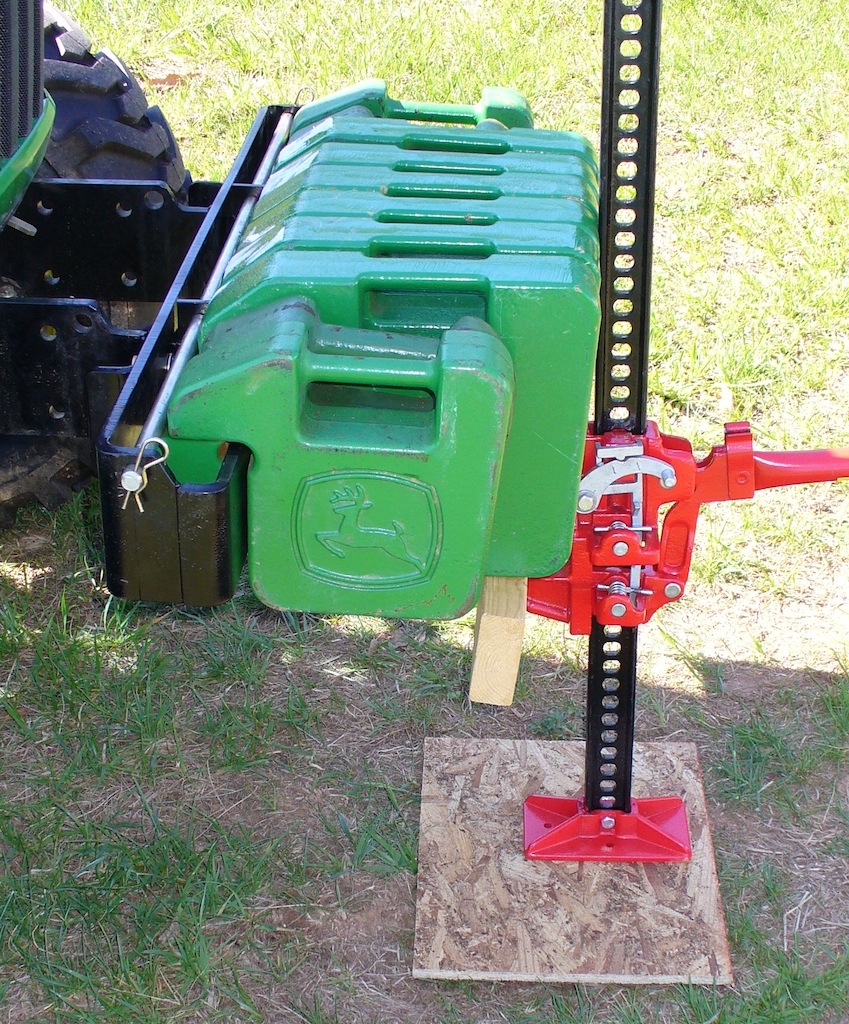

The 1st one is using a jack to gently lift the weights. When I did this, the bar just slide through by hand no problem. The genuine Deere weights were the trick. Thanks to Steve for this little trick.

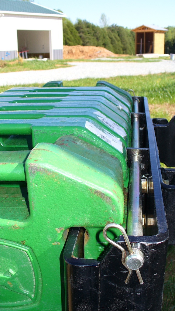

The 3rd pix is a shot straight down the line. You can clearly see the added flat bar with hole that the round weight holder goes through, and the bar is not bent.
