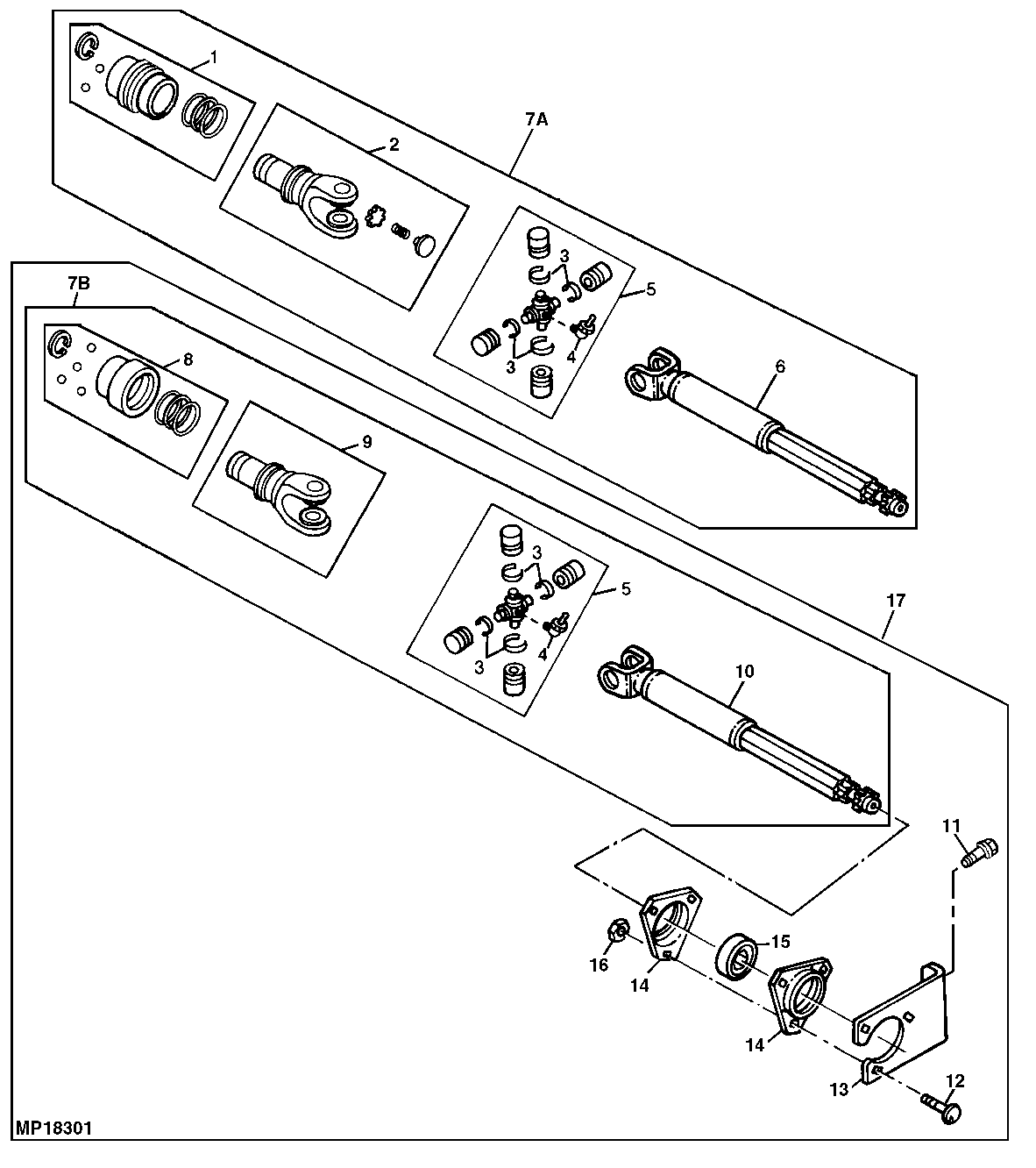

I have a 455 with a 47" blower. My pto shaft goes through my front axle. Does anyone know if there should be a bearing guide or bushing in the axle? My pto shaft seems to rattle against the axle and I don't believe this is normal. I purchased the blower used last year and only used it a couple of times. My local John Deere dealer can't tell me and I can't find info on there web sight.

Yes, the front pto shaft goes through the front axle but has to be supported by a mounting bracket installed on the left front side of the frame(as you are facing the tractor). This bracket accepts the splined end of the pto shaft. The bracket is attached to the frame by two cap screws and flange nuts. There are three flange nuts on the bracket itself that have to be tightened which keeps the bearing assembly from moving out of alignment. This bracket is a bit tricky to install and it must be installed correctly or you will tear up the bearing. I know because it has happened to me when the unit was brand new. The servicing dealer installed incorrectly and the bearing melted within 5 hrs. The JD part # for the Front PTO KIT is BM17330. There is no bushing etc on the front axle where the splined pto shaft goes through. If your pto shaft is rubbing on the axle then something is bent. My pto shaft does not touch the front axle at all. Hope this helps.

I attached a picture from the JD parts site that should show the front bearing in question. Maybe it will help. You can access the parts section on the WEB and get the part numbers you need. As stated, a dealer should be able to do that without a problem.

Thanks for the replys. I don't believe my shaft is bent, I think it's hitting the axle because it's unsupported and flopping around. I think once I install my support system (correctly I hope), This will take care it.
