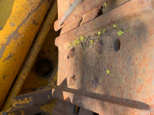

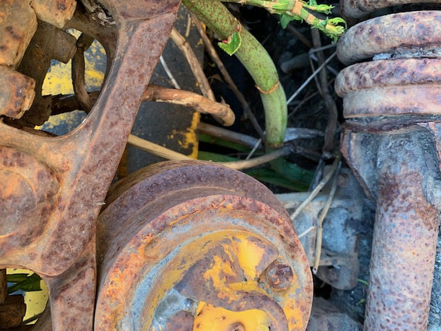

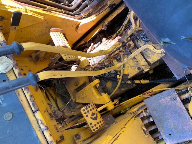

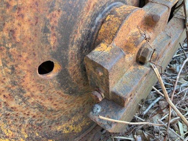

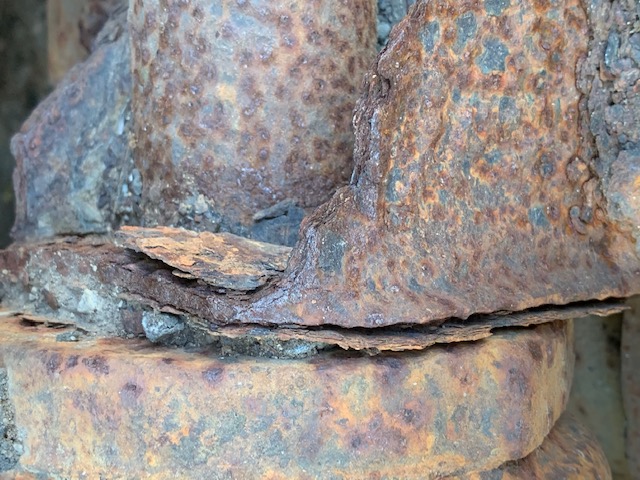

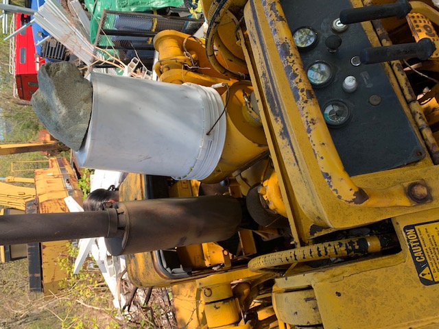

Here is the machine in question. The fellow's son said his dad only changed the engine oil, and was not a fan of greasing or cleaning the undercarriage. It shows.
IMG_1358.jpg IMG_1346.jpg IMG_1357.jpg IMG_1348.jpg IMG_1333.jpg IMG_1332.jpg
Is there any way to save this machine? The thought crossed my mind to look for a parts machine that has an ok UC, swap some parts, and get some time out of it. I appreciate your advice, it helps me to make a decision. Best regards. John

What I would worry about most....The transmission and finals. Parts are expensive and getting harder to find. If what you are seeing on the outside is questionable, what about the internals you can't see?
/ JD 455E crawler loader buying questions #16
You need to do yourself a big favor and walk away from this.

Thank you for the advice. Although I champion lost causes, I will walk away from it. I agree, this one is just too much. I appreciate the help.
