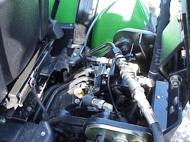

Here is a shot of the hoe attachment to the tractor. You can see how the rockshaft arms hook into the brakets on the hoe to lift it into place.

Good pics, it is really hatd to show this setup, yours do a good job.
I like how your 3/8" return line is angled, mine is straight. I can't flip the hoe seat up when it is connected.

It means you can't mow with the BH on (and thus the subframe, they go together). I think you probably don't want to mow with a BH on anyway. Removing the 46 BH (and thus the subframe) looks to be a 5 minute job, but it should be done on a flat, level surface. I haven't done it yet, I've only read the manual. I expect the first time to take a little longer, but It sure appears to be a strait forward and simple task.
