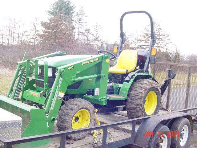

I am considering a BH for my JD4110. I don't really know much about them, but would assume one of these would be what would work on my tractor? Where do they tap in to hydraulics? Does anything have to be removed for the sub frame?
   / JD 46 BH vs Woods BH 6000 for a new 4110 #9
Oh, I forgot --I can't find any good info on Johndeere.com about the 46BH. Does anyone have pictures, or know where to get specs? Thanks
   / JD 46 BH vs Woods BH 6000 for a new 4110 #10
here are some pics that may help you with the 46bh, its attached to my 4115. i dont think you can run a mid mounted mower deck on the 4110 or 4115 with the 46, but i could be wrong. the subframe is quite large. i run heavy john deere backhoes at work 310sg and 410g, they are very nice. i feel right at home on this little one, but it is not quite as smooth as its big brother. i never expected it to be though, so all in all, i am very happy that i bought the 46bh. its a great little unit. the only thing i would change is, when it is all the way up and locked (travel position) the bucket is kind of low. i have several steep banks around, so the bucket gets snagged when travelling sometimes. its really not a huge deal. i have never tried the woods series to compare it.
