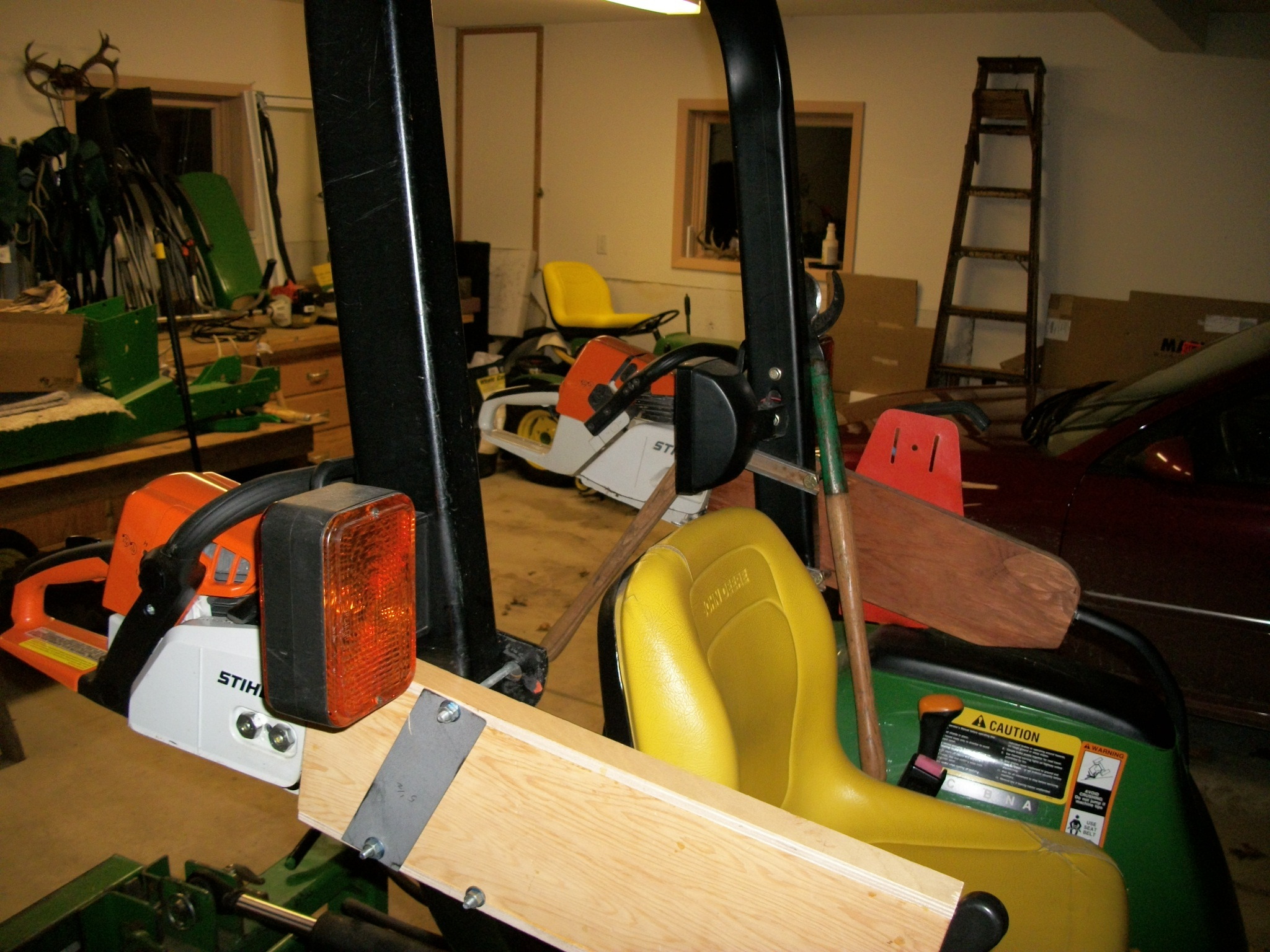

Greetings All!
I did a search on this but did not recover many threads. I'm often out working in the pastures and could use my saw only for a quick cut - - naturally I never seem to have it with me when I need it. That said - if someone has some ideas with pictures to share that would be great. I'm reluctant to drill any holes in my ROPS to attach but could use u clamps if needed. I'm also considering placing a scabbard/bracket on the inside area of the FEL mounting bracket. I 'll be using a small 12" DEWALT 20V saw to carry - - not my main saw but a perfect companion for this effort.
Appreciate any suggestions!

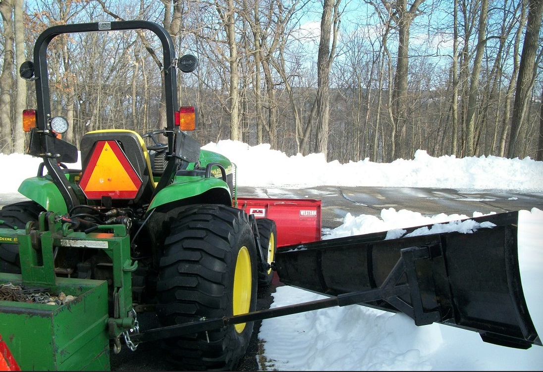

Made two scabbards for my 4300. For what it is worth, find them very handy and make a habit of not leaving the chainsaws on the ground when the tractor is moving.
And when the snow plow is on, the FEL is off. Have an 18" and 20" bar Stihl saw. No drilling in the ROPS, just clamped on the ROPS

Any special clamps you used on the ROPS? Also any mods to the scabbards to accept clamps and not pinch closed?

Two side pieces of 3/8 or 1/2" plywood separated by a strip of 1/2" plywood sandwiched/glued in between. Straps at diagonal on one side and straight on the other side with bolts to clamp.
Think this pic shows both sides. Straps from what found laying around.

Great, that helps a TON. Thanks. I couldn't visualized how you did that.
