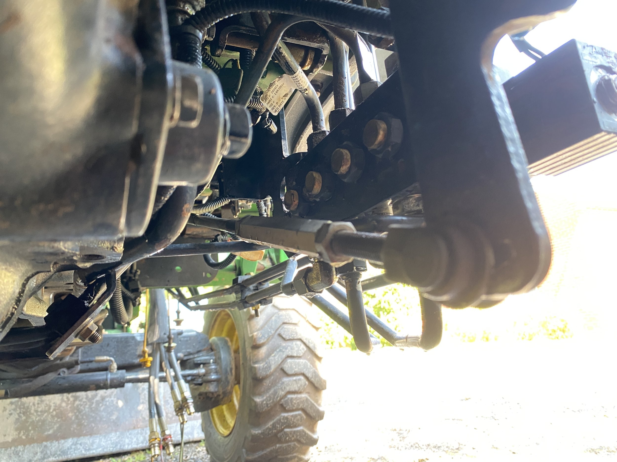

These are two of the stuck spools from the diverter.

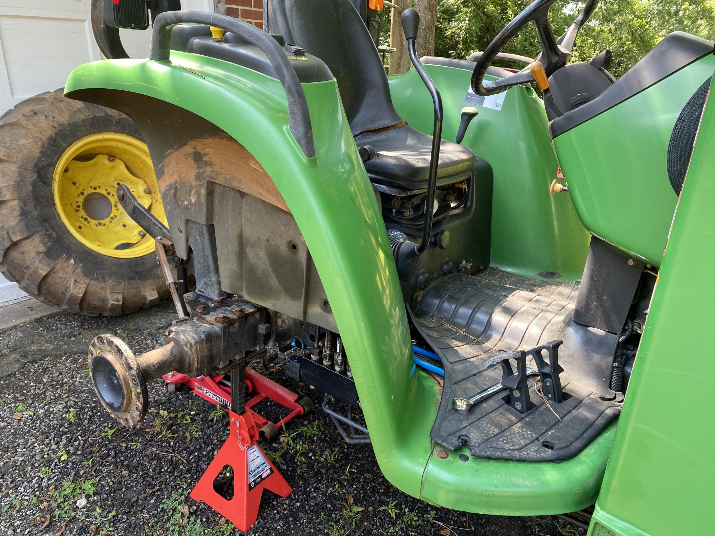

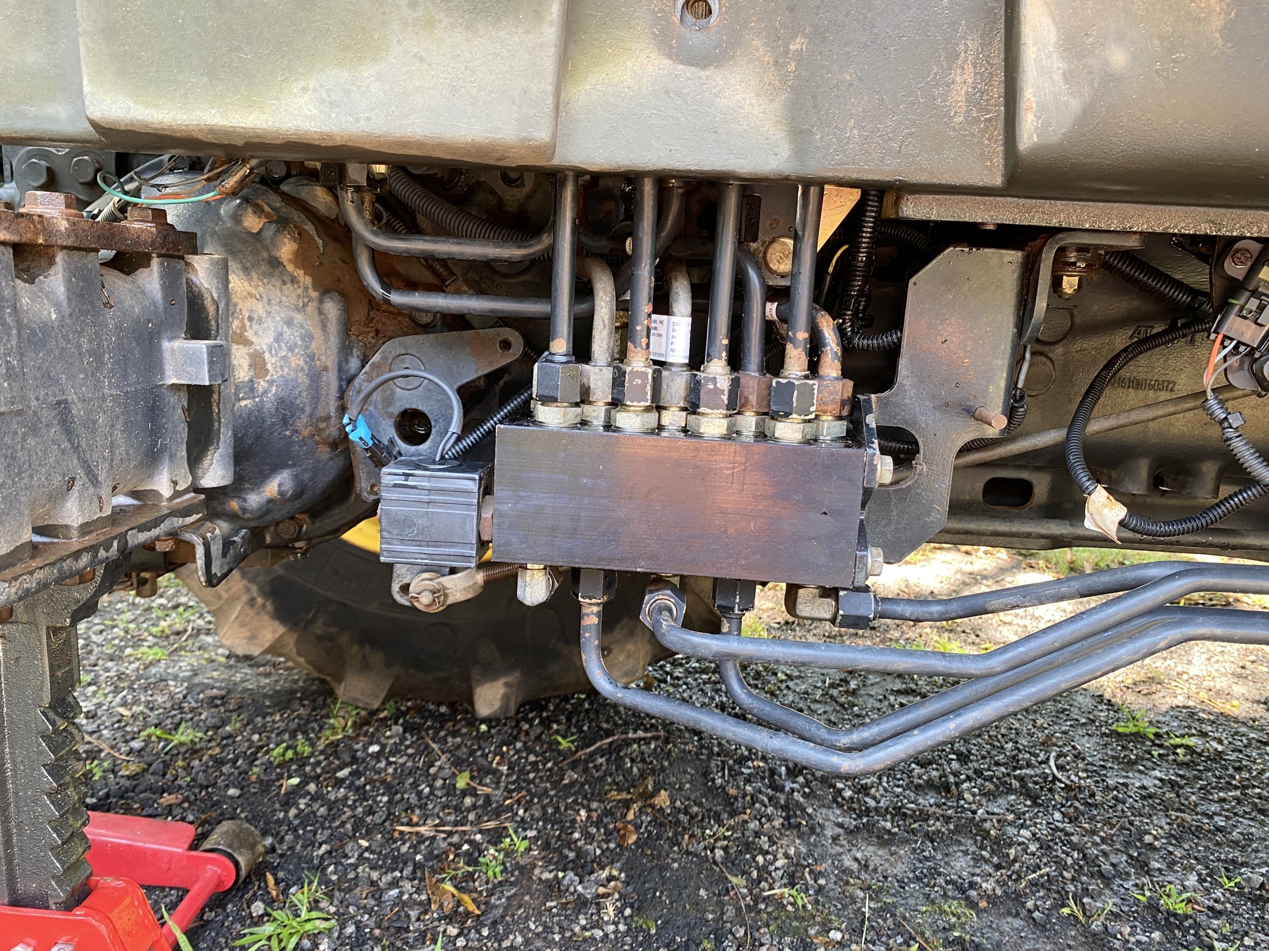

I cut the bolts that help the fender and got it off, exposing the SCV.
Mechanically, everything looks fine, but still no curl.
There are three caps on top of each of the SCV spools, I pulled them off and found a small spring and a little plastic plug underneath.
The plastic plug for the hydraulic link arm and boom valves were free, and easy to pull out.
The plug for the curl is stuck, and I can not get it to wiggle or pull out.
The others were not a tight fit at all, so I am not sure what's holding it in place.
Does anybody know the purpose of these plugs, or if the one being stuck could be the issue?

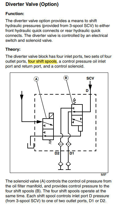

Is the picture with the plastic plug the main lever operated directional valves or the diverter assembly?
If diverter assembly the schematic you posted on Sunday indicated the diverter spools were piloted on one end and spring loaded on the other to default position. The spring chamber also shows being vented to atmosphere. Is it possible those plastic pieces are part of the atmospheric vent? Might connect to drain line into transaxle vs to outside dirty air. No clue how Deere designed this feature.

Just wonted to follow up on the ultimate issues and fix.
The plastic plunger is the load holding check valve, that is supposed to prevent fluid from back flowing under heavy loading. It is the top hat part shown in the this cutaway.
The plastic plunger had gotten deformed due to extreme overloading and got extruded into the passage it was supposed to seal off. This is the main inlet passage to the spool, which explains why I was not getting any pressure to the curl cylinders.
I had to drill out the remainder of the plunger to open up the passage, which restored the curl function. The check valve no longer functions, but that's a relatively minor loss.
Thanks for all the help!
