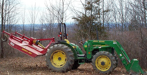

<font color="blue">…a 10 acre ranch. I use a tractor for mowing, grading, working up the riding arena (8 ft disk or drag), unloading pallets of shavings (approx. 1000lbs) and moving and stacking 1000+ lb round bales…</font>
The JD Advantage series, 5x05 units, have the bulk weight, engine torque, PTO horsepower, full size loaders, hydraulic horsepower, and priced right for everything you’ve mentioned… this utility tractor will take the place of a smaller and larger unit… in a size that’s just right for your operation…! /forums/images/graemlins/smile.gif
