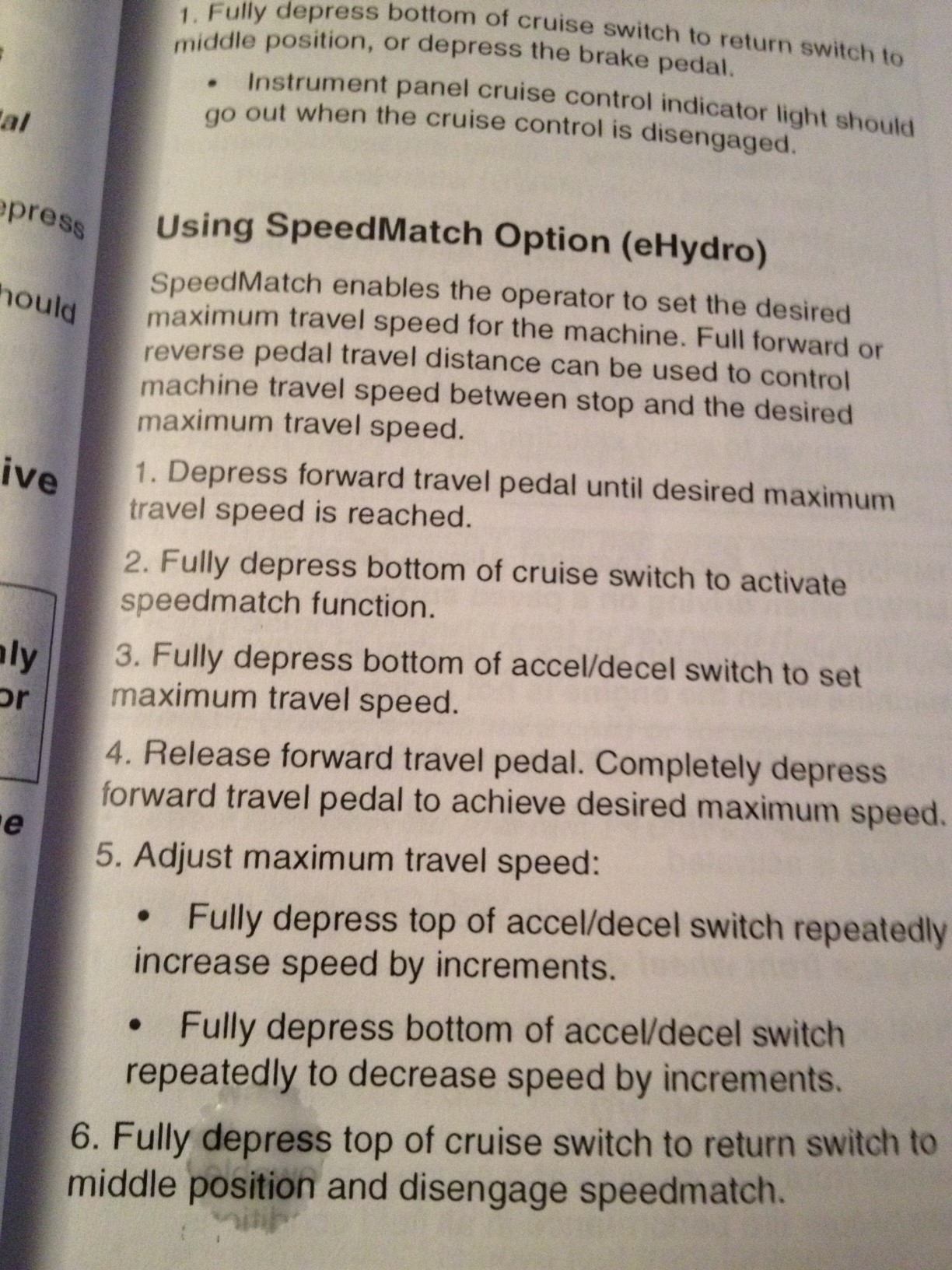

ok. well I didnt get the option with my machine but I suspect you do. im reading my manual and it says it is activated through your cruise control switch which explains why your speed only goes to 7 and your cruise light is on. Turn off the cruise control. the switch should have a picture on it like the indicator on your dash. I would check mine but it is at the dealer for warranty work. I can take a picture of what the manual says about how to activate speed match but give me a minute. Once you turn off your cruise, the indicator should go off on the dash and your machine should be good to go for 18mph
   / JD 4720 doesn't go as fast as it should #22
Click the image to enlarge it. I spilled some of my burboun on it. tells you how to turn off at the end. guess I was wrong about turning the switch off on cruise. looks like there is another simple step to turn off but involves cruise switch
   / JD 4720 doesn't go as fast as it should #23

I tried to get it working this morning. Don't think I have speed match. I was able to lower the mph by .5 at a time by toggling the cruise switch but couldn't get it to go up. Also, the instructions refer to an acceleration and deceleration switch, not sure what that is.

The problem I'm still having is following the instructions for the speedmatch. My guess is I do NOT have it installed since there is not a seperate toggle for this in my cab.
The instructions refer to the "accel/decel switch", what is that?
Using SpeedMatch Option (eHydro)
SpeedMatch enables the operator to set the desired maximum travel speed for the machine. Full forward or reverse pedal travel distance can be used to control machine travel speed between stop and the desired maximum travel speed.
1. Depress forward travel pedal until desired maximum travel speed is reached.
2. Fully depress bottom of cruise switch to activate speedmatch function.
3. Fully depress bottom of accel/decel switch to set maximum travel speed.
4. Release forward travel pedal. Completely depress forward travel pedal to achieve desired maximum speed.
5. Adjust maximum travel speed:
· Fully depress top of accel/decel switch repeatedly to increase speed by increments.
· Fully depress bottom of accel/decel switch repeatedly to decrease speed by increments.
6. Fully depress top of cruise switch to return switch to middle position and disengage speedmatch.
