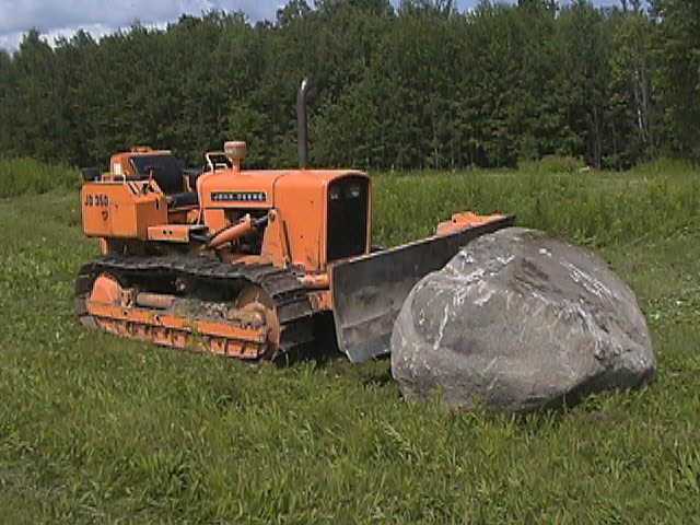

For my hills I have a JD350 dozer. Pix of a little gem I dug out of a 100% slope or 45 degree sidehill. The bottom skidplate is about ankle high off the ground. Tracks are 48" wide and hood stands 48" off the ground. Blade is 6' wide for scale.
