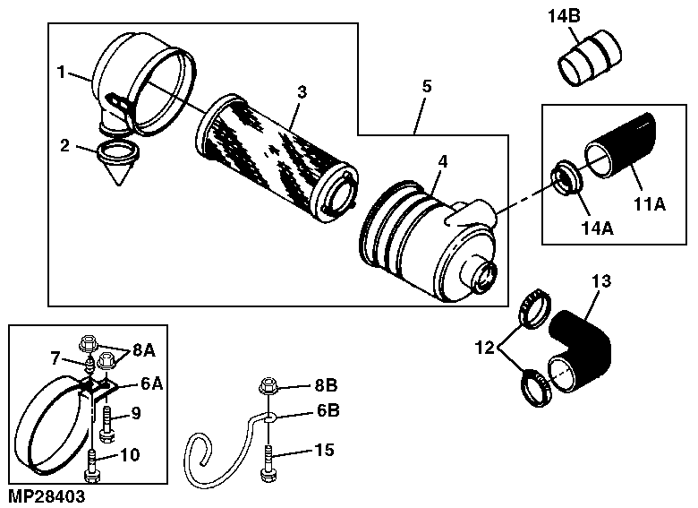

Before I started fixing this issue I did research a lot on this problem and found nada other than some jetting changes. Soooo I tinkered with my ebay carb and did some trouble shooting to no avail. Went ahead and decided to put an oem carb on it to alleviate any issues with mix matched parts. Unfortunately there's unclear info on correct carb numbers for these things and thought it was best to return things to original and continue from there. Ordered and installed the new carb and BINGO it runs a lot better, but still some issues. I wasn't able to tune them out so back to the interwebs for research! Finally after multiple searches and comparisons and head scratching I came to a site, I think it was archived from the dark ages, but it had some great info on the exact problem I was having. A few guys ran the issue down and came up with a few fixes of their own.
Guy A: Had gator a while and then POOF! One day he hit a bump and had the identical issue as me. After taking it to the dealer many times as it was still under warranty and had them scratching their heads a while, they found out it was missing a small restrictor that fits between the air box and the intake tube on the fresh air side. Being fixed he took it home and it worked for awhile and then it happened again. Knowing the issue he bought the two dollar part and glued it in.
Guy B: After tinkering with his and encountering the same issue he tinkered with it and rejetted it and got it to work and increased power.
While both guys said it made theirs run better, guy B said after rejetting and not reinstalling the restrictor his had more power. Both wondered the reason for the restrictor. In my experience the restrictor could match the airbox to the size of engine because it's used on many different models or efficiency/epa requirements although I don't believe this truck had to meet clean air issues back then. I vote for the first one. It's far easier to install a 2 cent piece of plastic than redesign an air filter box or worry about correct jetting etc.
Being a tinkerer and being as these items (restrictor and jet) are cheap and I want more power I'll try both A and B and see how it works!
Let you guys know when the parts come in.
FYI here's the breakdown. It's Item 14A that's MIA. Not sure what 14B is all about.

I am guessing that I have worked on thousands of engines < 20 HP, and the only time I have seen a restrictor like that, it was intended to balance airflow into the housing. In other words, there was heated air coming off of the motor cowling that fed the carburetor, and also a second air source or something like that. On any engine that I have seen, you could take the air filter cover off and the engine would run exactly the same. The reason for the dual input feeds that I have seen is to help the engine run without a choke in colder winter conditions, that might otherwise cause freezing moisture in the throat of the carburetor.
So I am suggesting that before you chase that one too much, just take the cover off the air cleaner and see if that changes how it runs. I bet it won't, and that will tell you that the restrictor is there to take a standard air cleaner housing, and balance the air flow into it from two sources.
With that said, carburetors take a certain amount of vacuum to operate properly, and if there is an air leak, even a small one, near the base of the carburetor it will behave similarly to what you are saying. Another thing that will cause this is a intake valve that is sticking, has a poor seal, or a weak spring.

No air leaks around carb. New gaskets and made sure everything matched up. Had an old ford ranger where I swapped the electric junk carb for a nice 2barrel from an older ford and had gasket matching issues where the carb was sucking air from the base, so it's something I check now all the time. The gator only draws air from the one intake tube on the side where the restrictor is. So it's definitely to pull more vacuum. Hence leaning the carb if it's missing. JD just did a cheap fix to solve a cost effective way to manufacture. If you give it half choke the motor smooths out and picks up a little.
I know what you're talking about by diverters and hot air risers. I've only seen those on older machines and trucks. It's not the case in this one. Hopefully getting the issue fixed will resolve the cold running issues as well. I'm not going to run it till it's done right.

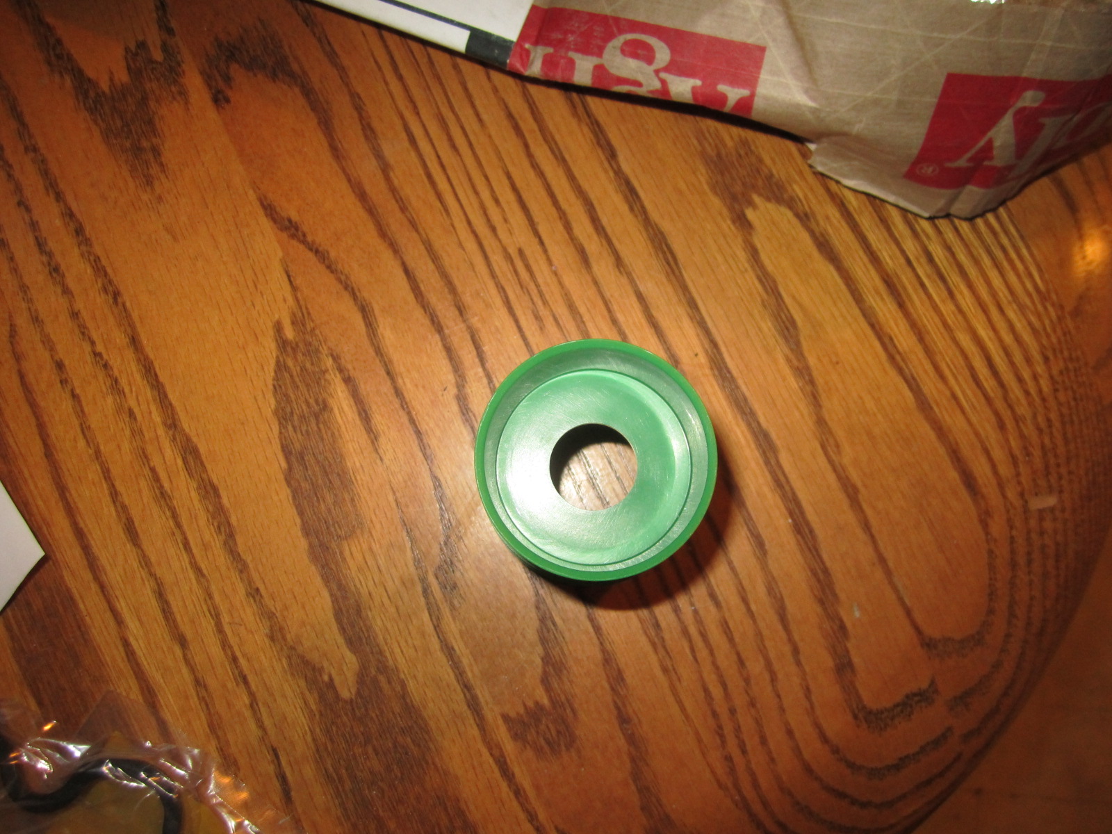

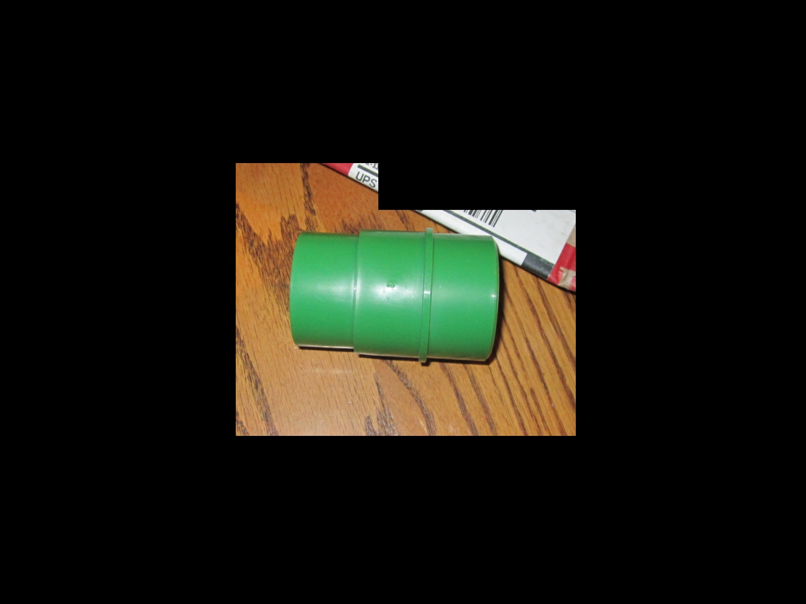

Well, it be fixed. Runs well with the restrictor in place. It has an intermittent tap somewhere in the motor, but who knows how many hours is on it. It came from an industrial application and I'm pretty sure it was used rough. I'll let it go till it dies and I'll put a much larger motor in it, 9hp isn't enough on these hills. Here's some pics of the restrictor and gator. The restrictor fits in the intake tube of the air cleaner, not the carb side of it.
