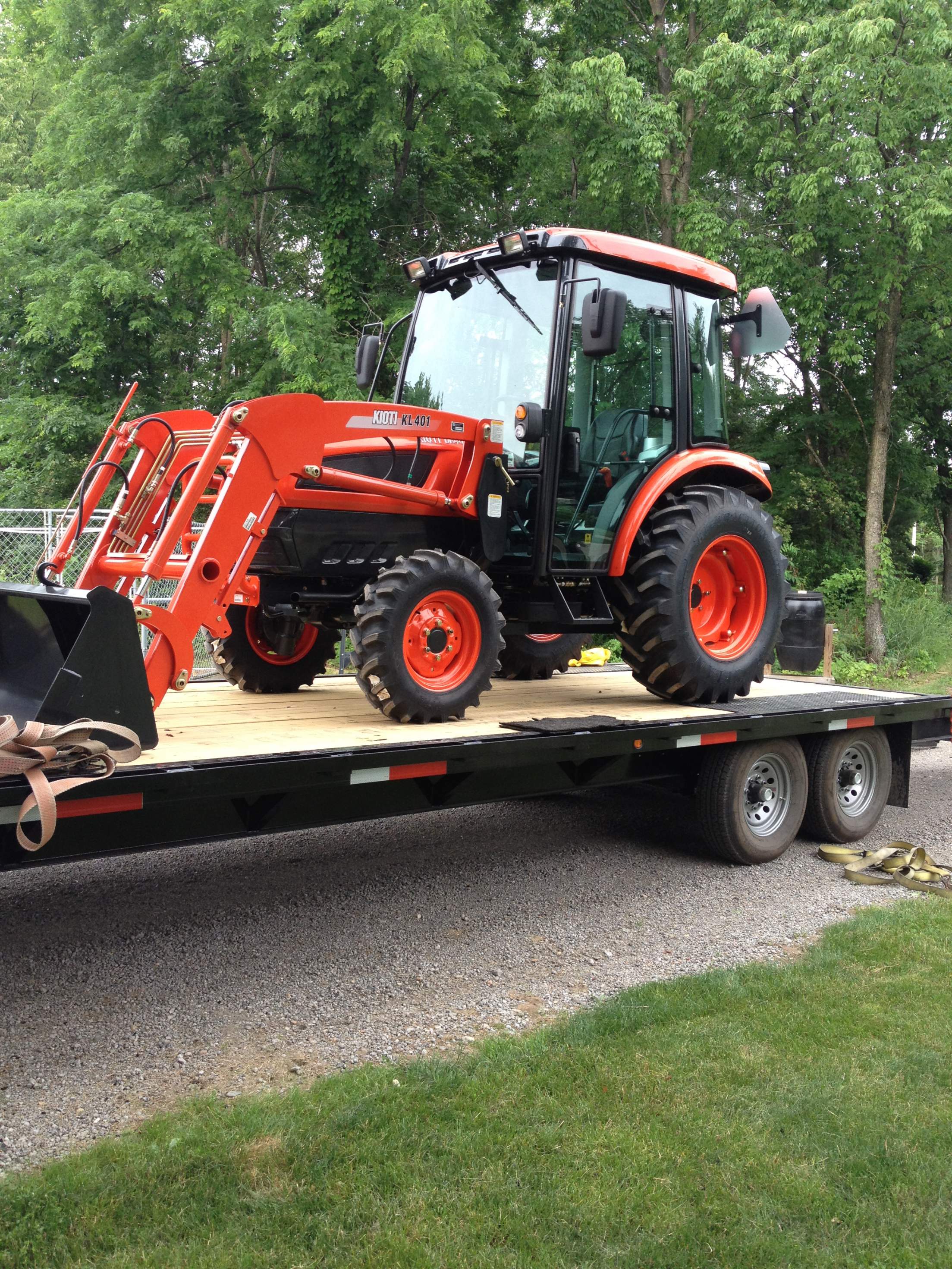

I would also look at the Kioti tractors.The models RX6010(60hp)and DK50se(HST)50 hp.They have a free loader program until august 31st.2013.I just bought my second Kioti tractor,heres a pic on my DK40 HST.coobie
