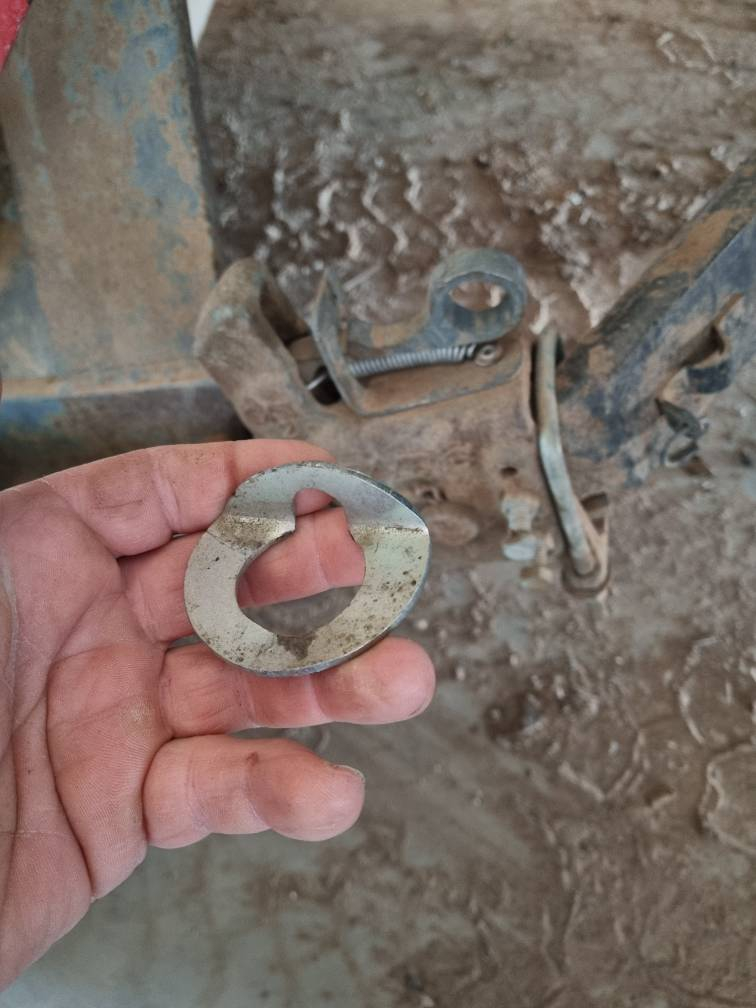

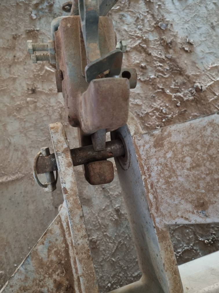

I should clarify, I’ve never had the Pat’s lift arms fail causing the attachment to fall off.
It was the snap style lynch pin that got popped off by those special washers (with the 90 bend). They could of just as likely popped off the pin on any hitch when not using the Pat’s.
I only use flat washers next to the lynch pin (on any type of hitch) now.
