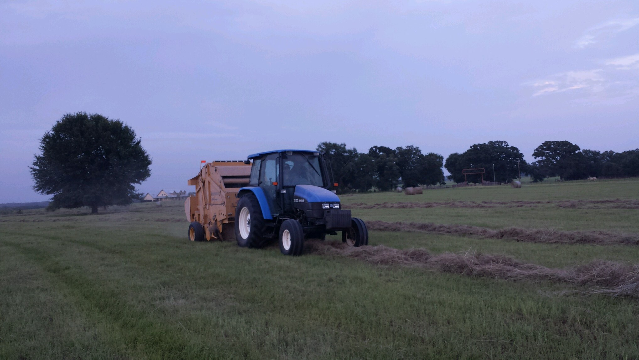

They have a 4.105 looked at in Crockett was nice image.jpg didn't get price but out of the three mentioned I would have to go with that 95c just like the interior over all the rest. That 6115D is in the mid 60's? I looked at the 6105D back when I was tractor shopping but for what I could have got for the price in the Kubota GX series,I would have went with the Kubota. I just ended up finally buying a low hr New Holland TL100 for 50,000 less.

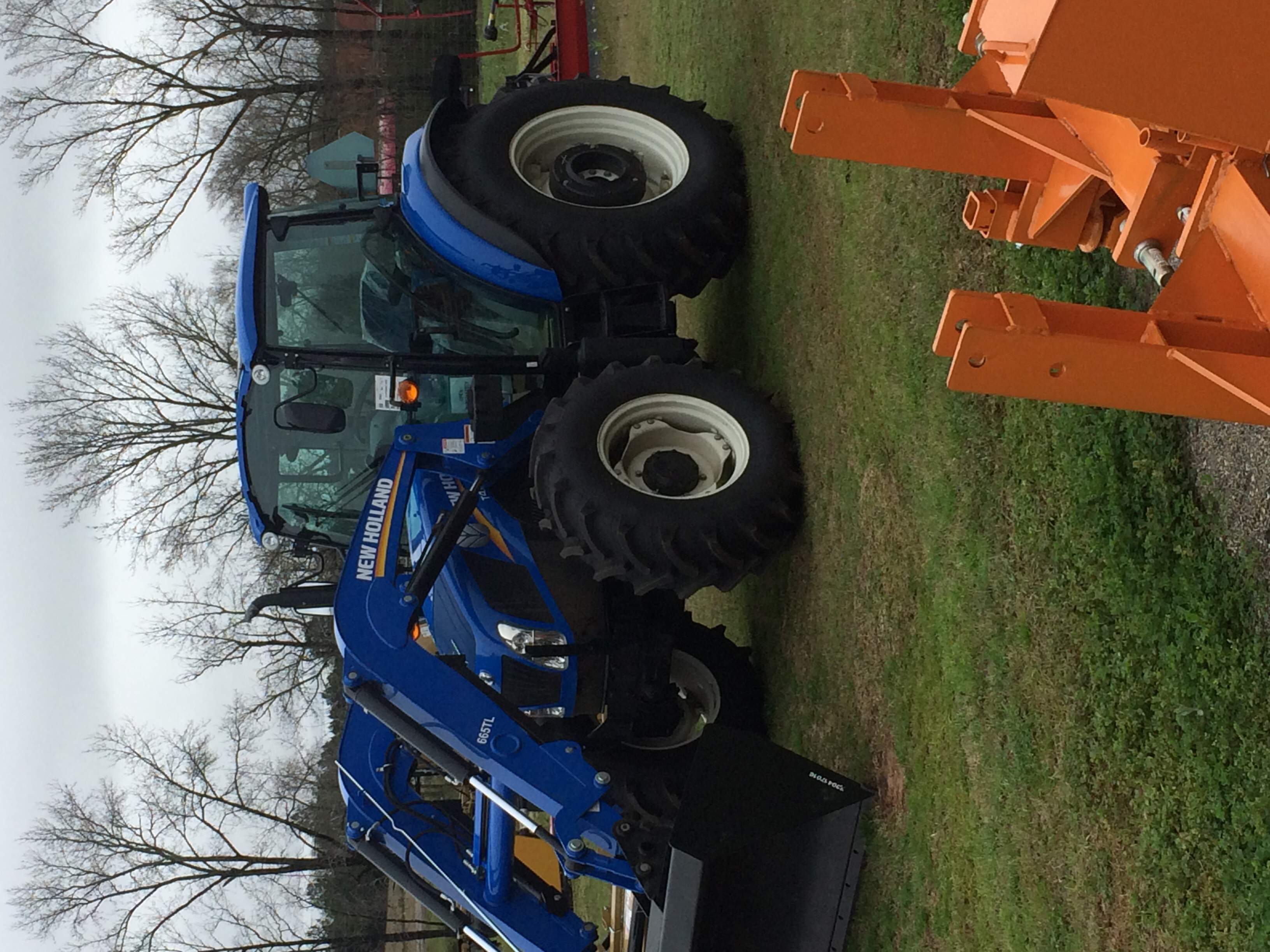

How do you like your TL? I found a 4x4 TL100 with loader for under $30k but didn't know much about them.

I like it,it does good for me pulling 15ft batwing and RND baler. It's comfortable,rides smooth across the pasture. image.jpg. It's heavy would say around 12,000lbs. Should you be looking for like a TS135a,something in that category?
