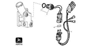

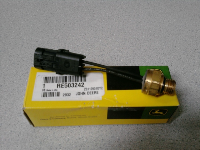

Are you blowing any fuses? And does the fuse blow as soon as you turn the key? It might be the key switch fuse.
If yes, to both questions, I believe the problem is the thermistor sensor (thermistors are temperature variable resistors used as sensors.). On the thermostat housing there is a sensor that is connected to a two wire harness that goes to the injection pump; this is the "cold start advance" portion of the system so it starts easier when cold by advancing the timing.
When the sensor on the thermostat housing fails it shorts out and blows the fuse. Try unplugging it, replace fuse and see if it starts and runs. The part # is RE503242, if you are quick changing it, you don't have to drain the coolant, just make sure it's not hot at the time. You will want a pan under the tractor to catch the coolant, so as not too have to clean it up.
To comply with the exhaust emissions regulation, the timing of injection pump should be around 6 to 9 degrees before TDC. These timing values do not allow proper start-up operations when engine is cold. To ease engine start-up, a cold advance system gives to the injection pump a temporary over-timing.
When coolant temperature is below 50 C (122 F), the solenoid valve is activated and opens the cold advance circuit.

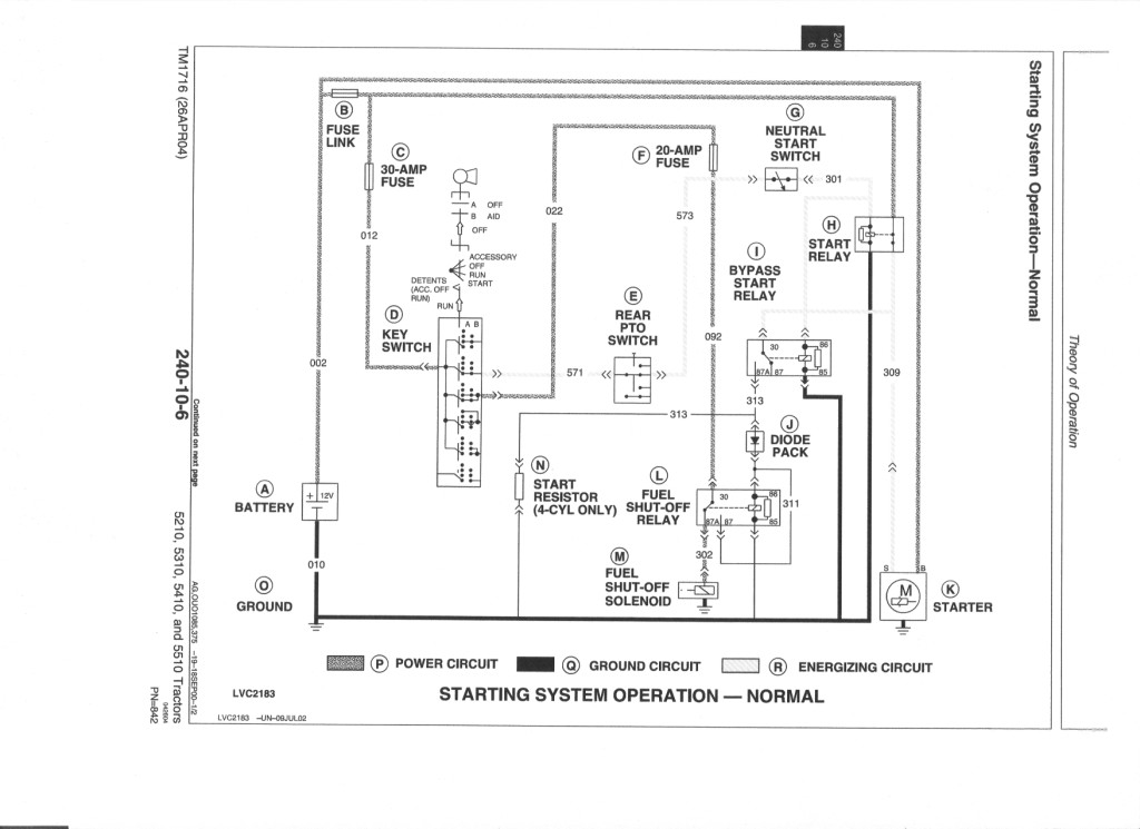

No voltage at fuel solenoid. All fuses are good and don't blow. I can run a wire directly from the battery to the solenoid and the engine will run. Must be a broken wire somewhere.

My suggestion at this point is to get the tech manual JD shows it to be (TM900019). Not cheap, but there is one on ebay. As luck would have it the page on ebay shows the location of the relays I would check the by-pass relay, start relay, fuel shut off relay and diode. If you go to JDparts.com and then go to the parts catalog all the relays on the left have the same part number, so you could swap the by-pass and fuel shut off for one of the turn signal relays and see what happens. You could also swap the diodes as it appears the part numbers are the same. I have attached the page from JDparts. Disconnect the negative battery cable, before pulling anything, just to be safe.
If you get the manual and if you would like help looking at the start system, I would be more than willing to help. Maybe another member can post a page of the starting system and the page that is on ebay.
I have attached the start system for the 5X10, you are going to have to determine how close, they are.
On the plus side the fuel solenoid is good. For now I would disconnect the sensor that is connected to the fuel solenoid to take it out of the equation as they say.
