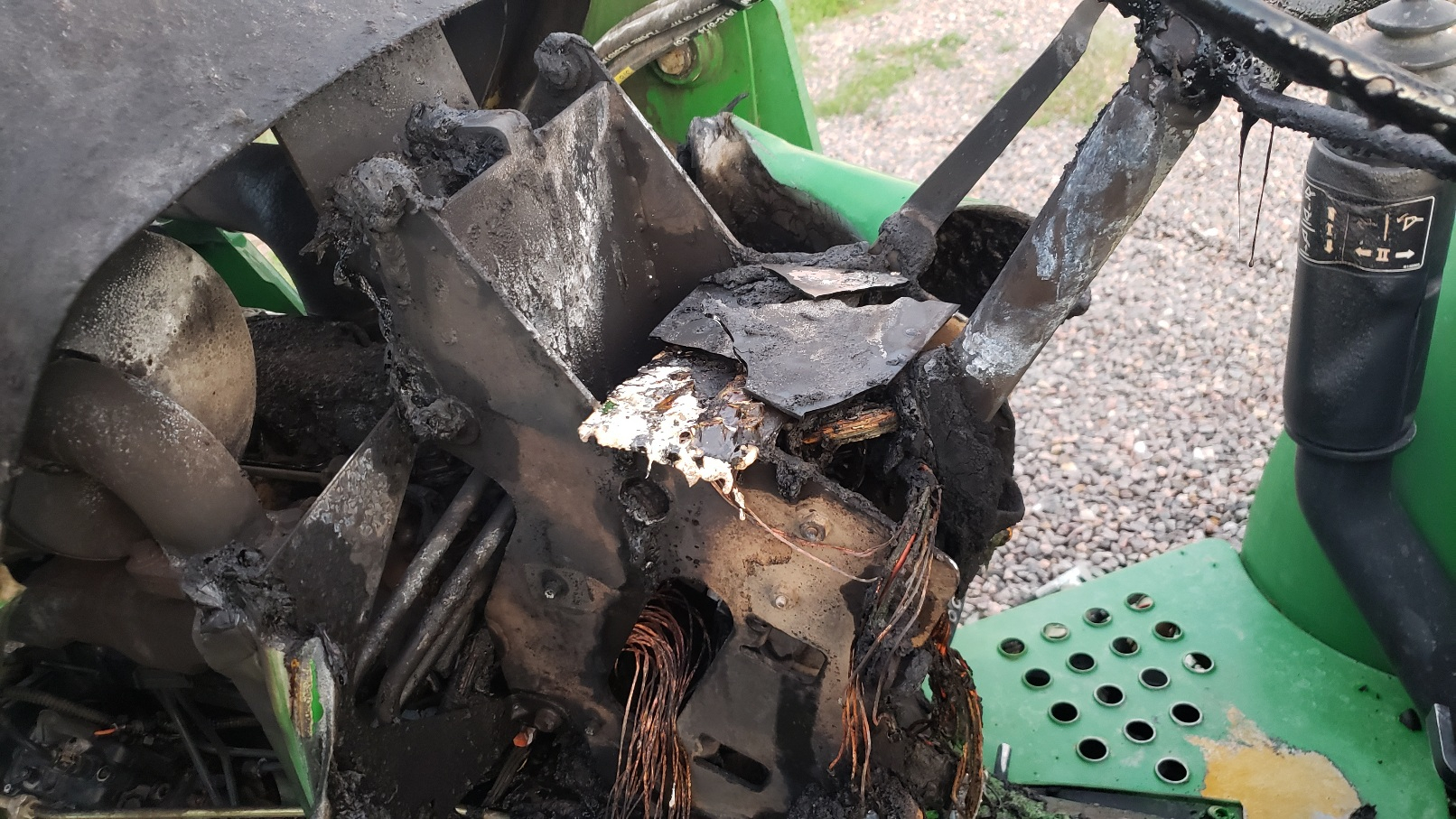

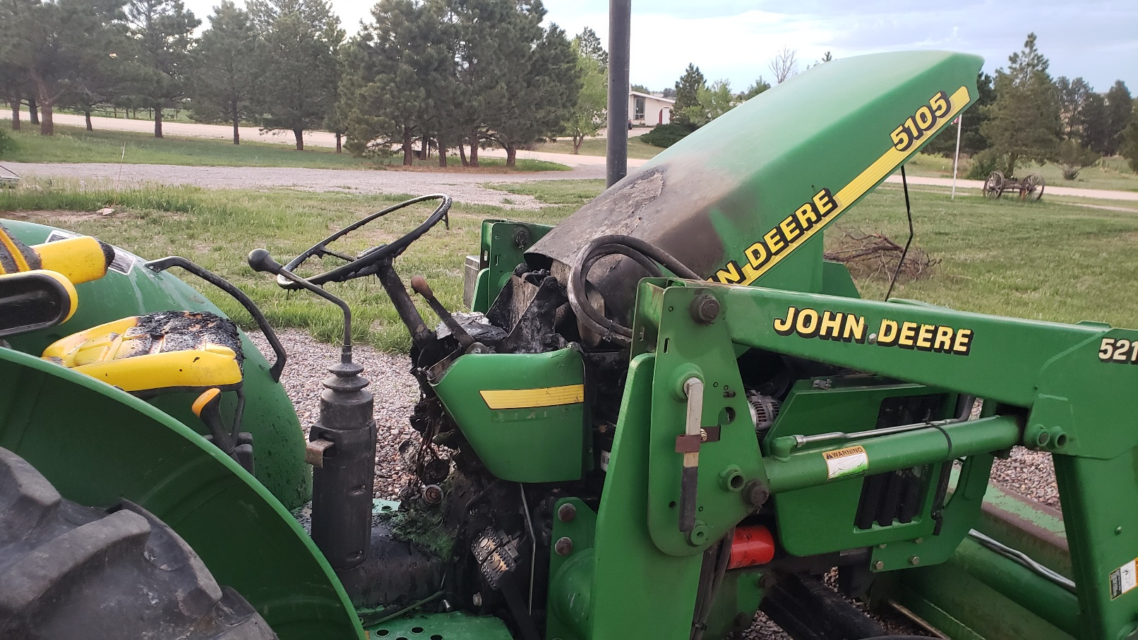

This happened Friday after brush hogging the larger areas that I keep mowed. I mowed about an hour, ate a quick dinner, and finished another 45 minutes. I parked it here and went to spray thistle on the 4 wheeler and my wife and kids yell "fire" at me. Must have been electrical, but the only work done in the past couple of years has been maintenance and a couple of cosmetic things.
Things I did right and lessons for others:
1. I parked it outside after mowing. I usually do this to let the mower cool off before detaching it.
2. I parked it on the rocks. I do this for the same reason. It wouldn't have been an issue today.
3. I had two large fire extinguishers in the shop (behind me in the picture). I used the entirety of one and had the second ready in case it flared back up. One of my neighbors ran over with his, but we didn't need them. I will now have three, and larger ones.
I had it extinguished when the FD arrived. They sprayed it with one of their water/foam extinguishers and checked the temperature of everything.
4. I was able to disconnect the battery without tools. The fire was out, but it shorted something to cause the starter to engage. It didn't start since it needs power to open the fuel solenoid. The fuel lines had burned through already.
5. After the FD got done, I hosed off all of the stuff from the extinguishers.
6. I had bolts and clamps to plug the fuel lines. Don't want $100 worth of diesel to drain out.
7. It's insured. I was very specific about it when I changed carriers last year.
I don't think it's a total loss. Even if they say it is, I think it's worth fixing.
I'm still pissed, but it could have been a lot worse.

I'm glad you were able to extinguish that fire before the tractor was a total loss. It looks like the fire was concentrated in the dash/instrument panel area. On my 5205 mice like to build nests under the dash area at the rear of the motor. Do you think you had a mouse nest there and it got hot enough to ignite?

Purely speculation based on the photo but I'd say the point of origin was the battery since it was so totally destroyed.

What is a total can surprise me, but don't be shocked if it is. Remember the front end loader is not part of the tractor. So they will pull it off in calculation. Where is the fuel tank, is in under the seat area or behind the seat area? Sure good not under the hood as they use to be.
The battery on that tractor is located at the very front, ahead of the radiator. It doesn't look to be the origin of the problem.
I don't think there were any mouse nests. I store mine inside of my shop and I've never had any evidence of mice in there. I keep a few traps out just in case.
The battery is in front of the radiator on that one. I think it was the fuse box area or wiring behind it. My guess is that it was a small electrical fire that burned through the diesel hose running from the tank.
The fuel tank is behind the seat with a small portion of it to the left of the seat. It was not damaged.
I went through and found part numbers of the major components that need to be replaced. My running total from a JD dealer site was $5600. I'm sure labor would double that, but I can fix it myself and find some used parts for some things.

Seen something almost like that cause by rodents.
/ JD 5105 Fire #17
That could be an interesting design suggestion - don't put the fuse block close to the fuel lines.

I've seen where over time wires get chaffed. Just wear and tear and bad design/placement.
Get some always hot +12v ground out to the frame, and bingo, fire.
