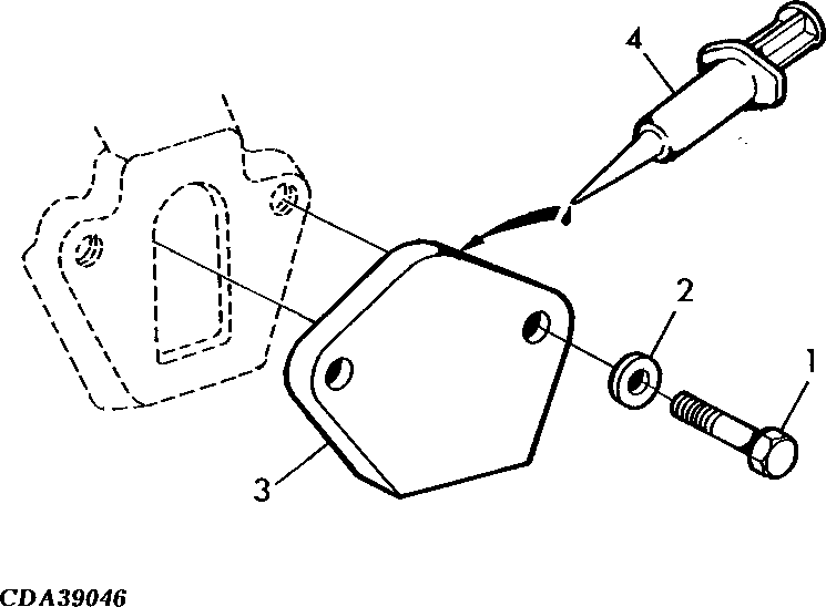

There's something helping inj pump get fuel called gravity. That's why there's no lift pump but one could be installed if necessary.
