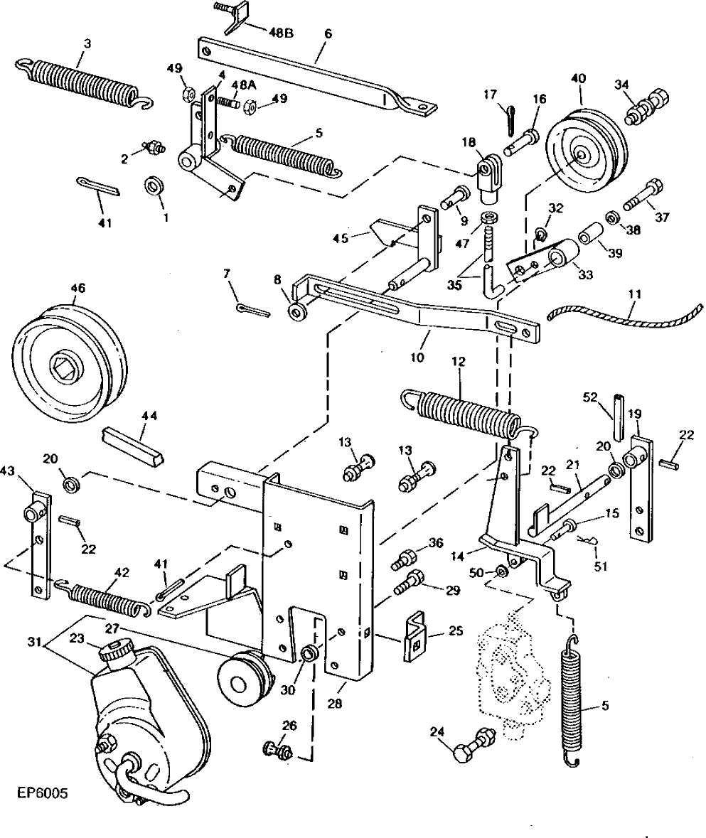

Jul 14, 2014 / JD 530 baler problems #1 G guittonfarms New member Joined Jul 14, 2014 Messages 2 Location Claresholm AB Tractor 1175 case Baler was working fine. Tried to adjust to make a smaller bale. Now it wants to make mini-sausage bales. What needs to be adjusted? Thanks
Jul 14, 2014 / JD 530 baler problems #2 Tx Jim New Member Joined Jan 26, 2007 Messages 10,398 Location Coyote Flats,Tx Tractor JD 4255/Kubota M7040 HDC Sounds as if twine pump linkage is not re-latching hook(parts key 45) when tailgate closes. Are all five springs intact? Attachments EP6005_________UN01JAN94.gif 46 KB · Views: 7,760
Jul 14, 2014 / JD 530 baler problems Thread Starter #3 OP G guittonfarms New member Joined Jul 14, 2014 Messages 2 Location Claresholm AB Tractor 1175 case Thanks! Will give that a try. It seems that my baler only has three springs but definitely worth checking out
