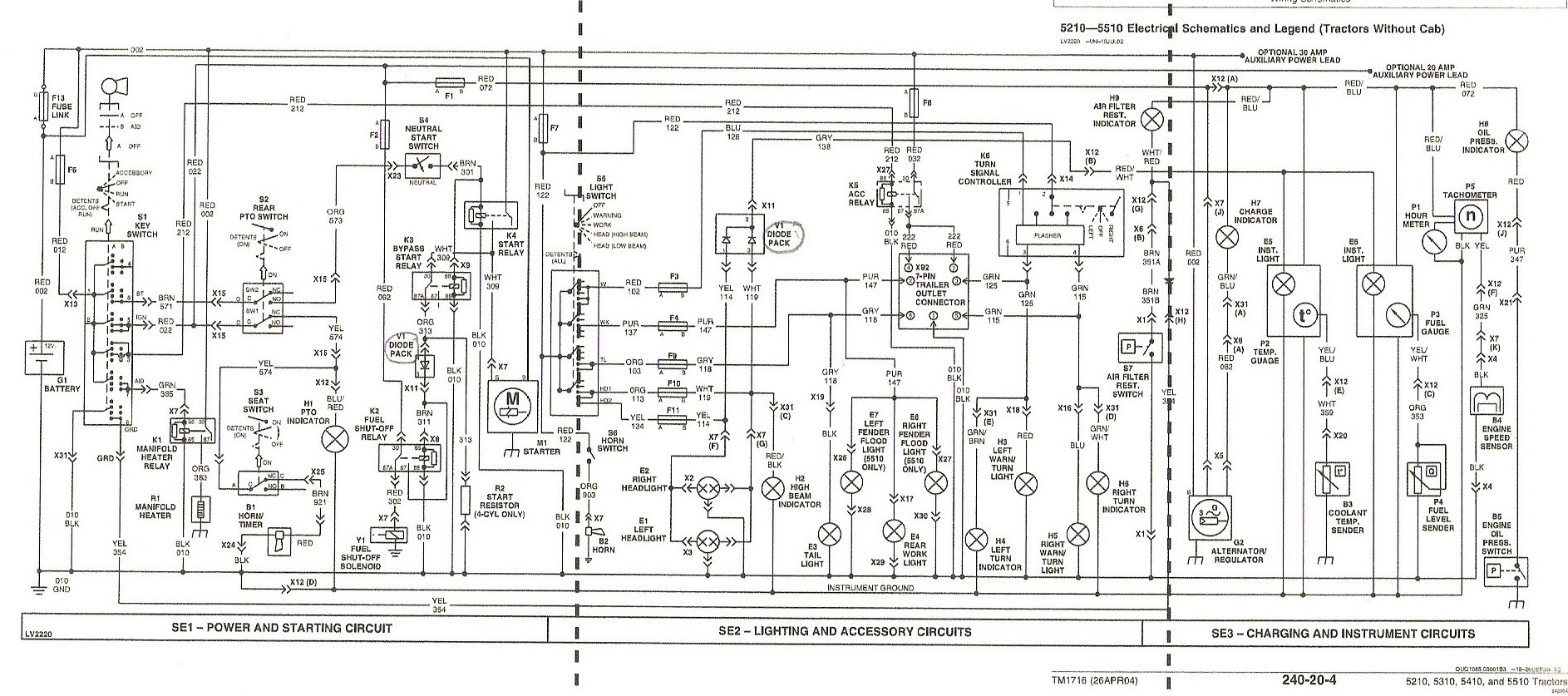

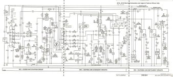

You might consider trying this suggestion. This is all done with the tractor off. Using a 12 volt test light (see video if you have not used one before) disconnect the negative cable on the battery and connect the test light to the negative battery pole and the tractor frame. If something is drawing power the light will be on. Then start one by one removing fuses, until the light goes out. If the light never goes out the problem is before you get to the fuse box.
If the light does go off, then put in all but the last fuse removed. Put the last fuse removed back in of what you think is the circuit drawing voltage, just to double check you results. I have attached a wiring diagram of 5X10 you need to determine if this close to your 5300.
If the circuit which you feel has the problem has a relay on you can pull out the relay and see if the light goes out.
https://www.youtube.com/watch?v=kPSBaYw2uEo
Here is a video of what I am suggesting. He does it on the positive side of the battery, not sure it matters which side of the battery to use.
how to find a electrical short on most any car or truck
https://www.youtube.com/watch?v=9wLrTjeb9TY

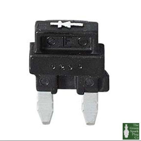

Some machines have a Blocking Diode on the charging circuit in the fuse box , Positrac have them to name one . It looks a bit like a fuse and it can only go in one way . If you are unaware , it is easy to pull it out thinking it is a fuse , look at it and then put it back in the wrong way around . If it is in backwards the battery WILL NOT charge and as it is in there to stop a reverse flow of current , the battery will run down via the alternator winding's .
It may look like this .
