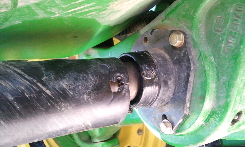

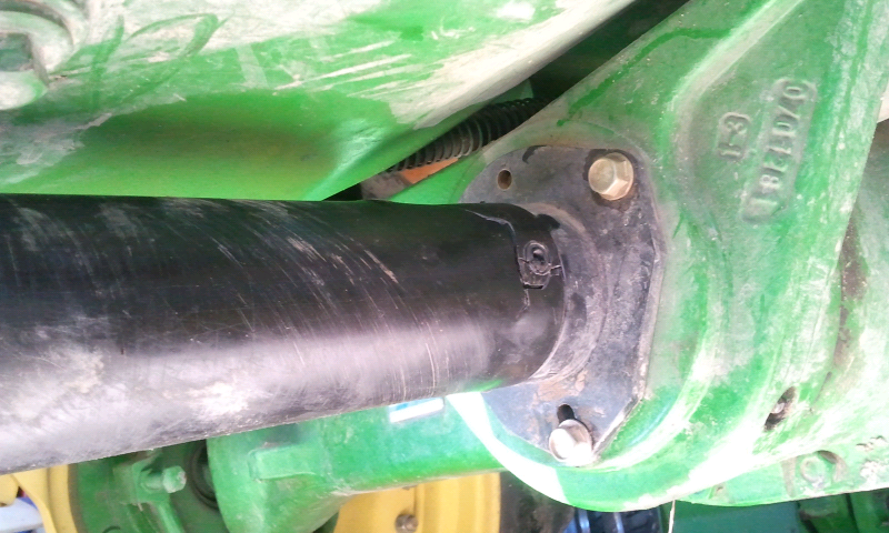

A couple weeks ago I got in a bind working near the edge of a small creek. Front tires got over a buried log and I couldn't back out or push with loader and back out. Front was bottomed out. Wound up with second tractor and PTO winch to pull it out. Got it home and cleaned up and didn't see any damage. I had just installed my horizontal exhaust the day before and amazingly it was not damaged either.

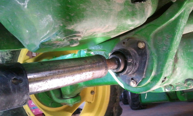

I noticed a noise this afternoon while running at road speed going to swap implements. Sounded like a stick flopping. Upon further inspection attached is what I found. I am certain this occurred with the creek incident and the guard was what I was hearing. It looks like the attachment points were stripped out. I managed to work it back into place, but after 30 to 45 minutes of grading drive I noticed it had come off.
Questions:
1) Is it possible to replace this piece (s) without removing the drive shaft?
2) Any likelihood anything else damaged? Doesn't seem to be.
3) Looks like I might have room to run a short screw through to hold together, but I don't want to start "patching" either.
The pictures show how it was found, it slid back on and it slipping back off.
Any suggestions?

It looks as though you might be able to turn the cover a quarter of a turn and drill a new hole to reattach it to the end.
You won't be able to replace without removing one end of the drive shaft.
As for other damage the front shaft could be bent if you hit that log pretty good. But I doubt it.

I suggest working the guard back onto the collar. Then place a hose clamp over the guard, clamping it to the collar.
Be very careful of placing any fastener, that you don't contact the rotating shaft. Not for fear of damage, the noise will drive you crazy.

Yes it is plastic. I do not think it bent anything and don't feel any sort of vibration. Looks like it was held together with a plastic rivet or something. My guess is while I was backing up it contacted the log while turning. Hate to "rig" it but don't see the need to carry it to the extreme. The only reason/benefit of using screw is it could be easily removed. Hose clamp plus short self tapping sheet metal screw may be enough to hold it. Was a little surprised it backed off today just grading the driveway.
That would be my first choice.

Definitely planning to correct/repair the guard. Just want to make sure I make a good decision on how it is repaired. I plan to have this tractor a long time and don't want to rig it. I want it to remain as close to like new as possible.
