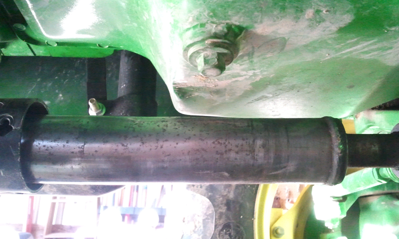

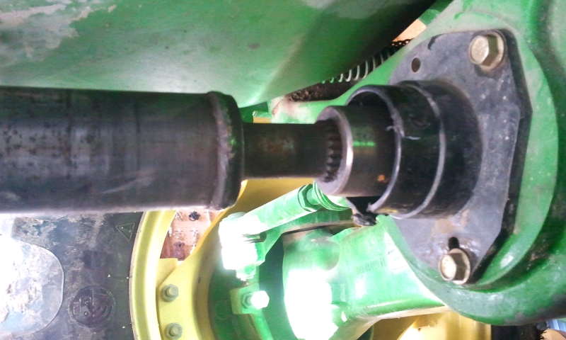

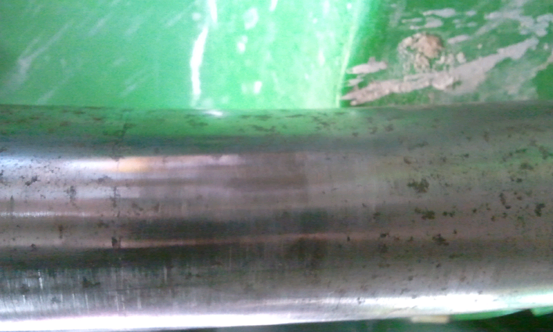

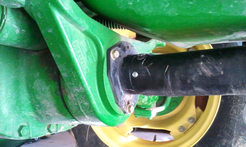

Got time this morning to make repair. After looking and feeling closer, it seems there is a slight deformation of the drive shaft. Not sure pictures will show it, but feels like it is slightly out of round in one place. Also attached are pics of #8 1/2" self tapping screw used to resecure guard.
   / JD 5303 Front Drive Shaft Guard
#12
I had to reposition the guard after initially reattaching it and hearing a popping noise. Was able to spin it around a little and reattach. Noise gone. I was able to look underneath while driving across open field and noticed the guard seems to be "flopping". Since the guards appear to be fixed on the collars on each end, that only leaves me with believing the shaft is indeed bent. The only other thought would be the guard is slightly deformed and contacts the spinning shaft in certain locations.
What kind of damage long term would result from operating as is? I looked up the shaft on JDParts and looks like I could get a new shaft and guard for around $500. Just curious is it necessary.

Before spending that kind of money, take the guard off and put a stright edge on the shaft. That will tell you if bent. Other option is to take guard off and have someone esle drive the tractor slowly while you watch the shaft. If bent, a drive shaft specialist maybe able to straighten out for you.

The shaft shouldn't be that hard to remove. Looks like a couple of split roll-pins on each end of the shaft. Drive out with a punch and slide the spline collar onto the shaft and remove. Here's a part's diagram. John Deere - Parts Catalog
Eventually, over some time; the shaft irregularity will cause uneven wear and stress on the pinion shafts (front diff and transmission) this will be evident with leaking seals and eventually bearing failure and/or pinion teeth wear. None of these situations is a positive outcome...

Looking at the JDParts page it seems a fairly simple fix. Feel like the best way to know for sure is going to be to drop the shaft. Should be able to find a flat surface and roll it across to see if it is flat or maybe check it with four foot level as straight edge as suggested for straightness.
